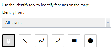

AdamGebhart
@RobertScheitlin__GISP
Hi Robert.  Is there any chance you can help me?  I'm configuring Identify 2.17 in Developer 2.19...
I have 'Only These' checked...
It saves to the config...
But the widget still looks like this...
Side note - I notice that the widget disappears in the configuration window when I toggle the 'Only These' settings and save.  It reappears when I launch the app though.
AdamGebhart_4-1620664357660.png>
If it means anything I initially built this 2.19 app with Identify 2.11 and noticed the error there.  I then replaced the Identify widget folder and config with 2.17 and I'm experiencing the same thing.
MVP Emeritus
@AdamGebhart ,
The option "Only These" will not change the UI's display of "All Layers" in the drop down (if that is what you are expecting). It will change the behavior of the "All Layers" to be only all configured layers. I have not see the icon thing you mentioned, but I have not tested 2.19 yet either.

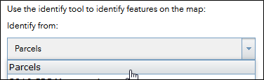

AdamGebhart
Thanks for the information.  Ironically, this is what I see in another 2.19 app with Identify 2.11.
Only These is checked.
It is reflected in the config file.
"All layers" does NOT appear in the dropdown.
Is this example the exception and not the rule?  I'm not sure if I did anything differently in either config.  The biggest difference I can think of is the app I mentioned the other day I originally built in 2.18 and imported to 2.19 via command prompt.  The app in this example came from 2.13 (and imported via command prompt).  Both were Identify 2.11.
MVP Emeritus
@AdamGebhart ,
   So in the other app you must have changed the "Disable All Layers Choice" in the widgets general setting then most likely.
AdamGebhart
Geez, that was it.  I kept looking right past that in the configuration of the one app.  Thanks for the help.

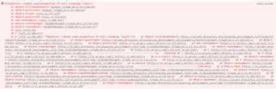

Hi Robert,
I've run across an issue when using the Identify widget in the Launchpad Theme of WAB. If you add the widget to the Anchor Bar Controller, there is an issue when you close the widget. The console log shows TypeError: Cannot read property 'remove' of undefined. It only occurs if you actually close the widget, and not just minimize it (i.e. when the identify icon remains on the screen). The App acts as if the widget didn't close (even though it isn't shown on the screen). Then, when the user is panning around the map, if they happen to click where the widget was previously open all of the HTML elements of the app get highlighted in blue and the map doesn't move.
I just downloaded and tested with the lasted 2.17 version of the widget as well and got the same results.
Thanks again for all of your support with these widgets! It is very much appreciated!
MVP Emeritus
@Anonymous User ,
OK I see the issue and the fix is simple just update the onClose function in the widget.js to:

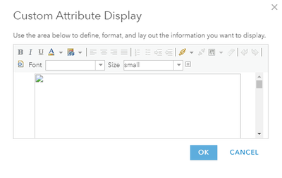

LixinHuang
Hi Robert,
Does Identify Widget support Custom Attribute Display?
MVP Emeritus
@LixinHuang
No it does not.
