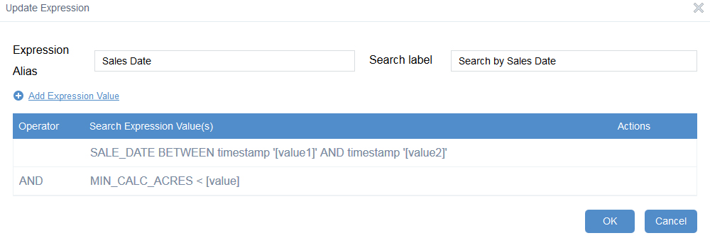

glennhazelton
Deactivated User
Robert,
i may have found a bug
i built a query with a date range and a variable.
like this
date between value1 and value2
and
item 'no greater than' .2
i am getting no results and a box saying search failed !
if i build the query with just the date or just the item it works fine.
RobertScheitlin__GISP
MVP Emeritus
Glenn,
   The following expression worked fine for me and produces results...
glennhazelton
Deactivated User
i am glad it works for you.
i wonder what could be causing it to fail.
is it possible it is timing out? is there a way to extend the time.
MVP Emeritus
Glenn,
   Have you tested just trying to plug the SQL string in to your rest service endpoint to see if you can get it working there?

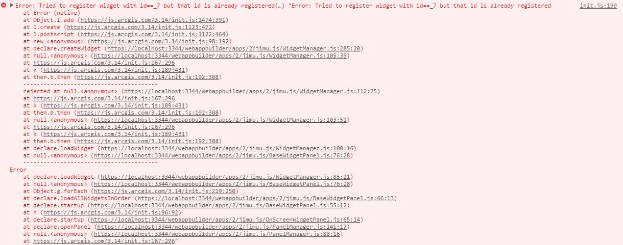

deleted-user-dbQhBq-o3nyM
Deactivated User
Hi Robert Scheitlin, GISP
I am using the following setup and getting the error "create widget error widgets/eSearch/Widget" when trying to open the Enhanced Search Widget:
Enhanced Search Widget v 1.2.0.6
Developer WAB version 1.2 - Locally
Why am I getting this code?
Below is what the console says in Google Chrome:
I am very new to this WAB stuff, but need to get it working. I've been following Tapas Das's instructions for setup because it was the only 'how-to' I could find and it is very helpful.
MVP Emeritus
Jordan,
   I don't see anything in that error log that points to the eSearch. Have you tried removing eSearch from your app to see if it still have the error?

Per your recommendation I just did. It doesn't give me the error when using any of the other widgets. As Kevin mentioned in the next post, it may be good to hop on tech support.
MVP Emeritus
Make sure that you remove the eSearch and still have this error though. Tech support will not assist if there is mention or use of custom widgets.
MVP Emeritus
Jordan,
   So if the error went away when you remove the eSearch then that points to a issue in your eSearch configuration/installation. Can you detail how you added the eSearch to your app?
Deactivated User
Per Tapas Das's instructions. Simplified explanation - downloaded your app from this forum, extracted and added it to my C:\WAB\client\stemapp\widgets\eSearch, registered my app with online, started WAB locally with 'startup.bat' and gave Online my credentials,  created the map, added the eSearch widget and configured it to search.
I think I'm going to redownload the eSearch and readd and configure the widget again.
MVP Emeritus
Jordan,
   That would be my recommendation, as your steps for adding the widget look good. Also test by starting a new App in Web AppBuilder as well.

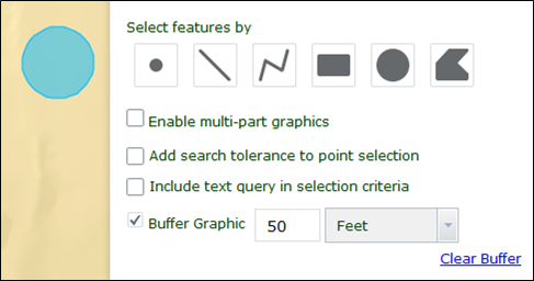

AdamGebhart
I have a few more questions for you and I apologize if they've been covered before.
1) Is there an option in the config to set a maximum buffer distance?  I don't know that we need a max distance, but I'm curious to know if than can be set.
2) When buffering a graphic is it possible to leave visible the graphic around which the buffer was created?  For example, in the image below the blue is a 50' buffer around the point I selected.  I would like to have that original point (or any other graphic I draw) remain visible.  Is that an option?
3) Your Identify widget has the option to "Remove Result" from the Results tab ().  Is it possible to have that in eSearch too?  I know you have the option available on the "By Value" tab, but I'm wondering if it is possible to have available on the "Results" tab.
I am sure I'll have more questions for this widget and your other widgets down the road.  We currently are using the eSearch, Identify, eLocate widgets and may add the eBasemap Gallery widget to our application soon.  Our users find all of them extremely helpful and easy to use.  I would also like to send a big "thanks" again for all of your work and time helping the rest of us.
MVP Emeritus
Adam,
  1. No there is currently no option for this, but I like the idea and will add it to the enhancements list.
  2. Not sure I like the idea of leaving the drawn graphic on the map. That would clutter the map with the drawn graphic, the buffer graphic, and the results graphic...
  3. I had though about adding this before and likely will for the next release.

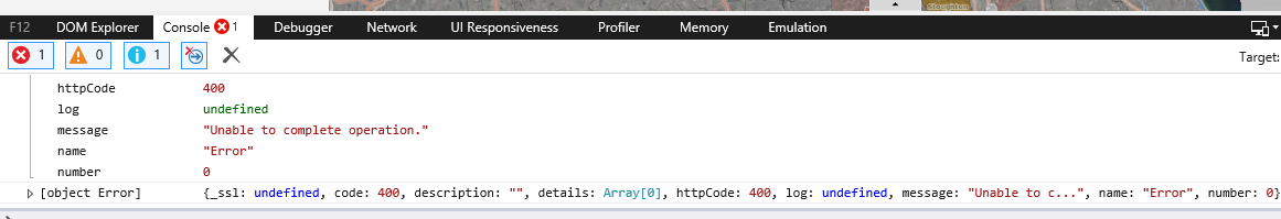

glennhazelton
Deactivated User
Robert,
the combination of date range and value still is failing for me.
i just tryed this sql in the rest and it returned values.
however if i run it in the esearch i get the 'search failed' message box.
i have pasted in an image of what i see with the F12 key in IE.
cl2 < .2 and UTC_DATE between timestamp '2015-11-01 00:00:00' and timestamp '2015-12-03 00:00:00'
MVP Emeritus
Glenn,
   Normally the console show the SQL string that eSearch submitted to the Server. Can you show me that?
glennhazelton
Deactivated User
thanks for the hint
i looked and the AND was missing.
not sure how i missed this when i built the query.
i have fixed it and all is working
thanks for your guidance.!!
