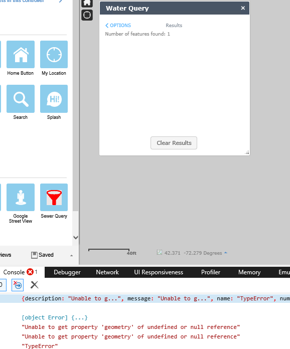

here are 2 screenshots.
note that the dropdown list populates
and it seems to have found the feature but the F12 display shows it is unable to get the geometry.
the point on the map is what i searched on so it can display.

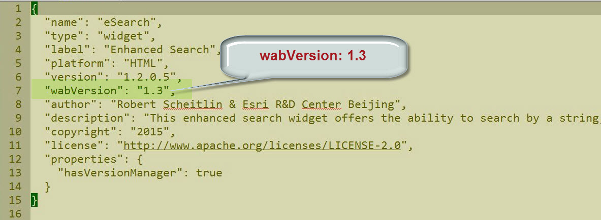

Thanks so much for taking your time to go over my issue of not being able to duplicate or import my apps within the Web AppBuilder.
Thanks for pointing out that the source of the problem is that I have different wabVersion values in the custom widgets I am adding.
For example, when I look at manifest.json file within your eSearch Widget, I see that the webVersion = 1.3
This is the correct value which jives will all the standard ESRI widgets in WebAppBuilder 1.2
However, when I examine the manifest.json file within the AddService widget that I added, I see that the wabVersion = 1.1
This is causing the builders version-manager.js code to throw an error.
I will edit this line to read:
“wabVersion”: “1.3”
I am going to manually clean everything up in the manifest.json file of every widget, and the main config.json file.

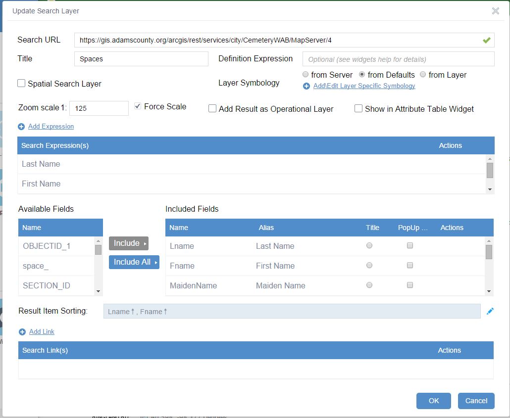

I have two questions for you.  First I am trying to change my Zoom Scale in the layer search.  It doesn't matter what I put in that scale box always zooms into the same scale.  Is there something I'm missing.
The second question is,  what does it base the search results order off?  I'm having it search by name and some names could produce 100 search results.
Thanks for the help and clarification.
RobertScheitlin__GISP
MVP Emeritus
Lindsey,
   Sorry I probably could make this more clear in the help. The ZoomScale is only used when you are zooming to point data that does not have an extent.
  For the second question the results are presented in the order that they are returned from the server unless you set the "Result Item Sorting"
LindseyStone
Thanks for the clarification on the ZoomScale.  Allowing a user to set a zoom scale not only to a point but to polygon would be a great addition to tool, if possible.  With me I am searching extremely small parcels, that it zooms so far in, that the searcher can't even see the streets at that scale.
For the Result Item Sorting,  I just realized I'm a version behind, so I will be updating to your current version to take advantage of that option.
Keep up the awesome work.  Your search widgets have always been great to work with.

I have downloaded your newest version and I'm still having an issue with the sorting.  I looked and my service is set to Support Advanced Queries. Attached is screenshots off all my settings and results.  As you can see that I have it sorted by last name and than first name.  And the first name is all over the place on the results pane; it goes Glenn, Carie, Emmer.  Not much of sorting.config.JPGresults.JPG
MVP Emeritus
Lindsey,
   Wow, can't believe no one has reported this till now. It is a one line fix in the code. If you want to fix your app then open the Widget.js file from the eSearch folder and find:
if(this._isServiceSupportsOrderBy(this.currentSearchLayer)){
In my code it is at line 1568 (assuming version 1.2.0.6)
and change it to:
if(this._isServiceSupportsOrderBy(this.resultLayers[layerIndex])){
Make sure to do this in the [install dir]/server/apps/[app#]/widgets folder and the [install dir]/client/stemapp/widgets folders

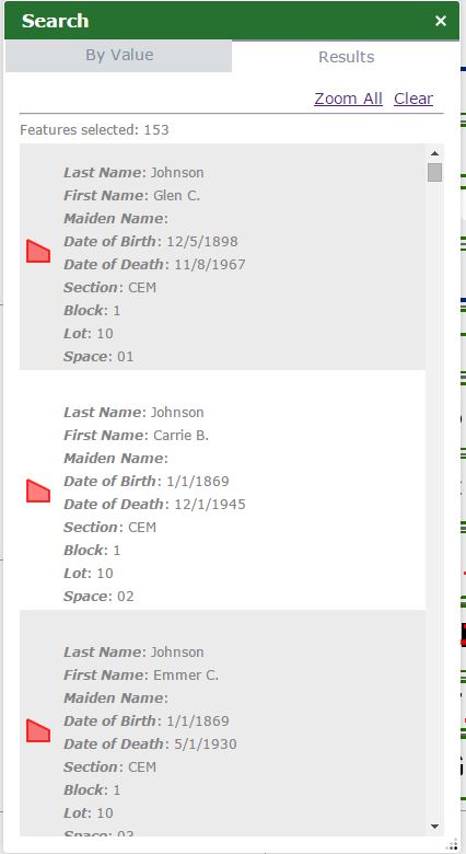

I like the Scroll bar you have added to that helps while entering a long list of Predefined values like for example the Section Numbers that go from 1 through 36.

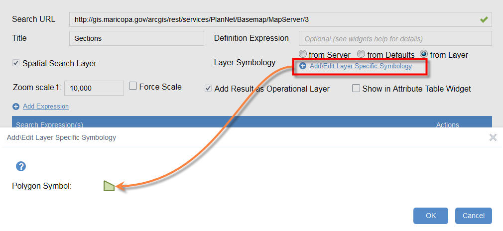

Now I have the option to define my own custom symbols for every layer, if I choose to do so. This is a great enhancement. The Flex version allowed this.
I like how it intelligently allows you to edit only the Polygon symbol, for a  Polygon layer. The Point and Line options do not show up.
Here is the Township Range layer using the Default Polygon Symbology.
However, the Sections can be drawn using my Layer Specific Symbology.

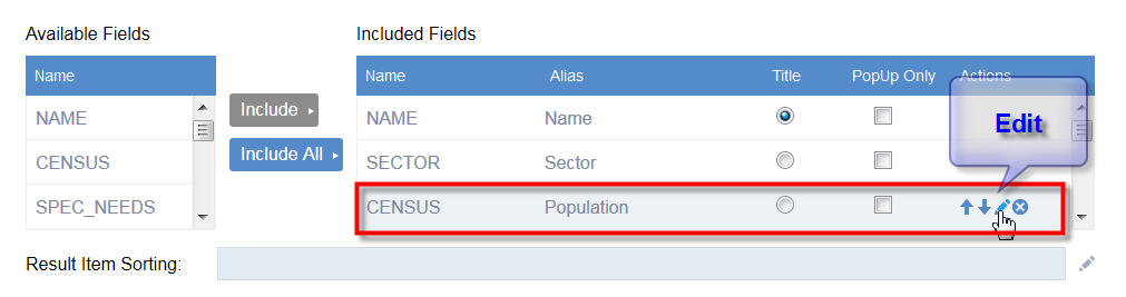

I can now set all my Field Aliases within your eSearch Configuration.
Both the Pop-up and Attribute Table show my Field Alias.
This is an awesome enhancement.
I like how the Attribute Table only shows the Fields that I have included in the Configuration page.
The remaining fields are not displayed in the Attribute Table.

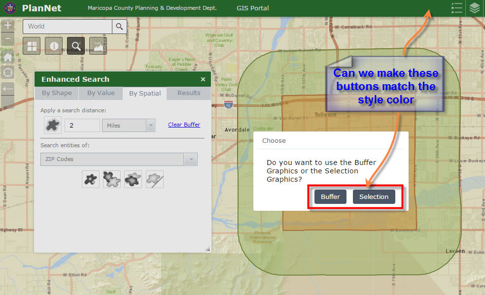

Robert, everything is working flawlessly on all themes.
The colors of the controls match the Style Color.
Can we make these two buttons match the Style Color?
Then again, there may be a good reason to leave it the way it is.

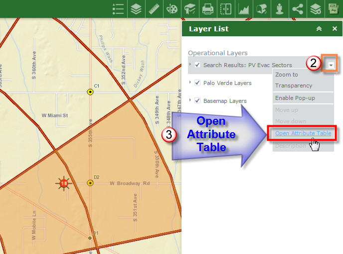

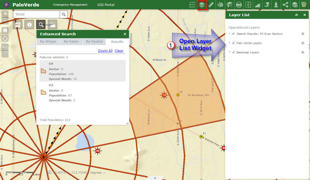

On the Web AppBuilder version, you have to first open the Layer List Widget like so:
Then one has to click on the down arrow on the Search Results Layer and click Open Attribute Table.
Would it be a lot of coding to add a tiny Attribute Table button right on the Results Pane like so?
It could have a tool tip like "Show attribute table".
Then just like your Flex version, the user can open the Attribute Table with a single mouse click.
If you could add this enhancement, it would greatly streamline the workflow.

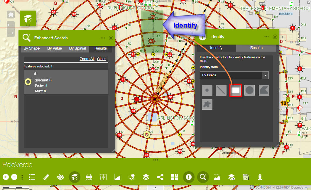

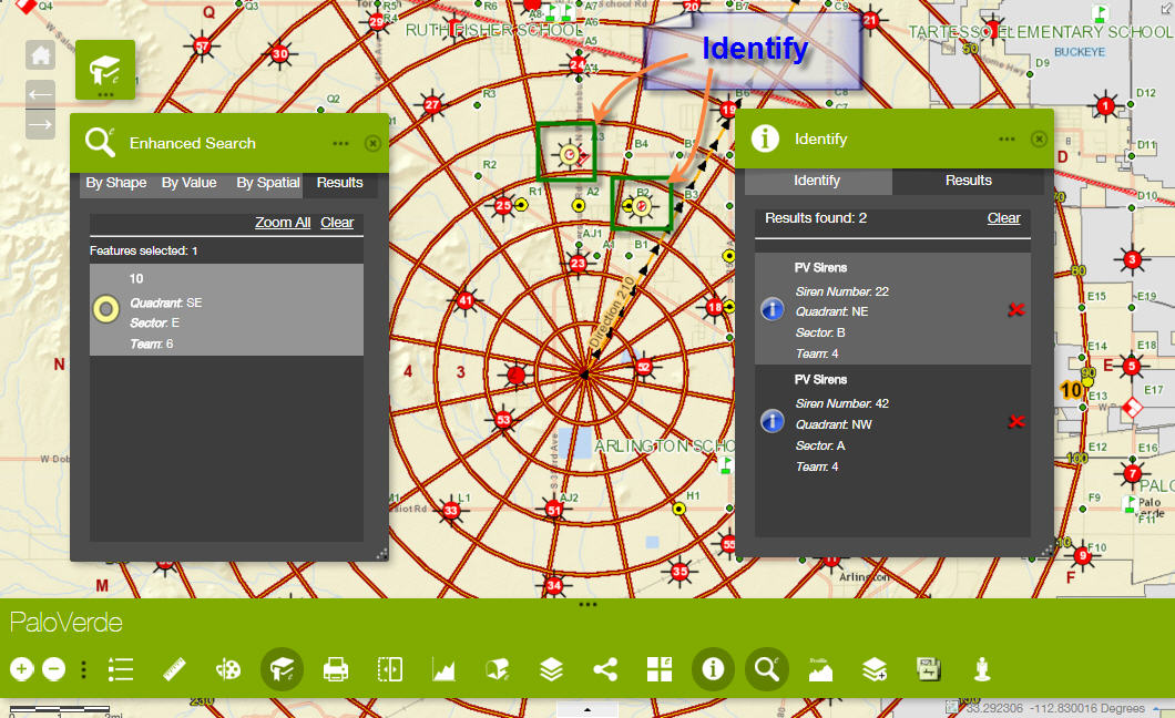

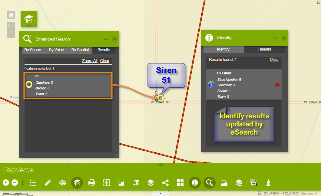

I ran more tests today using different devices. Your Enhanced Search Widget 1.2.0.6 is working like a champ.
I was pleasantly surprised to find how you have fixed the conflicts between the eSearch and Identify Widgets.
It is now possible to run an Identify without first having to clear the eSearch Results.
This was a very important fix for me.

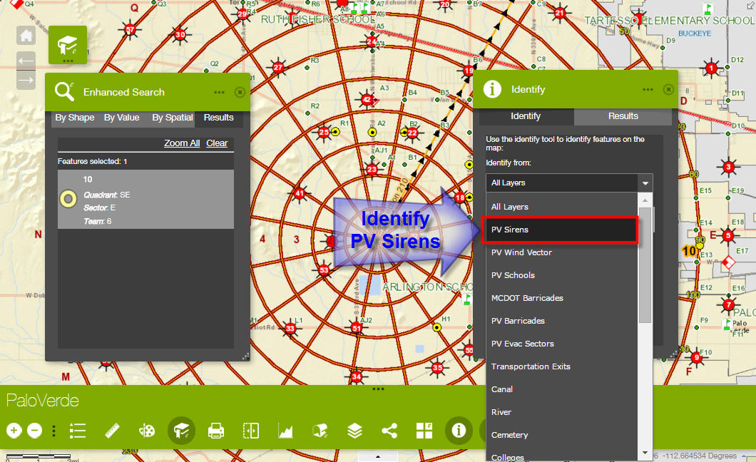

This example is using eSearch 1.2.0.6 and identify 1.2.0.3

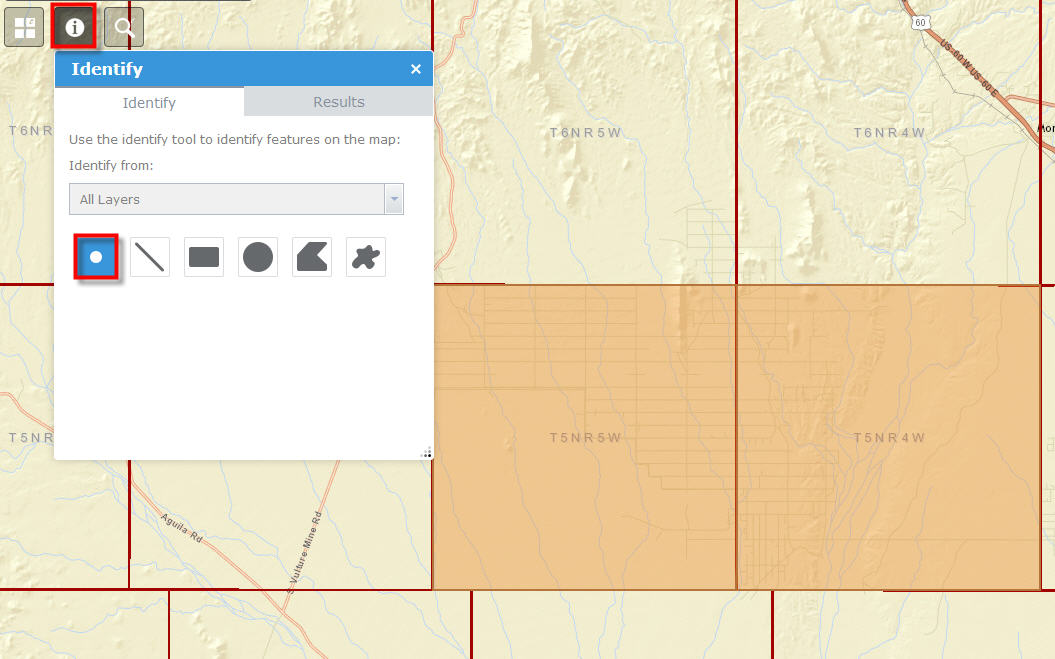

http://www.tapasdas.com/Maps/Phones/app105
I am turning on the Township Range layer.
I am using eSearch and setting my Search layer to Township Range.
I am selecting a couple of Townships.

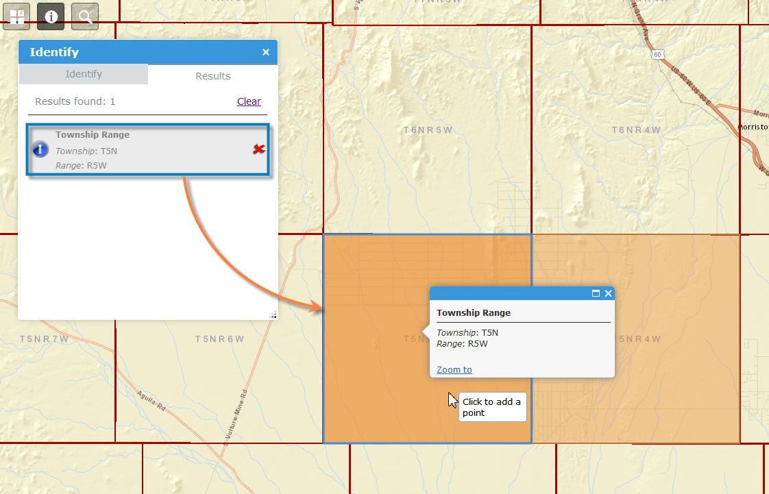

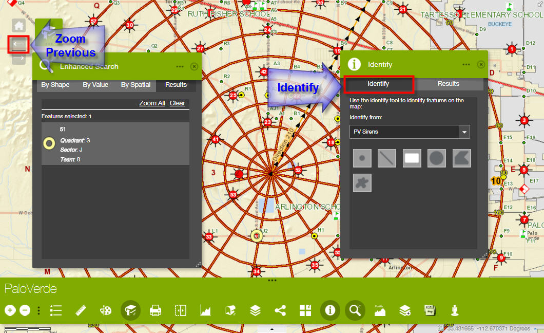

Now, without clearing the eSearch Results, I am opening the Identify Widget.
I am identifying a Township next to the previous two Townships found by eSearch.
The Identify works!
It does not hang anymore.
Whatever fixes you made to eSearch 1.2.0.6 has removed the conflict with Identify 1.2.0.3
I can even Identify a Township that is in my eSearch Results collection.
There is no conflict.
I can reopen the eSearch Widget.
My eSearch results are still active.
This makes the eSearch and Identify completely independent.
Thanks so much for this fix!

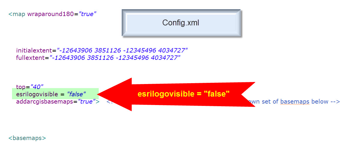

I would like to share a valuable tip from my coworker Kacie Vanasse on how to remove the ESRI Logo.
In the FlexViewer, there was a simple way to remove the ESRI Logo.
In the config.xml file you would enter:
esrilogovisible = “false”
In the Web AppBuilder version you can easily remove both the ESRI Logo and the Map Attribution the appears on the lower right.

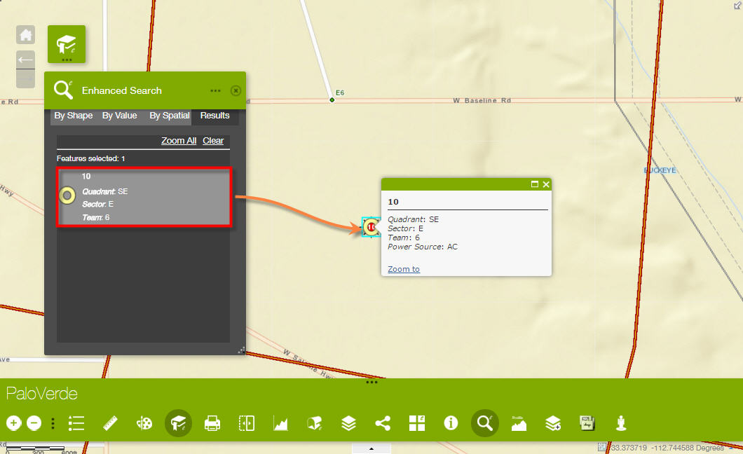

Hi Robert,
I found an oddity.
When you have both eSearch 1.2.0.6 and Identify 1.2.0.3 open, and you run a Graphical Search, it also updates the results of your Identify.
Conversely, if you run an Identify, it also updates the results of eSearch as if they are linked together.
I guess this is perfectly fine and none would mind. It just jumped at me the first time I had both widgets open at the same time.
Here is a test case:
http://www.tapasdas.com/Maps/Phones/app110
First, let's zoom to our study area to view a Point data layer (Sirens)
Open the Enhanced Bookmark Widget and select Palo Verde
The Sirens are symbolized with big red screaming dots.
Minimize the Enhanced Bookmark Widget.
Open the Enhanced Search Widget 1.2.0.6
The default search is By Value
The default search layer = PV Sirens
The default Siren Number = 10
Accept the defaults and press Search
The eSearch Results panel shows Siren Number 10
The map zooms to Siren Number 10.
Use the Zoom Previous Tool to go back to the Previous Extent.
Keep the eSearch Widget open.
Open the Identify 1.2.0.3 Widget
Set the Identify Layer to PV Sirens
Engage the Extent Tool to Identify 2 Sirens.
The Identify Results panel now shows 2 Sirens.
The eSearch Results panel still retains the original selection.
So far, so good.
Keep the Identify Widget open.
Open the By Shape tab on the eSearch Widget.
Activate the Extent Tool and Search for a single Siren.
Notice, how eSearch returns the correct result.
However, this also refreshes the Identify results panel to mirror the eSearch results.
Go back to the Previous Extent.
Open the Identify Tab.
Use the Extent Tool to Identify two Sirens
Notice, how Identify now refreshes the eSearch results panel to mirror the Identify results.
With so many graphic layers active, I know how complex it is to code the selection logic with the possibility of having multiple widgets open and multiple selection tools active that the user may be engaging.
This is your call.

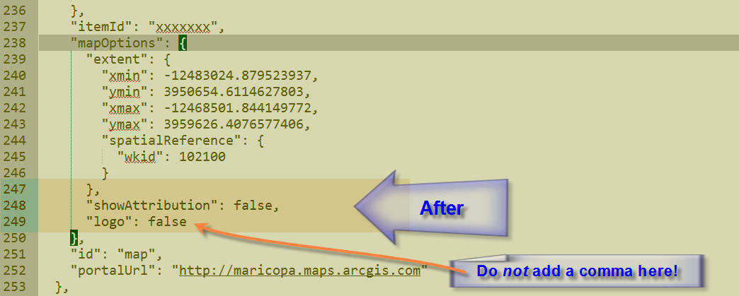

  Another simple way is to add some options to the mapOptions object in the main config.json.
"map": {
    "3D": false,
    "2D": true,
    "position": {
      "left": 0,
      "top": 40,
      "right": 0,
      "bottom": 0
    "itemId": "xxxxxxxxxxxxxxxxxxxxxxxxxxxxxxxxxx",
    "mapOptions": {
      "extent": {
        "xmin": -9588945.63048467,
        "ymin": 3961163.9078186783,
        "xmax": -9521681.045593806,
        "ymax": 4027893.4335115473,
        "spatialReference": {
          "wkid": 102100
      "showAttribution": false,
      "logo": false,
Notice the showAttribution and logo properties.

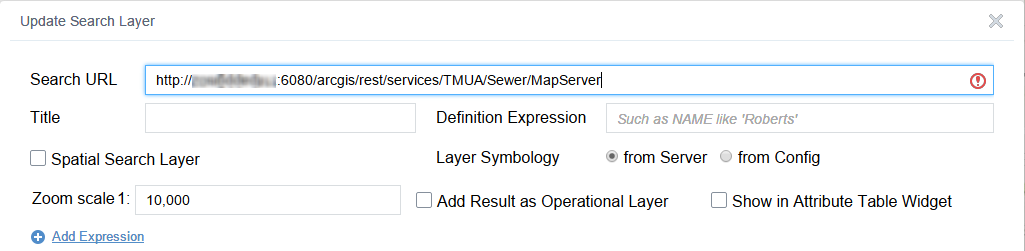

Robert Scheitlin, GISP​, how can I create a Search URL that routes through my Internal proxy?
I have a couple web maps I put together that are for internal ONLY clients. Those maps work great, you helped me on the proxy setup. Now, there is talk of combining some of the functionality into a single map. SO this means that I would have a BLANK operational layer map, and I would need to Enhanced Search using a Search URL from my proxy'd layers.
Any tips? Suggestions? Etc.?

BrianO_keefe
Honored Contributor
When I enter the url:
http://InternalServerName:6080/arcgis/rest/services/TMUA/Sewer/MapServer
I get a red circle with an exclamation in the Search URL field...
If I remove the 6080 then I get the following in my Chrome Developer Window...
I even went and added the part "---- Reference To My Computer ----" part in my proxy, just in case. Nothing.
MVP Emeritus
Brain,
   Ok now I understand better what you are wanting to do. You will not be able to configure the layer if the machine WAB dev is running on does not have access to that url.

DAVIDDAS1
Hi Robert,
I did some more testing this weekend. I have nothing to report.
Thanks for the tip on checking to make sure the wabVersion value is set to 1.3 in the manifest.json of all the Custom Widgets I am adding.
After doing that and starting from scratch, I was able to Duplicate Apps and Import Apps without any errors.
Thanks for showing a simpler way to remove the ESRI Logo and the Map Attribution.
Search for itemId in the config.json file and add the following two map options.
    "logo": false
This is how the mapOptions block looks like before the edit.
This is how the mapOptions block looks like after the edit.
Note: Make sure not to add a comma after the last property:value pair.
For example, adding this comma will hang the application as it is expecting to read another property:value pair.
"logo": false,
This was an excellent tip. I will be using this trick on all my Web Apps from now on.

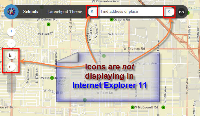

There was an odd behavior I noticed while using Internet Explorer 11.
This has nothing to do with your Custom Widgets.
This is something for Moxie's team to look into.
I am using this Foldable Theme as an example:
http://www.tapasdas.com/Maps/Phones/app114
All the icons display correctly in Firefox and Chrome.
However, a couple of icons are missing when using Internet Explorer 11.
Here I am using the Launchpad Theme as an example:
http://www.tapasdas.com/Maps/Phones/app115
However, I am seeing the characters h, i, n, and c in place of the icons in Internet Explorer 11.
Here are a couple more artifacts related to the Overview Map in IE 11.
