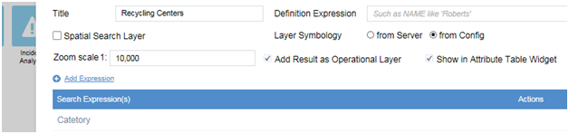

  I just figured out why I wasn't getting results I expected.  It looks like you need to have the "add result as operational layer" box checked as well if you want results to show in the attribute table.  The results are added to the attribute table if the following condition is true:
if (layerConfig.shareResult && layerConfig.addToAttrib) {      //in widget.js
RobertScheitlin__GISP
MVP Emeritus
Sebastian,
   In the previous versions you would be presented with a warning message about need to have both options selected when using the widgets configuration UI. I see that this logic is not working in 1.2 version. I will get this fixed for the next release.

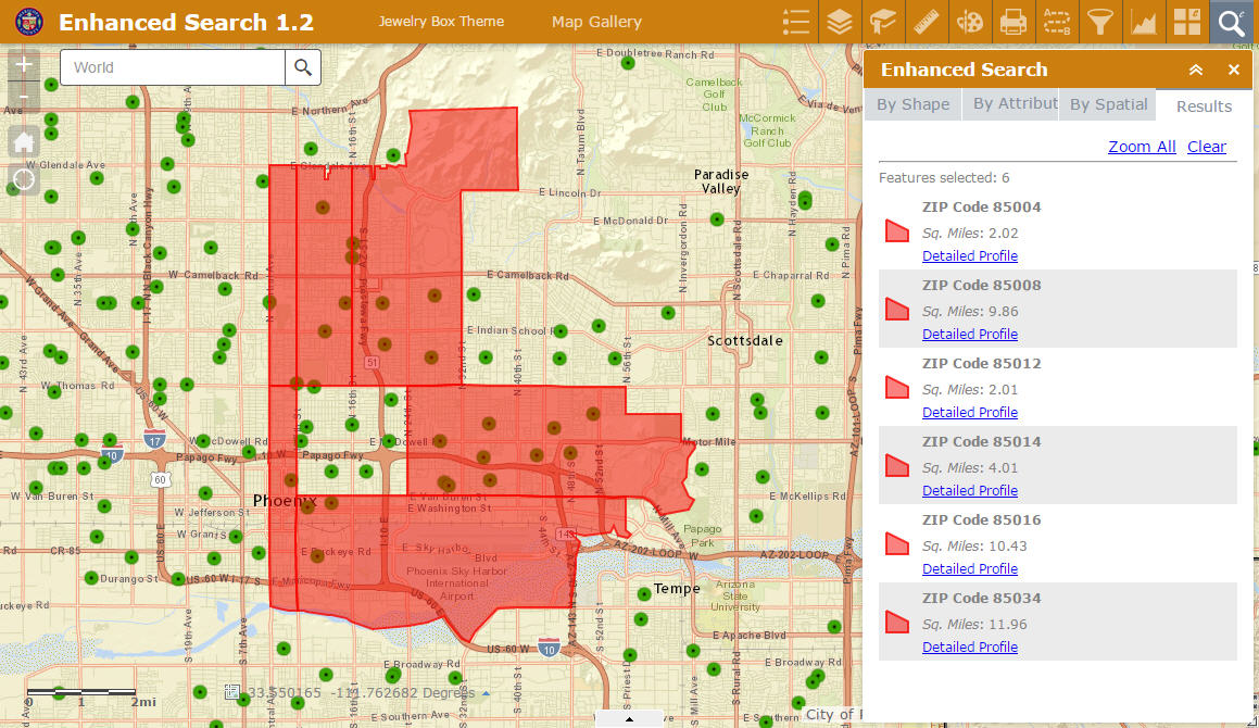

You have once again done an absolutely amazing job with version 1.2 of your Enhanced Search Widget. The integration with the Attribute Table now works like a dream.
Moxie and his team did a complete overhaul of the Attribute Table in version 1.2 of the Web AppBuilder. It is now rock solid. The original issue with the spinning busy cursor and erratic load times have been fully addressed in this release.
This makes it a joy to use your Enhanced Search Widget in WAB 1.2
I tested your Widget on six different themes.

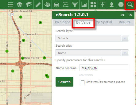

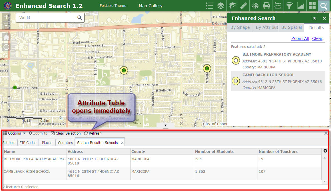

Foldable Theme:
http://www.tapasdas.com/Maps/Phones/app41
I like how the Attribute Table now opens up and populates the selected records immediately. There is no lag.
The foldable theme is ideal for viewing on Tablets and Smartphones. The GUI collapses gracefully as you reduce the size of the window.

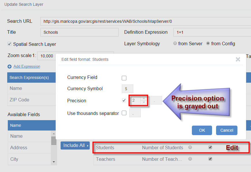

I came across one minor issue.

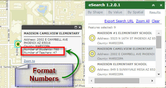

I want to display a numeric field with 0 decimal places.
However, in the results pane and popup it shows up with 2 decimal places.
When I attempt to edit the Field Format, I see that the Precision option is grayed out.
It is setting a default precision of 2 decimals places that I cannot change from the GUI.
These are the map services I am using.

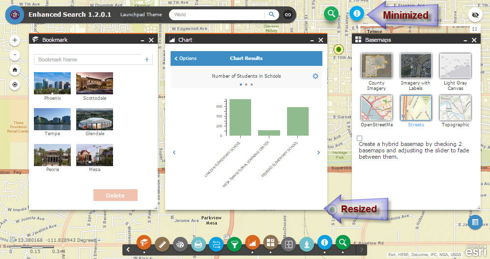

Launchpad Theme:
http://www.tapasdas.com/Maps/Phones/app42
The Launchpad Theme is ideal for Laptops & Desktops. It allows you to have multiple widgets open at the same time. You can resize and move the widgets. You can minimize the open widgets to reduce screen clutter.
It only takes one click of a mouse to convert the Foldable Theme to the Launchpad Theme. We will be publishing both versions, one optimized for Smartphones, and the other optimized for the Desktop.
The Launchpad Theme gets closest to mimicking the Flex apps.

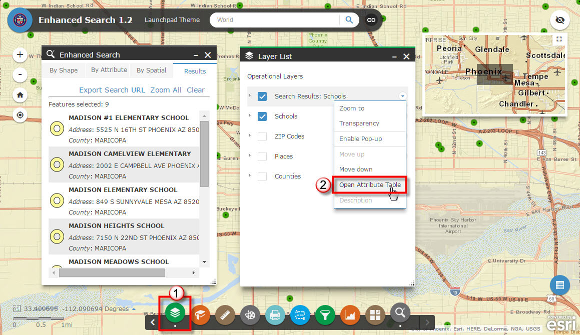

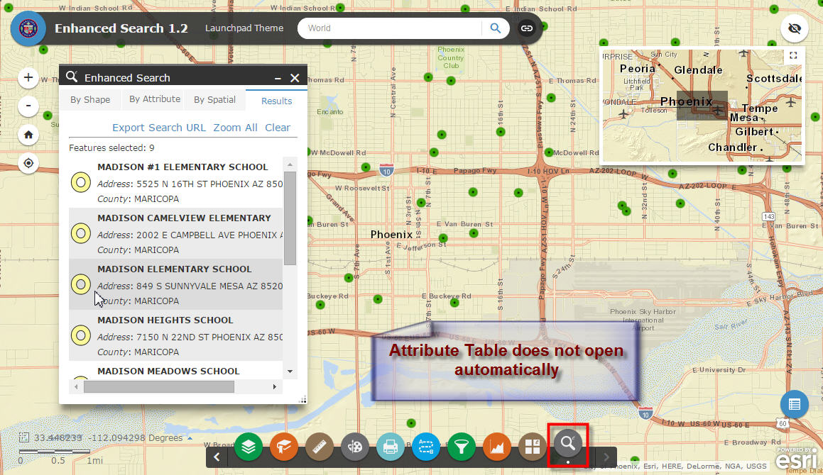

However, I found a minor issue with the Launchpad Theme. I expected the Attribute Table to open the moment I got back the Search Results. It did not open automatically.
As a workaround, I had to open the Layer List Widget and select Open Attribute Table.
Then the Attribute Table showed up. This behavior is peculiar to just this theme.
It works fine on the other themes.

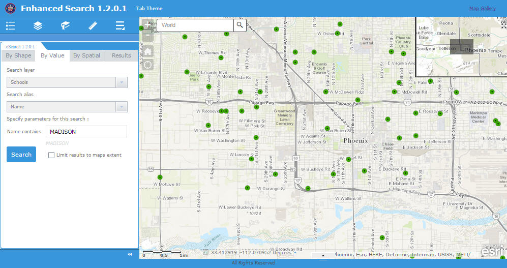

The Tab Label "By Attribute" is too long. It does not fit.
I would be replacing this with "By Text" or "By Data" in the \widgets\eSearch\nls\strings.js file.

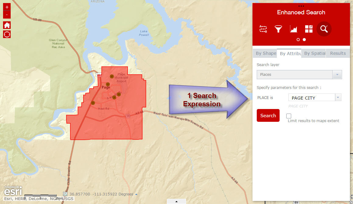

I like how the Enhanced Search GUI is simplified when there is just 1 search expression. This gives it a cleaner look.
MVP Emeritus
Tapas,
   All issue addressed in version 1.2.0.1.

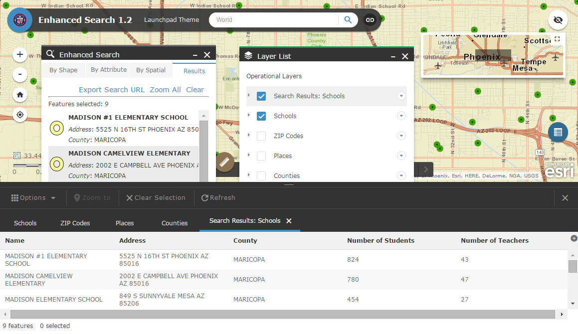

I just have one similar thing about attribute table like TAPDS DAYS in his post for Launchpad Theme.  We also use Launchpad Theme, and when I checked both result option as below “Add Result as Operational Layer” and “Show Attribute Table Widget”,
The attribute table did pop up automatically, but the attribute window is empty (as below):
If I uncheck the "Add Result as Operational Layer” and run it, then open the Layer List Widget and select Open Attribute Table, everything is fine.  Is there any method I can adjust this to have a pop up automatically after searching with all the results inside?  Thanks!

Lei,
  I am not seeing this when I test version 1.2.0.1.

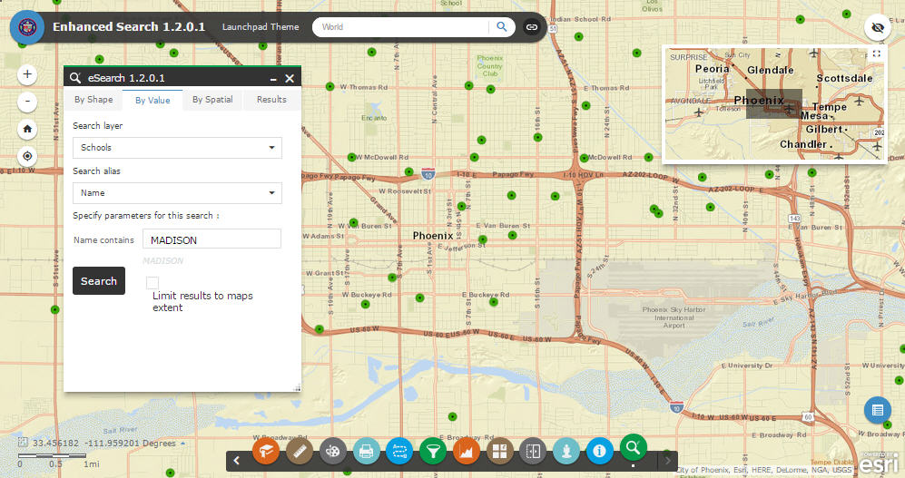

I created six new web apps using the latest versions of your Custom Widgets:
  • Enhanced Search Widget 1.2.0.1
  • Identify Widget 1.2
  • Google Street View Widget 1.2
  • Enhanced Basemap Gallery Beta 1.1
Foldable Theme
http://www.tapasdas.com/Maps/Phones/app47

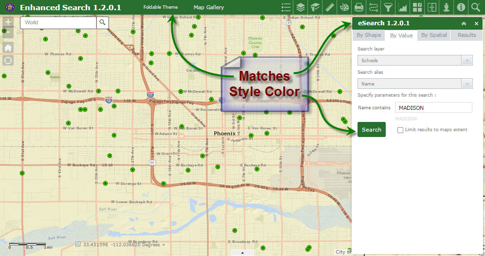

I like how your UI controls matches the style color that is picked.
The shorter "By Value" label is a clever substitution for "By Attribute" which gives it more breathing room.
I can now format numbers with zero decimal places.
Attribute Tables get populated without any delay. This is one of the best enhancements in WAB 1.2.

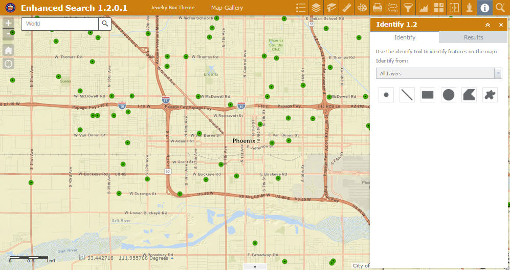

Your Identify Widget 1.2 works very well in WAB 1.2.

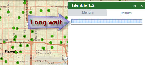

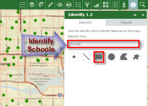

However, it seems the Identify is taking a wee bit too long. Maybe this is my imagination.
I am identifying the Schools layer using the Extent Tool.
I am getting this busy gif for a long time.
It was much faster in version 1.1.2
Eventually, the results do show up.

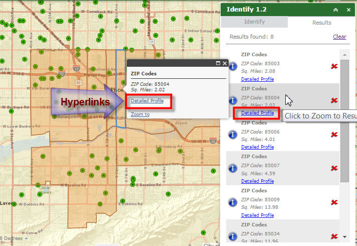

All hyperlinks work as expected.

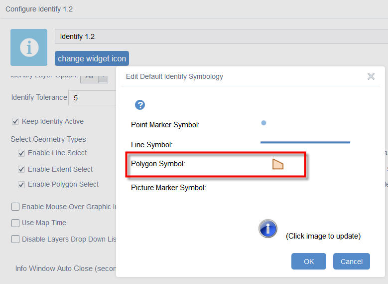

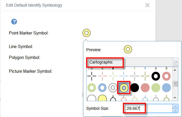

I can Edit the Default Identify Symbology and select my Polygon Symbol.
However, when I select my Point Marker Symbol, it reverts back to the default blue dot.
So, when I run an Identify, I get a tiny blue dot. It is hard to differentiate this from the green symbols I already have on the map. I was expecting to see a large yellow donut.

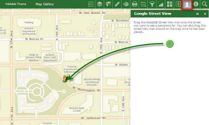

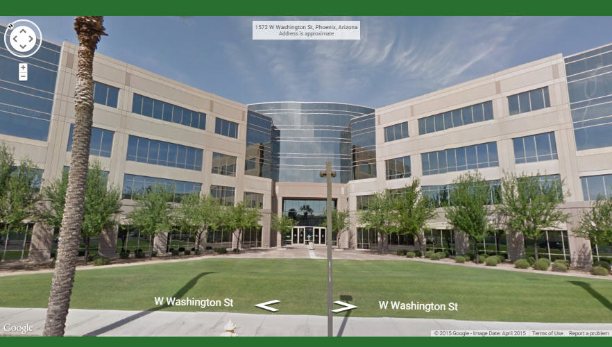

Google Street View 1.2 works very well.
I like how you can open this window on a second monitor.

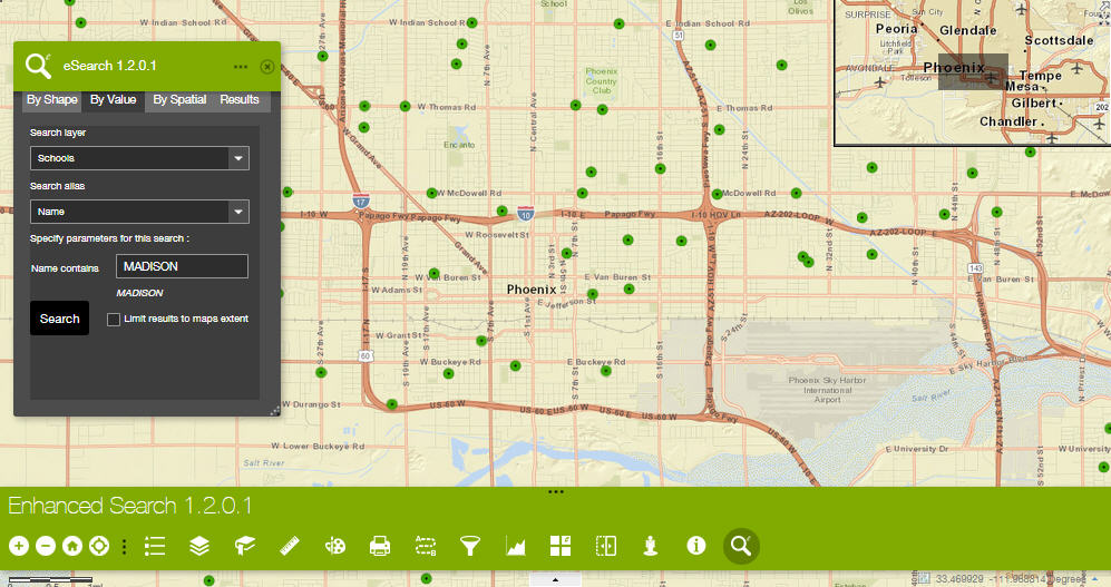

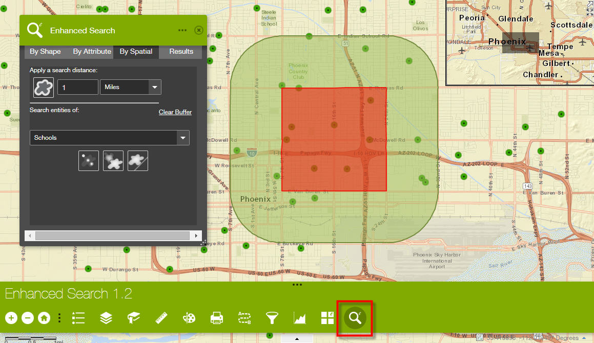

Launchpad Theme
http://www.tapasdas.com/Maps/Phones/app48
I like how the Attribute Table opens the moment I run a search. You have fixed this issue.
We will be using this theme on Desktops. I like how you can open multiple widgets, resize them, reposition them, and minimize them.

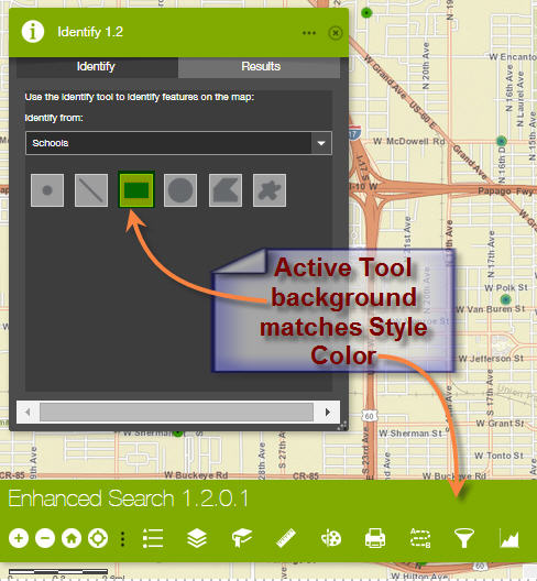

Dart Theme
http://www.tapasdas.com/Maps/Phones/app49

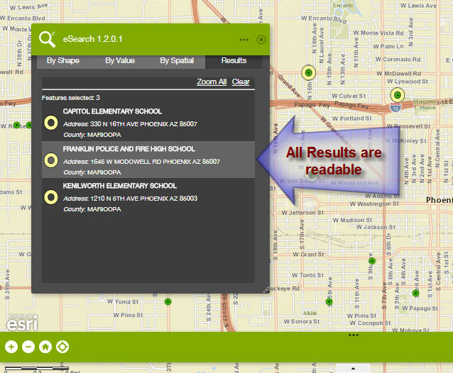

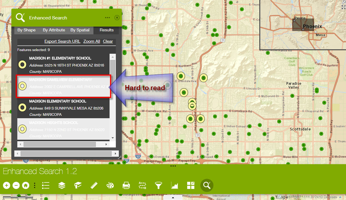

All the results are now readable. You have fixed this issue with the eSearch Widget 1.2.0.1 in this theme.

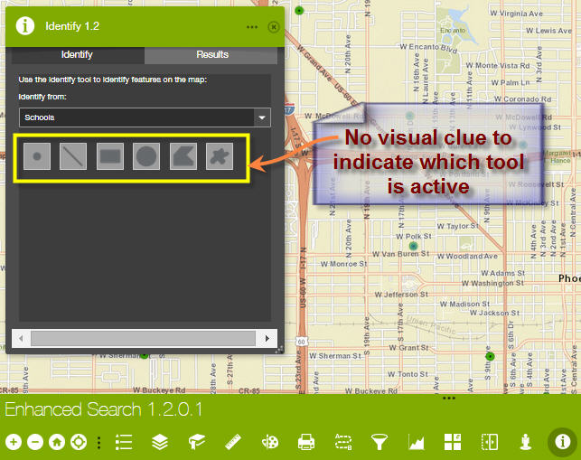

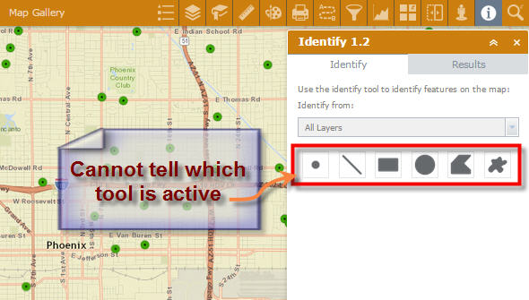

However, some results are hard to read in your Identify Widget 1.2.
Also, there are no visual clues to tell which tool is active. They all have the same gray shade.
It would be ideal if the active tool has a background color that matches the style color. This would really make it stand out.
It would be nice to have this color match happen on both your eSearch and Identify Widgets.
Tab Theme
http://www.tapasdas.com/Maps/Phones/app50

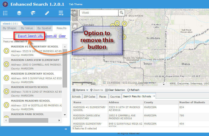

Can you please provide a way to remove the Export Search URL button from the Results Pane? This will give it a cleaner look for cases where the user will not be using this function.

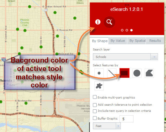

http://www.tapasdas.com/Maps/Phones/app51
It would be nice if the background color of the active tool matches the style color.

http://www.tapasdas.com/Maps/Phones/app52
When I click on a Tool in the Identify Widget, I expect the background to turn gray.
It does not. So the user has no feedback to tell which tool is currently active.

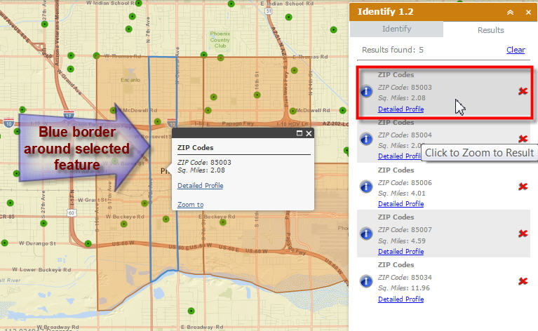

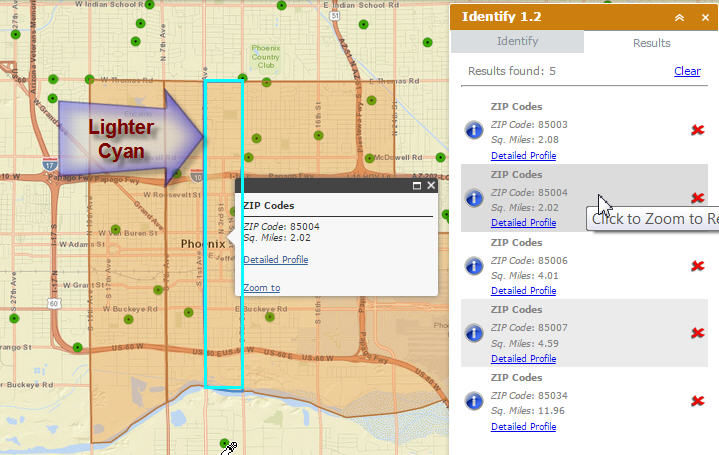

I like how in your Identify Widget when you hover your mouse over a result, the corresponding feature is highlighted with a blue border. This makes it very easy to identify the feature from the results.
However, would it be possible to use a light cyan color to make it stand out even more?
Perhaps something like this.

Is anyone reporting any issues with the display of coded value domain descriptions as returned in the eSearch when the search layer url is pulling from an endpoint that contains subtypes?  I have a simple habitat-type layer that returns codes only in both the results dgid and popup.  Is there any other configuration steps I can take to enable attribute values to display the domain descriptions when the seach layer has subtypes?
Thanks-
David
MVP Emeritus
David,
   Are you talking about using the latest 1.2.0.1 version and the widget results are the only thing that is not displaying correctly?
MassimoBisogno

Robert: yes I believe so.  Version 1.2.0.1 dated 8/24/15.  Yes, the widget results and widget popup do not display the descriptions, just the code. For this particular layer, the subtypes do begin at 0 - could that be causing an isssue?
Here is the rest endpoint if you have time to take a look . . .
Layer: ScrubJ ay Habitat (ID: 3)
David
DavidColey
MVP Frequent Contributor
Robert -  In testing with another layer containing subtypes 1-n (ie no 0 value) I am finding that the results panel and popup both display coded value descriptions.  However, the subtype value is displayed as it's integer value and not its description in both panel and popup...
David
MVP Emeritus
David,
   Thanks for reporting the issue it is a simple issue in the code evaluating a  0 as false and thus not continuing in the code block. I will have this fixed in the 1.2.0.2 release.

one more little graphic thing if it is not too hard ..
the 'hint'  under the box where you put the value for the search is really hard to read as it is very grayed out.
would it be possible to make this darker? in the image below it says 'Pick a Town'.
MVP Emeritus
Glenn,
   The hint text is several shades darker and I think you misinterpreted one of my previous posts to mean that there was an issue with date searches. I and several others have date searches working fine. I don't use Oracle and thus have no way to help you there. You can check the web console and see the exact SQL that is being submitted to your web service. maybe that will give you a clue.
glennhazelton
Deactivated User
ok
thanks
if i figure out the date thing i
'll let you know.
i appreciate you taking the time to respond.
have a good day.
MVP Emeritus
Glenn,
   If the hint is not dark enough for you then you can adjust it in the CSS. In the eSearch widgets style.css change the color:
.widget-esearch-single-parameter .hint {
  font-style: italic;
  font-size: 12px;
  color: #8996a0;
  margin-top: 5px;
