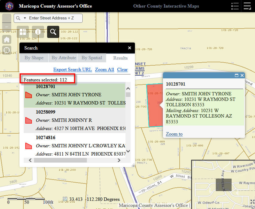

DAVIDDAS1
Hi Robert,
Thanks a million for version 1.1.9 of your Enhanced Search Widget!!!
I tested your latest version this weekend. It rocks.
http://www.tapasdas.com/Maps/Phones/app26
This magical widget wraps 4 essential functions - Identify, Search, Buffer, and Spatial Relationships - all under a simple, elegant and intuitive GUI that a lay person can figure out without having to read a help manual.
I am amazed to find how well it handles 49 Search Layers. The Parcel layer has around 1.6 million records.
This was the most critical widget we needed for our migration to JavaScript. Your widget has delivered in spades.
THANK YOU!
Tapas

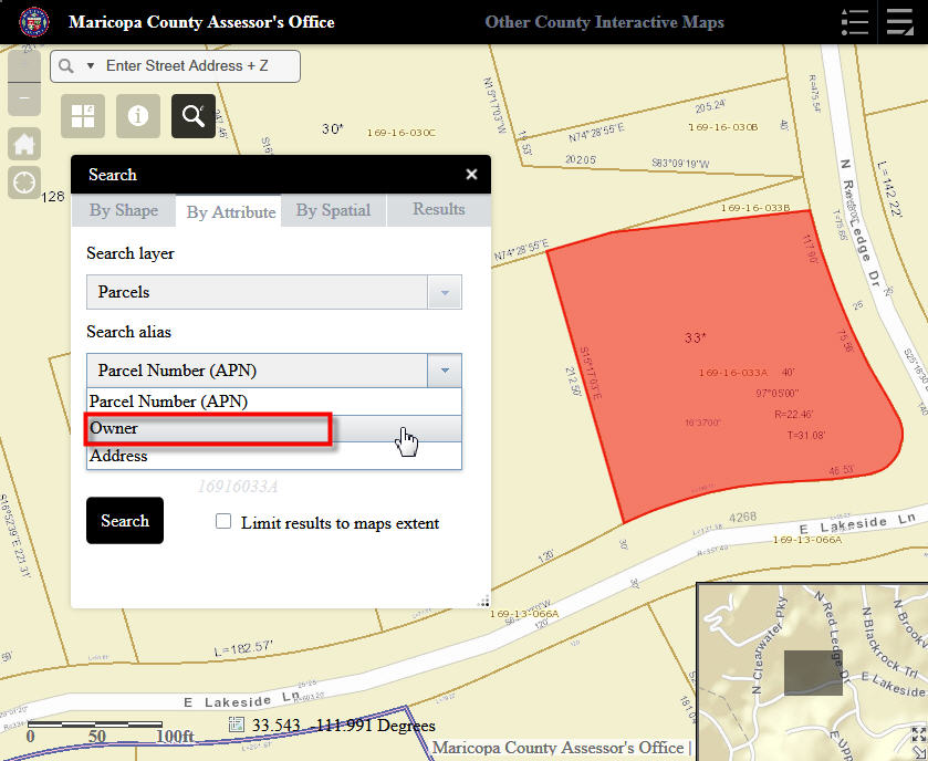

by Anonymous User
Not applicable

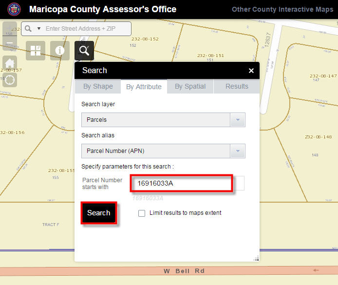

Robert Scheitlin​ or power users like TAPAS DAS​ I have a question.
I have only used this widget once in one viewer on one service o far so I am kind of a newbie at it. Here goes.  I had it on Parcel 2014 service.  Well we now have a Parcel 2015 service. All the layers and even layer ids are the same except i just has a 2015 layer in it now.  So I switched my AGOL Arcgis.com map over to the 2015 service and removed the 2014 service. I did a find/replace all in eSearch and your Identify for 2014 changing to 2015 in the URL strings so it would point to the new service's URL. I relaunched WAB Builder.  When I go to add a new Expression, the attribute field name popup is blank. Restarted WAB several times, tried different browsers, same result. Has anyone else seen this?  I am on 1.1.9.
DAVIDDAS1
Hi Kevin,
This should be fairly easy to track down.
Could you please give us a copy of your config file for your eSearch?
Could you also give us an Item List of your Web Map on ArcGIS Online that lists all the data layers you are using.
It should be easy to match them up.
Thanks,
Tapas
DAVIDDAS1
Kevin,
Here is one thing you can try.
Remove the eSearch Widget, and then add the eSearch Widget back into your Web AppBuilder session.
This will essentially blank out the contents of the eSearch config file, and you will be starting fresh.
When you add the URL to your 2015 Parcel Map Service, make sure that you include the index number at the end of the string. It must always point to a specific layer ID for it to work.
For example, this will work:
http://gis.maricopa.gov/arcgis/rest/services/PlanNet/Basemap/MapServer/1
However, if you leave out the layer index, it will not work:
Thanks,
Tapas

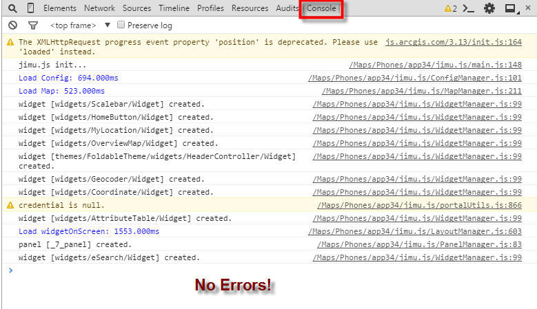

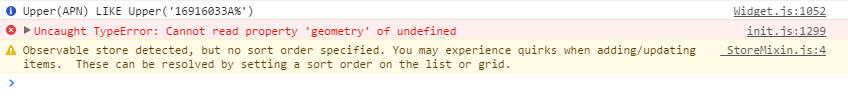

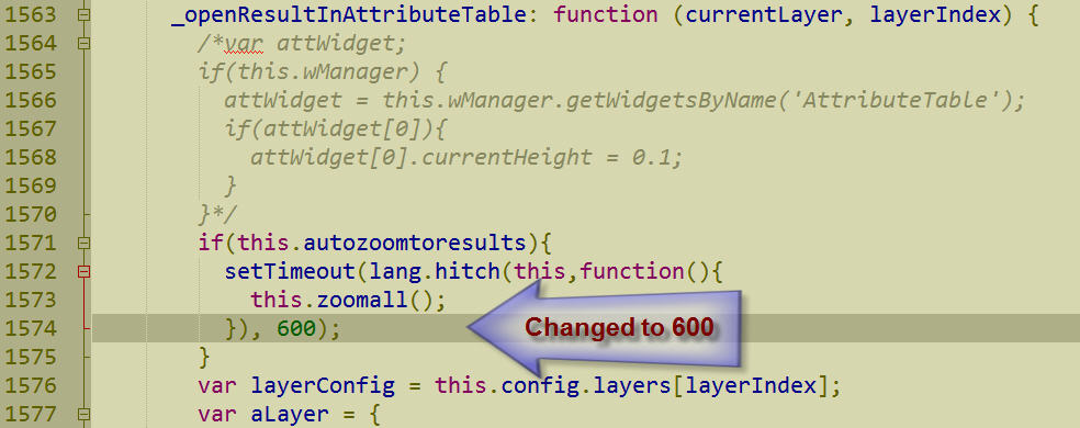

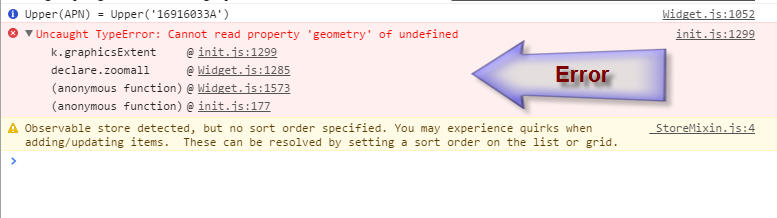

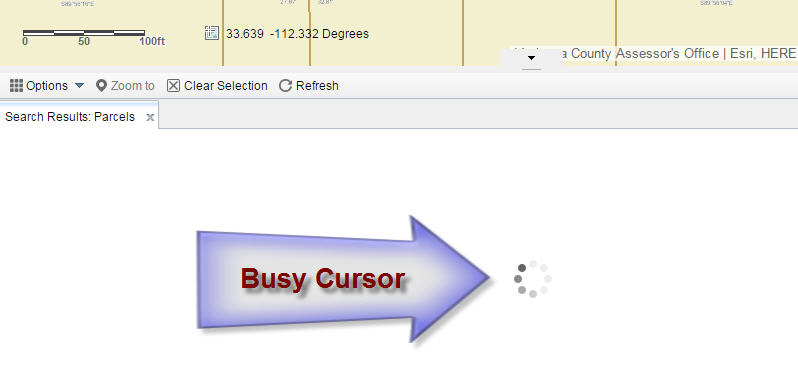

DAVIDDAS1
Hi Robert,
I would like to revisit the error message reported by Tim Jacobsen a few days back.
This is not an issue with your Enhanced Search Widget 1.1.9, but rather with the Attribute Table Widget from the Web AppBuilder Developer Edition 1.1 that your Widget connects to.
Nevertheless, I would like to bring this up because this is going to affect everyone of us using your Enhanced Search Widget.
The problem is easily reproducible 100% of the time.
To illustrate the issue, I have made 2 test cases - app32, and app33.
The first one works flawlessly while the second one throws an error.

Next, try a search by Owner Name
Enter the example Owner Name (Last Name, First Name) = Smith John
112 matches are returned

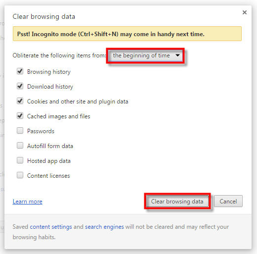

First you would need to clear our your Browser Cache by entering <Shift><Ctrl><Del>
Next, launch app33 in Chrome:
http://www.tapasdas.com/Maps/Phones/app33
Turn on Developer Tools in Chrome.
There are no errors to start with.
Search for the example Parcel Number = 16916033A
The Attribute Table opens with the Busy Cursor
After an annoyingly long wait, the Attribute Table does get populated.
However, the Console Window in Developer Tools throws this error:
Uncaught TypeError: Cannot read property 'geometry' of undefined
These are the details:
It appears this is something that Moxie and this team needs to address.
Try a Search for Owner Name containing "Smith John"
Once again you get the busy cursor, and after a long wait the Attribute Table gets populated.
However, you get the exact same error message:

   Can you try something for me? open the widget.js and about line 1571 find this if statement :
       if(this.autozoomtoresults){
          setTimeout(lang.hitch(this,function(){
            this.zoomall();
          }), 300);
Change the 300 to 600 and test again.

I cleared my browser cache with <shift><ctrl><del> in Chrome and reloaded app33:

I ran the example Search:
APN = 16916033A
The correct result appears in the Results Panel very quickly.
Next, an empty Attribute Table appears with the spinning wheel.
Next, the error message appears in the Console Window.
Finally, the correct attributes are displayed in the Attribute Table.
Note:
If I rerun the exact same search a second time without emptying the cache, no errors are returned.
If I run a new search with another APN value for example:
APN = 16916033B
APN = 16916034
the error comes back.
Conclusion:
Increasing the setTimeout value or replacing the LIKE operator with the = Operator did not help to remove the Error Message:

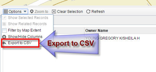

I have a simple enhancement request that will solve our problem with the Attribute Table right away.
The real reason we like to have the results displayed in the Attribute Table is because of the nifty Export to CSV option. This is a powerful feature.  It allows us to view the results in Excel, make charts, reports, and perform further analysis.
The Attribute Table also allows us an easy way to sort the columns. However, this can be done easily in Excel.
So if the Export to CSV function is the only real requirement, would it be possible to add this option directly on your Results Pane?
Here is a mockup of how it may look like:
If we can get this option on the Results Pane, and the Export to CSV captures all the fields that are shown in the Popup, then we won't have any need to display the Attribute Table.
We can completely bypass the Attribute Table, and enjoy faster performance, and more screen real estate to display the map.
It would also be wonderful to have this Export to CSV option on your Identify Results Panel as well.
In the Flex version of your Identify Widget, you had a Copy to Clipboard option which we found very useful.
http://www.tapasdas.com/Maps/Desktops/web37
If you could give us an Export to CSV option on the Results Panel of your eSearch and Identify Widgets, it will immediately solve our issues.

Hi Robert,
We got another tip from ESRI that may explain why we are getting this error.
They explained that the zoomall function is getting invoked before the queries are coming back from the server.
The setTimeout value in milliseconds is there to delay the calling of the zoomall function allowing sufficient time for the results to be returned.
Line 1574 on file widgets\eSearch\Widgets.js
The default value was 300 milliseconds. This delay is enough for most scenarios.
However, we are making searches on the Parcels Layer with around 1.6 million records.
It can take around 12 seconds for the results to appear.
So until this 12 seconds have elapsed, the array this.currentLayerAdded.graphics is empty.
Line 1280 on file widgets\eSearch\Widgets.js
So when the zoomall function tries to read the first item of this empty array, it throws the error.
The trick will be to add the necessary logic to make the call to the zoomall function to wait until the array is populated.
If the wait time is based on a fixed delay value like 300 or 600 milliseconds, it will be a hit and miss scenario. One cannot anticipate the size of the database being queried.
This makes the solution complex.
Perhaps the delay time can be a user defined value tied to a specific layer.
Perhaps there could be a way to check to see if the array is empty before calling the zoomall function.
