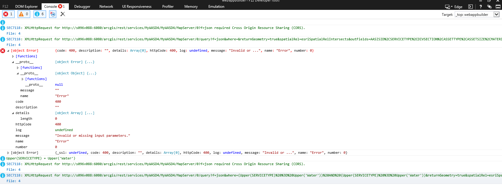

   Actually it's the console tab that I need to see.

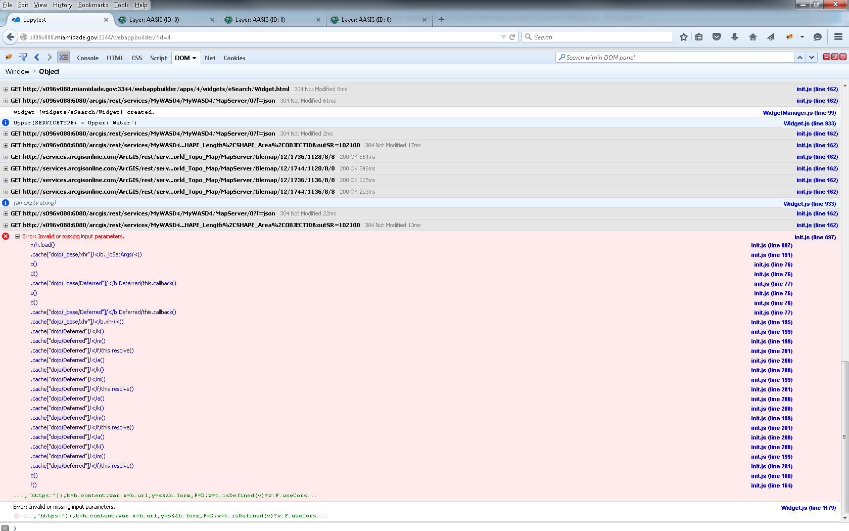

joaquinfernandez

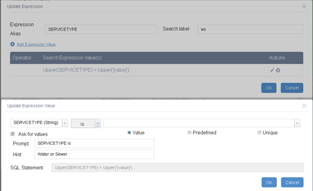

It finds Water but not Sewer but if I change the order of the items in the domain. Sewer first then Water, it finds Sewer not Water.
joaquinfernandez
this is in IE 11, thank you for your time.
RobertScheitlin__GISP
MVP Emeritus
Joaquin,
   OK now all I should need to see is your config_Enhanced Search.json file. This is located in your C:\[install dir]\server\apps\[app num]\configs\eSearch folder
joaquinfernandez
Robert,
Below is the Enhanced Search.json

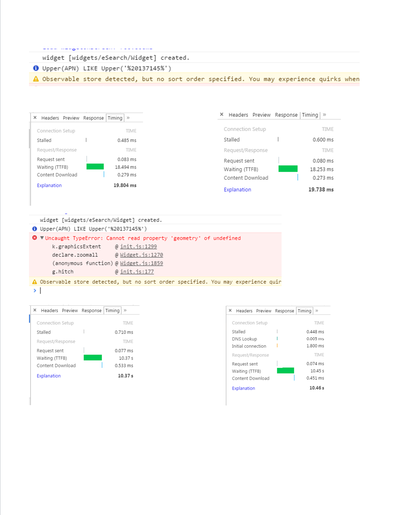

I am using version 1.1.8 and am getting mixed results when performing a search and having the Search Results populate in the Attribute Table.
Sometimes the Attribute Table widget will get populated with results and other times the Attribute Table will just be blank. I've tested this on IE, FF, and Chrome as well as had other staff test on their machines with the same app. We are all experiencing the same mixed results.
I can get the Search Results to successfully populate the Attribute Table each time IF I first open the Attribute Table widget THEN execute the search.

   If you look at the web console the error is occurring in the Attribute Table widget and that is outside of my control. The work around that I have found is that when the Attribute Table widget opens but is empty you just need to right click on the layer in the LayerList widget and choose open in attribute table and then it will be fine for each search from that point on. At some point I will discuss this issue with the WAB Dev team and see if we can get some resolution to this.

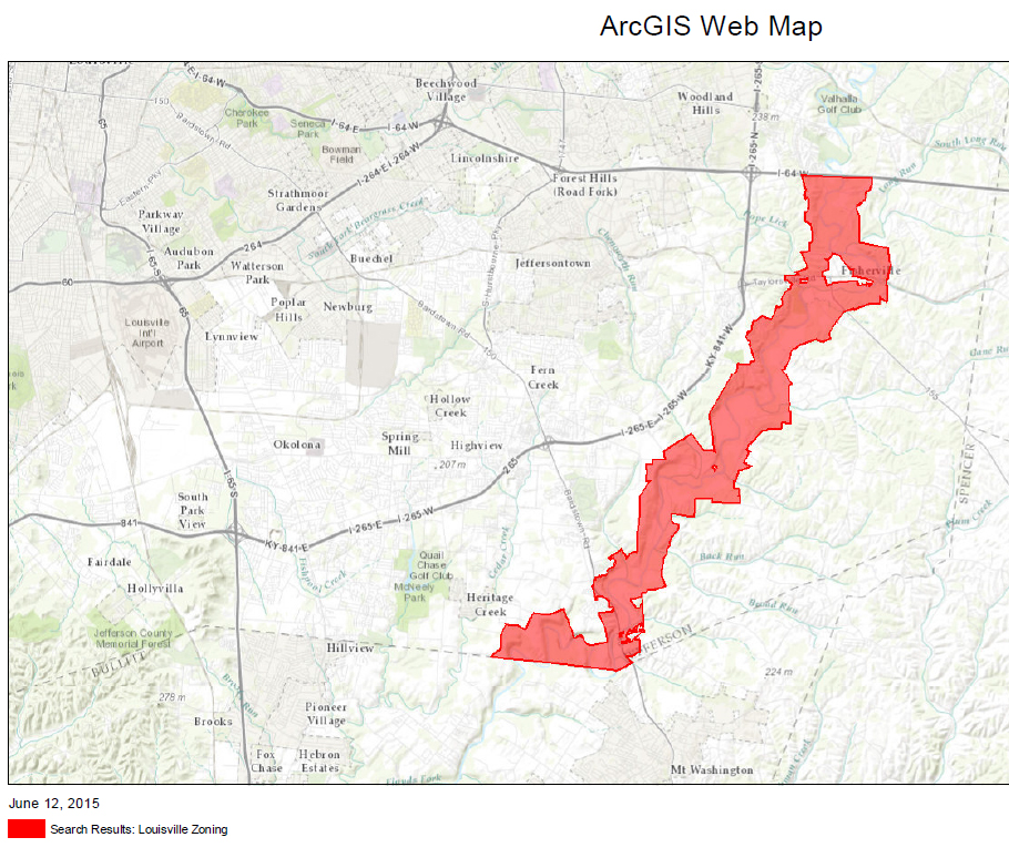

Is there a way to change the name of the Search Results layer in the print output legend? For example, in the attached image, the legend item in the print output is "graphicsLayer3". Users might find it more helpful if the layer were named something like "Search Results - Layer Name". Should this question be posted outside of the eSearch widget thread?
Thanks,
Andrew
MVP Emeritus
Andrew,
   This is one of those strange things that the JS API does. I add all the searches to the map in the same fashion but some layers print like yours with graphicsLayerXX and some print just fine like this one
I guess I will have to get with tech support and see if I can get this one figured out.

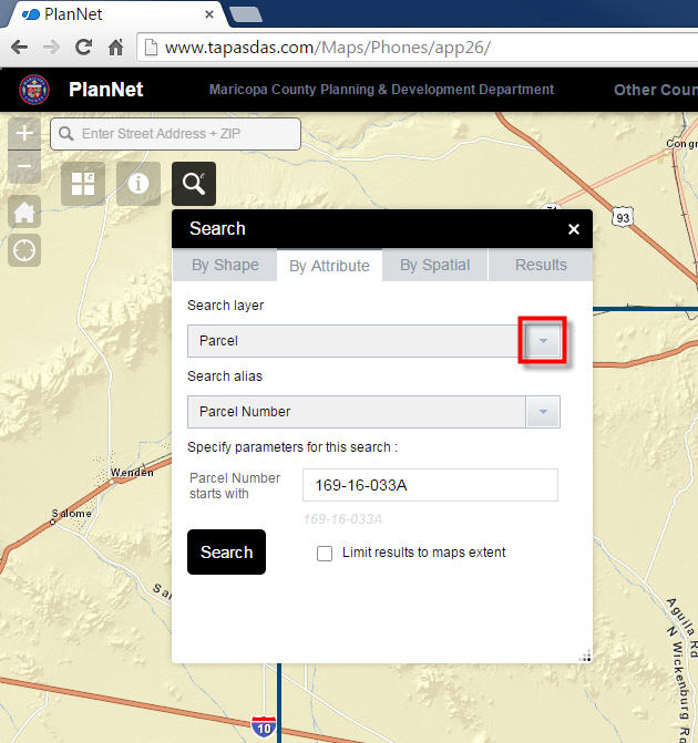

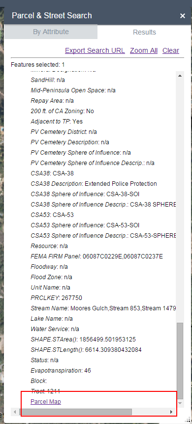

I've implemented eSearch to search on our parcel layer which has quite a large number of attribute fields. I've easily configured a link to our assessor parcel maps, but the link shows at the bottom of a very long list of attributes.
Is there an easy way to have that link show up at the top of the attribute list and not at the bottom of Results?
thanks!
by Anonymous User
Not applicable
Hi Paul, yes. You can adjust the order of each attribute with the Up and Down buttons. Plus, you can decide for each attribute whether you want it in the list on the right or not. Check off Popup Only to take it out. He just added that recently and it was a lifesaver for me because I had a ton of attribs for each record, probably like yourself, and it made the list on the right not useful. I went through and removed everything but a pink and a name and address for our properties and now it's perfect! Give it a shot, let us know if that works!
paulgarcia
Deactivated User
Thanks for the reply Kevin. What I'm really hoping to do is avoid having our users scrolling thru a long list of attributes to get to the linked parcel map. I can see in the eSearch setup dialogs that the attribute list can be re-ordered, but the widget seems to handle the Search Links as a separate code block in the config json file. My parcel map link is not part of the attribute list.
In the image, you can see that I've scrolled all the way to the bottom of the attribute list, and the Parcel Map link at the bottom.
MVP Emeritus
Paul,
   So what Kevin is suggesting is that you not have all though attributes present in the widgets search results (by choosing popup only). You can just choose a couple of main attributes to display in the search results and then the link. I do this for my main site just listing owner name, Parcel ID, Parcel Number, and address. The rest of the attributes will still be available just in the attribute table or the popup instead.
Currently there is no configuration to allow the link to appear at the top of the results.

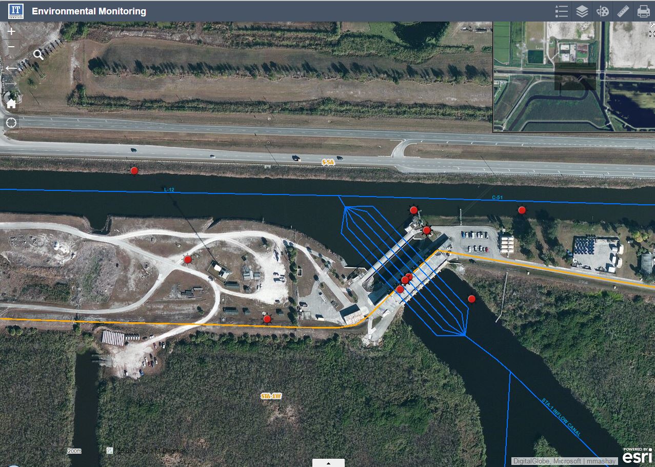

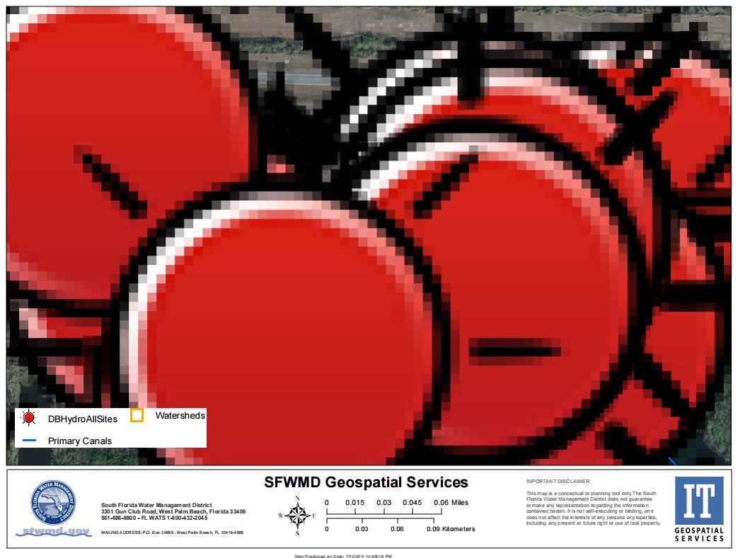

Thanks for the great tool! I am having a printing problem with the enhanced search widget. The search functionality works fine and I currently have it set to "Add Result as Operational Layer." I am searching against a point layer. Everything looks great until I use the out of the box print tool. When I do a print, the point symbols come out huge. Changing the symbol or its size has no effect. I have also tried changing all of the Advanced settings, map scale, extent, etc. with no luck.
I am using Widget Version 1.1.6 and Web AppBuilder 1.1.
Do you have any idea what the problem might be?
The first image is how it looks on the screen.
This is what the printout looks like.
Thanks!
Carlos

Carlos,
   I have not seen that before or have I had anyone else report the issue. I will have to look into this.

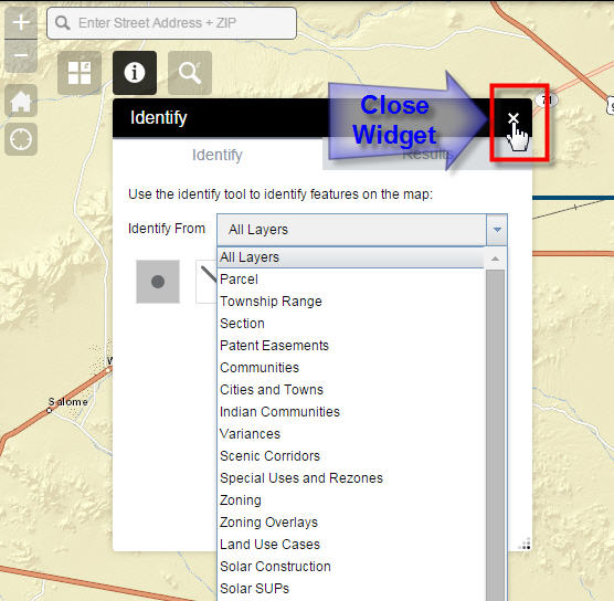

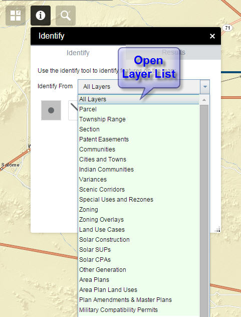

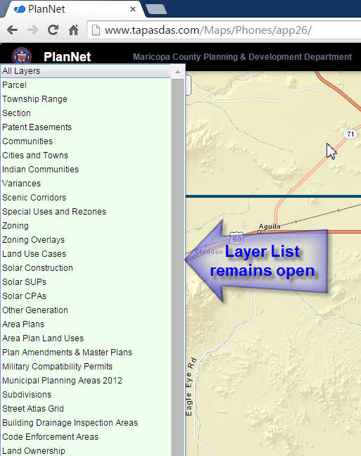

DAVIDDAS1

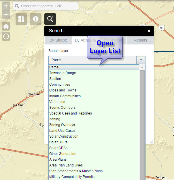

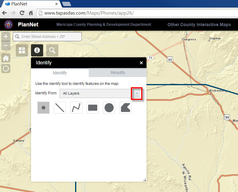

Hi Robert,
I found a minor usability issue with your Enhanced Search Widget version 1.1.8
I am using this example web app to explain this issue:
http://www.tapasdas.com/Maps/Phones/app26/
Open the Enhanced Search Widget
Open the Layer List
Close the Enhanced Search Widget without selecting a layer.
The Layer List remains open, even though the Enhanced Search Widget is now closed.
To make this orphaned Layer List go away, you would have to click anywhere on the map.
Your Identify Widget 1.1.2 exhibits the same behavior.
Open the Identify Widget
Open the Layer List
Close the Identify Widget without selecting a layer.
The Layer List remains open, even though the Identify Widget is now closed.
Thanks,
Tapas
MVP Emeritus
Tapas,
   Thanks for reporting this I will look into it and get this fixed for the next release.

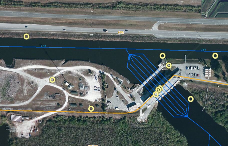

MVP Emeritus
Carlos,
  1.   Any reason you are not using 1.1.8 instead of 1.1.6?
  2. The config you provided does not have the yellow doughnut symbol for your search results, so I can not duplicate your issue so far.
Edit:
I did grab the yellow doughnut from Tapas's site json as shown below:
"picturemarkersymbol": {
      "angle": 0,
      "xoffset": 0,
      "yoffset": 0,
      "type": "esriPMS",
      "url": "http://static.arcgis.com/images/Symbols/Cartographic/esriCartographyMarker_77_Yellow.png",
      "imageData": "iVBORw0KGgoAAAANSUhEUgAAAEAAAABACAYAAACqaXHeAAAABGdBTUEAAYagMeiWXwAAAAlwSFlzAAAOwwAADsMBx2+oZAAAABl0RVh0U29mdHdhcmUAUGFpbnQuTkVUIHYzLjUuNUmK/OAAAAZrSURBVHhe7ZsNiJRFGMetRZdc8sILLzQ86pJLLrnMTEtL66qLjjrqoIOCDgoMDIyKkoqSPqioyMhISEhIMCoqSiokREQkpMIioqLgCAkJiUMiIg52mt8wcwzbu7vv+8zMscs2MLx47s7M83++//PunDn/j+QIdOsdJvTcpucOPQ/aeVI/lZ3ub2/bz23Vz4HkJ0u4Qb9e+0E9D3tCOmGLPCctaEMJzxp1aTT9sy90qXRadWx0iXrikeXqzZ2XqgOfXmXmH8dvVtOnxsw8tH+j+dsnH6w3n9u8qU8tWXxGLVBTet0X9eyKeuJIi6GhL53gXV1z1e3jS9U7e9aqv07eMiOoEzjv8+sjQ+qBLctU3/kVHwyAwLpKkc4etEyf/vY+J3jPorJ647VLxAI3AubooWvUurXdPhC4x1jQ6QO/jLlPIzwaf+rxgSBt57WKj969QvUvO9MH4kN9hnKgLIW/TkQ3h8Bff5+8KYnWG4Hy+isrVdeCuVV7ji/0k2yTfID0HjYluL21a/WsC+6D8v1X16vepfOdNRB8cclkg+hr0hrIE7Xzmm3Kz2F9q1ae5UCgtliTAgE0b4QH8W+PXtcSwjtgT50YVaMjix0If+pzRi+idiI86ei3X0ZaSnjfuu68o9d3h2j1AtFeVSqlaqtpvta1qDnWrF7oQPgshisM6kX+BgCKmpS+HGvtX3+8Uel6xGWH50JAIK0cR/iH7+9vC+H90posZVOkuFjazgLD1/a0lfAOBOoEC8AJ/SxcKPVg+qD40zfD0QFgTdcU8Txy4OroewDE4IouB8J9RV3BRH2iaizfpOPbdNd5+GfddphURscY0kD5531/7+UiK6Camo6lfbSNG1lzdM8f9L8P1kzTV7hag5o/BvgSK9gdS/tos1w+3QUj2tin9YQsyRrk7bv1POaAoKX+Z+rWICCKWkEllvZffeliX+v0D0WaFfp9AFNDGxcpKr0Qa/CsYLxZLBhlU/rukA3hBDyTv6fZpnX+nxqECK42rD87yBJeeGaFOw+cY8Nhgt+zT14kBgAWpzxvxuzFOdieslc/g2sRukarEABtOAhO4rSEqXr0VVAV5p1yHW7JueAMpZbpZZ+63SLR36Qp6SYQmhZpCIqYnN1jrIsvS89GCrZnY63Mga+q28bOFW0Cy+sxNBuamVrB/6eSM/GAqC4BYe/uy3zlZG6PyaqXnx8UbeCVnuT3FINqzgRECQA0Sc3igMn/ICXZYOSGc9wGEymk12uSRk2BJkmLVJcWAOJJ5qB/Vvs/vrIwABQr8AV2A/qIVIPYIm7N9RkdCBRd/xnmYkNCenhpBmIy5TBu+uhDFxZWElbtZahM8tQEGQnlRUdntf95Sun12veyDxFd4qYeW5SZCk2uldTeXoSl5E05KKwUd40SALw4NZJ1SDEA3A9YC2hrAMQuQIVmAYhCRDYwIVOrpHIBcRDk4tIC8F1K+9dr004nC4LiNEhetiQkbkRLnWqYM0qv5Lw0mNmaBxVCXoQdTiQ9vQW3PqJMlacQCiqFoc6tGwBkijHE+lyNSzJAnlI4qBmC+/PcIMUtLT2GuFfJ0wwFt8Pe3VzsdEjeNt2mpA/AYvK0w5htECGCFURkg5wb0VuYV+p4C0Vi/nwnDyHChsGUmNcWc+h6DHDeGAEPQHlteEpJlYrwNZRYQ6ImCikKnW0DIiCsyittzedIp0b47oXzqgQxqfaLkKJRaHE05YFA6oLmLkKRwSgdQ3heyECDUuFrrsjG8yjD1AMxrsW2bL7Ap8cn9bqwOjC9WQNz54D7rPWogeULVIjmEb7oxQgHi3o1RquMIE4o+0S7pDV/miKHWZlfqmK2Up/3rUVyNQYIu2JZAYdBEMpXCFevHK0FxQQ6OEkJJ5HlIhLtO9Mk9SS7Hsen/etxbo5DfLzed6XadyBsxwo69QUJQKBjCr6WSqHZZmtiUTFekQGEQVwBS+jEl6ScK3Bn37GvyTkQTIncqS9KAgJFymFA6NRXZQGB2xQDQgu/LD2lz1f3+tuZc8gTS6DX78jX5X3gtgECs0V+MAGjnUl0hmi72Xcn9Ac69iczDhwap5nubZZ/NEWRxlVZSwwYW9O/myDZQT+bq0Uft+CKfKbTS/DDyVn3dYmJwQXCApm0GTAhUXboiYW17UBjWAaZA2EcCWKYXjvd396zn9uqn9F/99O2CKY8+L9SiYnS6UxmCQAAAABJRU5ErkJggg==",
      "contentType": "image/png",
      "width": 20.00025,
      "height": 20.00025
But Even using that I can not get the results you posted when printing with the otb print widget.
CarlosPiccirillo
Robert,
I’ve only been working with Web AppBuilder for two months. I’ve been programming since 1991 (Arc/Info aml, ArcView Avenue, VBA and C#) but Web AppBuilder and Javascript is a whole new world so I have a BIG learning curve ahead of me.
The only reason I am using the older version is because that is what I started with and didn’t realize there was a newer version. I will update the widget, try again and let you know what happens.
I was using the same symbol as Tapas, marker 77 yellow but from my tests, the symbol does not matter, I tried four different symbols and had the same issue. As far as I can tell, the issue is limited to just points, Lines and polygons display correctly on the printout.
Carlos
MVP Emeritus
Carlos,
   This is strange as here is a pdf output that uses the same symbol as Tapas for points and there is not issue.
http://gis.calhouncounty.org/WAB/V1.1.1/_ags_9400a43fe8174b31804605fb9c822f59.pdf
CarlosPiccirillo
Robert,
Do you know if Tapas’ output matches what he sees on the screen? The symbols look pretty big to me on his pdf, granted not as big as they are on mine. Maybe Tapas was zoomed out more than I was. I was zoomed in pretty close.

Updated the widget to 1.1.8 and changed the symbol as well but the problem still persists.
Here’s screen capture after search.
Here’s printed pdf.
MVP Emeritus
Carlos,
   Please start a new thread on this issue so that you can attach things (comments on the document do not allow for attachments or the use of the advanced editor).
