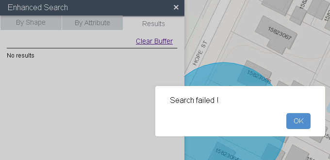

Hi Robert Scheitlin, GISP,
The search using a buffer does not seem to work when using the enhanced search widget. Everything else does. Can you give me some clues why? Please see attached.

Thanks Tapas. I tried the above and per your document (which is great btw!) but still no luck...I'm sure I am missing something.
