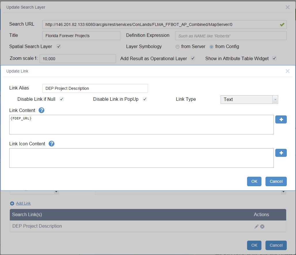

We have a weblink field and we’d like to have the text be formatted as a hyperlink, as “clickable”<http://apps.sos.ky.gov/land/cities/citydetail.asp?id=1&city=ADAIRVILLE&idctr=1> text.
Like it is in the results for the Attributes Table view
RobertScheitlin__GISP
MVP Emeritus
Robert,
   If you look at my live preview site the Louisville Traffic Cameras layer has cameras image links as a field and the Attribute Table Widget displays the url as a hyperlink.
eSearch Widget Live Preview Link
RobertJenkins3
Deactivated User
Robert,
Right, but the question is, can we have that hyperlink in the Widget result window too.
We don’t necessary want the Attribute Table shown all the time.
AmyKnight
Robert J, yes you can do that and Robert S has done it in his preview too, only he is using an icon as the link.  We use the link function similar to the way you describe.  It sounds like you want to use text so under the Search Links you just select the Link Type as Text.  Give it an alias, and enter the hyperlink field in the Link content.  It works great.
RobertJenkins3
Deactivated User
I thought I had looked at all of this. I’ll take a look at it again and make sure I’m not missing something!
Thanks everybody!

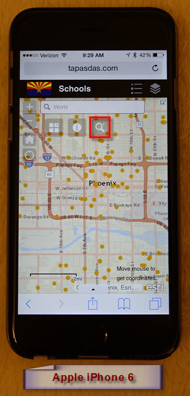

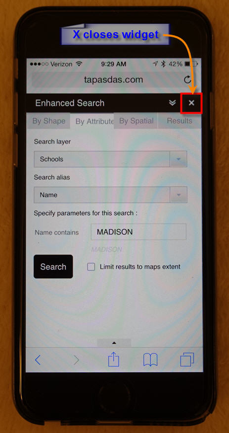

First, let's test the behavior of the Enhanced Search Widget on an Apple iPhone 6 where it rocks!!
When I open the Enhanced Search Widget, I get the By Attribute Pane which fills up the whole screen. Wonderful!
I can tap the X icon which closes the widget.
I can tap the Search button which returns my results.
The Results Pane displays my Search Results.
I can tap on the down arrow to go back to the main Map.
If I want to close this In-Panel Widget, I have two choices.
I can tap on the eSearch icon.
or,
I can tap the X button on the bottom bar.
Both work as expected on an iPhone 6.
This is perfect.

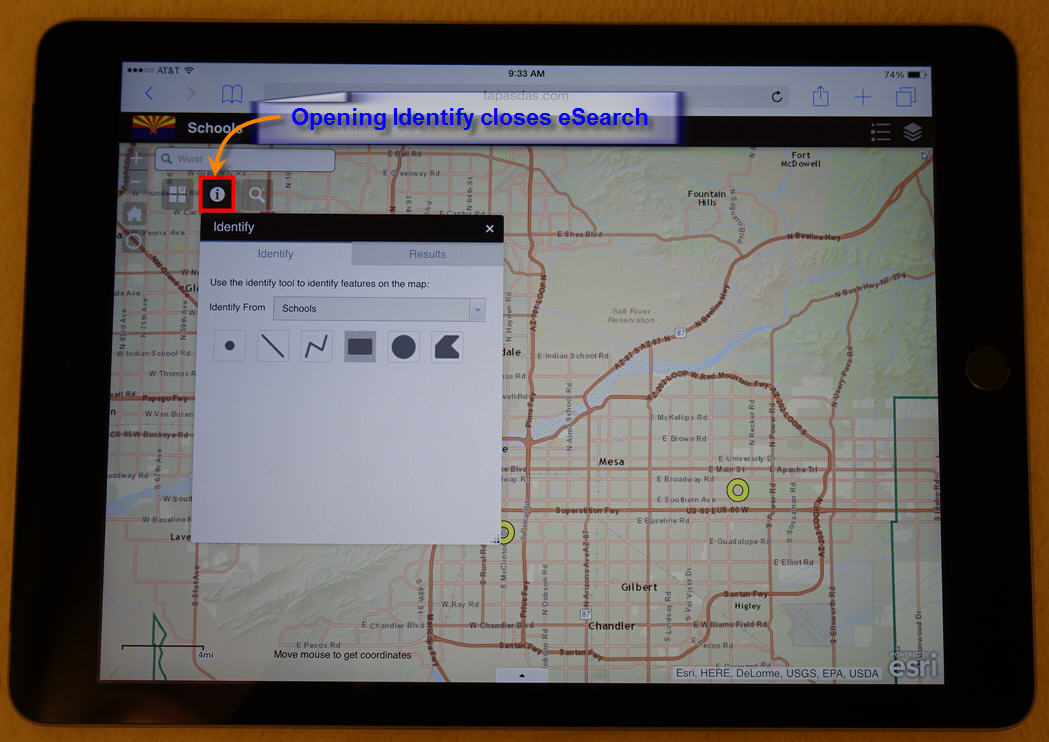

Now let's repeat this process on an Apple iPad Air 2
Open the Enhanced Search Widget
Tap Search
The results pane displays the results.
I can tap on the header and drag the results pane to a different location.
However, I cannot close this pane by tapping the X button on the header!
The only way I can close this In-Panel widget is to open another In-Panel widget.
In this example, when I open your Identify Widget, it closes the Enhanced Search Widget.
Now I am stuck with the Identify Widget. I cannot close it.
I can open your Enhanced Basemap Gallery to close the Identify Widget.
Can the Life Cycle of In-Panel Widgets be modified to fix this issue on Tablets?

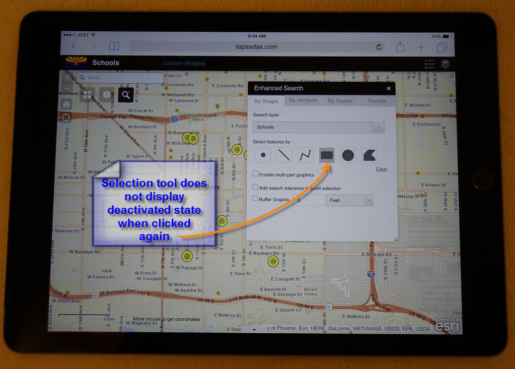

Here is another usability issue I am facing. When I activate a Selection Tool by tapping it once, it turns gray. This is perfect.
However, when I tap it the second time, it still remains gray.
Unless the gray background is toggled back to white, I have not visual clue as to what state this is in.

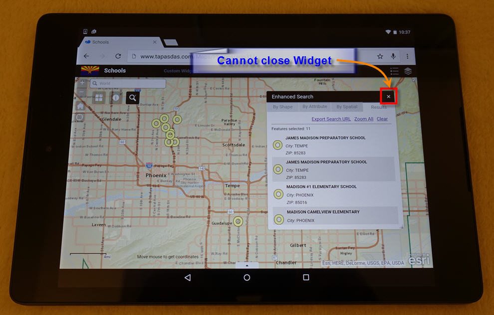

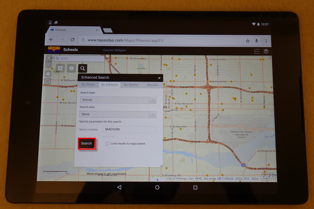

Let's try the same steps on a Google Nexus 9 Tablet.
Open the Enhanced Search Widget and tap Search on the By Attribute Pane.
Here again, I cannot close the Results Pane. I can move the widget, but I cannot tap X on the header to close the widget.
Just like on the iPad Air 2, the Search Tool does not display the deactivated state when I tap on it again.
I can chose a different tool, which deactivates the previous one.
But now, I cannot deactivate this new tool.
Visually, it keeps showing the gray background, although in practice, the tool is really deactivated.

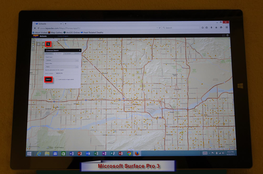

Finally, let's run these steps on a Microsoft Surface Pro 3 which is a hybrid device.
I am using Firefox version 37.
I can tap the X icon on the screen and it closes the Enhanced Search Widget as expected.
Works perfectly!
Once an In-Panel Widget is closed, it is grayed out, showing that it is closed.
There are no issues closing a Widget on the Microsoft Surface Pro 3.

1. There is a built in minimize for all the widgets in the Header controller bar. So if you add the widget to the to bar where you have your layer list you will get an option to minimize the widget. It looks like two down chevrons.
2. One way to work around the widget not closing is to select the widget icon again.
3. Why would you want to use the search by shape tab and use no shape?
-Stan

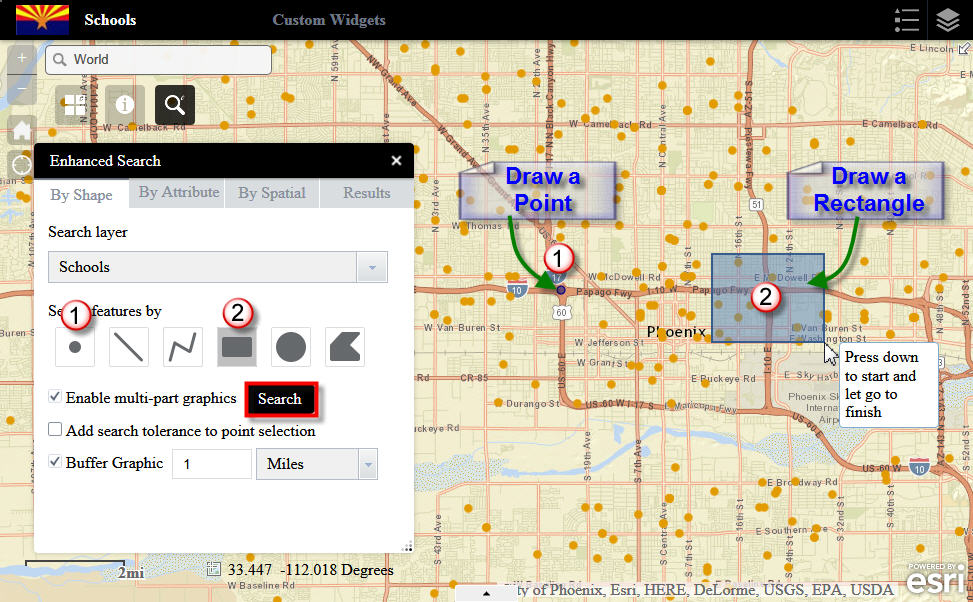

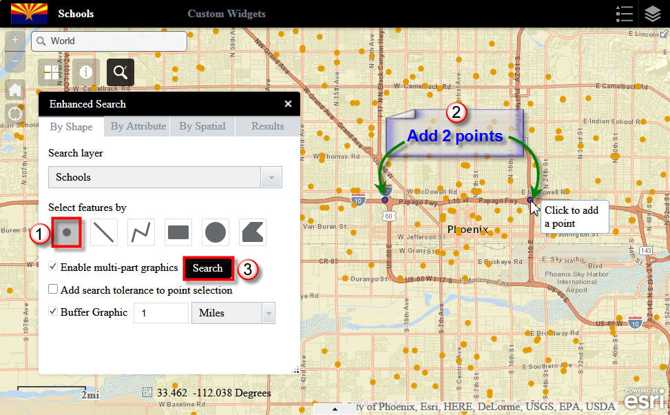

Your Multi-part graphics option is an excellent feature where one can define more that one graphical selection area before hitting the Search button.
Further, one can set a buffer distance to buffer these selection graphics prior to running the Search operation.
Could you tweak this a little bit to make it possible to mix and match the selection tools within one session?
To illustrate what I am trying to do, let's examine 6 test cases:
http://www.tapasdas.com/Maps/Phones/app31
In the By Shape Pane, I am enabling multi-part graphics.
I am setting the buffer distance to 1 mile.
Case-1:
I am adding 2 points on the map
When I press Search, a 1-mile buffer is drawn around these two points, and all the Schools within these buffer zones are returned.
The is perfect.
Case-2:
I am adding a Line on the map.
Next, I am adding a PolyLine on the map
When I press Search, I get a 1-mile buffer around the Line and PolyLine, and it finds all the Schools within these buffers.
Perfect!
Case-3:
I am adding a Rectangle, a Circle, and a Polygon on the map.
When I press Search, it draws the buffer around these shapes and returns the Schools.
Marvelous!!
I am amazed that your tool can handle this.

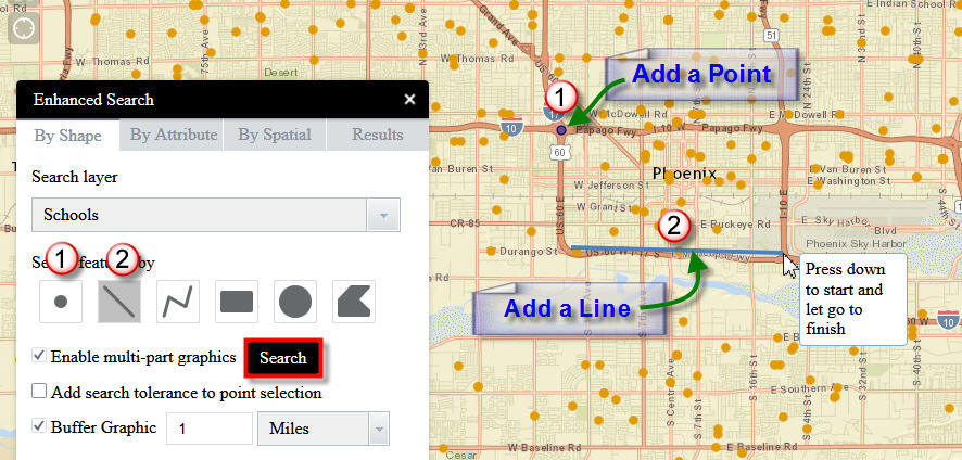

Case-4:
I am adding a Point followed by a Line
When I press Search, nothing happens.
I have to restart the application.

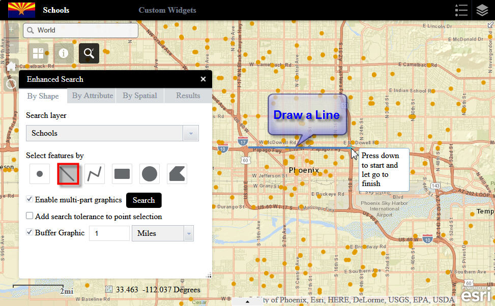

Case-5:
I am adding a Line followed by a Rectangle.
When I press Search, nothing happens again.
Case-6:
I am adding a Point followed by a Rectangle.
Will it be possible to enhance this Widget so that users can freely mix and match selection tools during a multi-part graphics session?
Thanks,
Tapas
MVP Emeritus
Tapas,
   I am not sure that it will be possible from me to allow mixed geometry types, but I will look into it.

DAVIDDAS1
Thanks Robert!
Your multi-part graphics selection feature using a mix of selection tools already does a lot more than your Flex version.
In the Flex version, I could only use a single selection tool during a multi-part graphics session.
In this WAB version, I was surprised to find that you could start with the Rectangle Tool, then switch to the Circle Tool, and then use the Polygon Tool, and each geometry was recognized in the final selection set.
Your Enhanced Search Widget along with its companion Identify Widget are the two most essential and valuable Widgets in any Web Application. After the brilliant work you have done on the Flex version, all our users now naturally expect to find the same implementation on the JavaScript apps.
I never thought I would ever see all the Flex functionality carried over to the Web AppBuilder. You are making the impossible possible!
Tapas
MVP Emeritus
Tapas,
   The ability in the WAB version to draw two different geometry types is likely an over-site in my programming as right now I can not figure how to actually perform the query with two different geometry types or if that is even going to be a possibility. In the Flex version I probably knew that I couldn't do that and put code in place to prevent selecting a different geometry type.

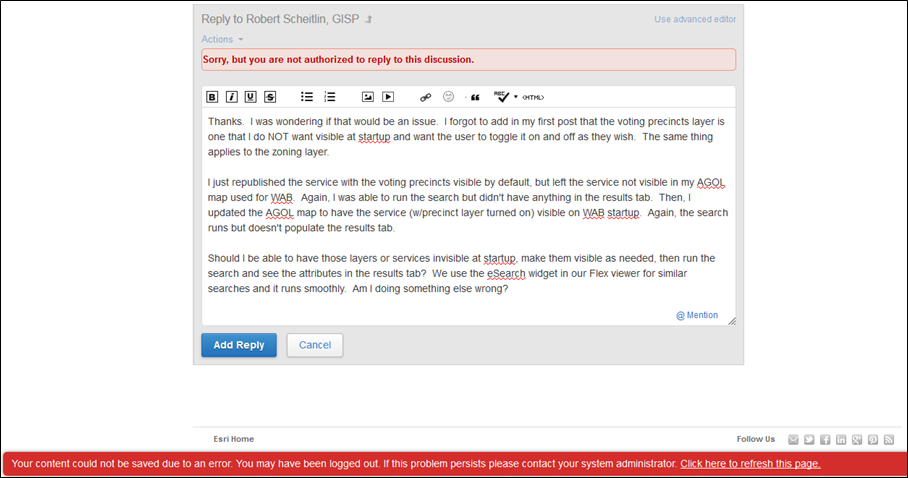

AdamGebhart
Robert,
I added a discussion with the title "Search results (attributes & shapes) not visible in Enhanced Search Widget - WAB."
Thanks again.
MVP Emeritus
Adam,
   Yep, already answered.
AdamGebhart
Thanks, Robert.  I'm trying to reply to you in that discussion but I get the following error message.  I've logged out of geonet, cleared my cache and even tried in a new browser and get the message each time I try to reply.
