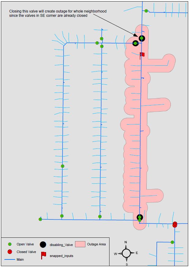

I am trying to get a more complete outage area polygon and summary data (count of services effected etc).  The neighborhood depicted in the attached image is fed from only one direction due to some closed pressure boundary valves at the SE corner.
isolation trace outage area
MikeMillerGIS
Esri Frequent Contributor
You can set the trace up to load barriers for closed valves. Take a look at the system_barriers parameter. Are you using this?
https://solutions.arcgis.com/water/help/water-outage/tool-reference/generate-web-isolation-trace-toolbox.htm
GregHorch
Thank Michael. Properly setting up the system barriers and evaluating paths to controllers did the trick.  This did come with a tremendous performance hit in a large network (80K valves, 1500 closed valves, 150K mains, 620K service lines) on SQL server database.  Performance is much better in a fgdb stored on the ArcServer box with isolation traces through WAB taking just under 4 minutes.  Does this sound about right?
