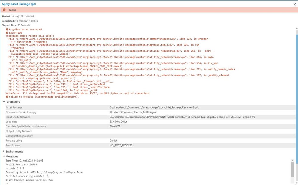

Hi all. I have recently tried to apply an asset package to a newly created UNM. In the asset package I have created a rename table (Danish), but after having translated a lot of the desired fields to be renamed, I get the "must be Unicode or xml" error. I have done quite a few iterations of adding more and more translations in the rename table, in order to figure out where I might be adding some unwanted characters. There seem to be no clear indication of where the error arises, except some information about what python line has the error, but I'm a bit hesitant of diving into the different scripts.
I don't know if I might be renaming something that is "system" dependent or what is happening.

OK, I think I found the issue and also discovered that while Excel to Table does import the table, it doesn't get the field types, bypass field domain, or Text field lengths (255 instead of the necessary 1000).
I found this character, before the T in Trapez, when looking at the translated field in Excel, I didn't see it in Pro:
Try finding and removing the invalid character in Excel, and copying and pasting "Trapez" into Pro in the same places in your D_Rename table.
Excel is a more user friendly place to make the adjustments but the import process loses some info along the way. An import to table, join with rename, then field calculation may work as long as your object IDs are the same between the two tables.
I hope that helps!
Joel
I hope that helps!
Joel

Hi Joel. The weird sign in the "Trapez" (The same flaw was found both places I had made the translation). Now I'm to have a go at importing the table, and perhaps do as you suggested with join and such. As it is now, the imported table from excel seems to loose the field info (as you described). I am putting together a UNM with several different disciplines, and as a drainage engineer my translation skills will be lacking on the electric field. Having more knowledgeable discipline specific people doing the translation in "familiar" spreadsheet would be a giant plus.
