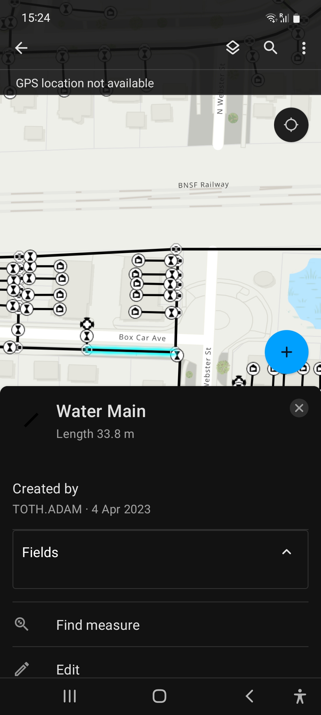

I'm working with sample data from ArcGIS Solutions: Water Distribution Utility Network (UN) in Naperville, IL. I published UN as a feature service in AGE and I want to trace it in the FieldMaps app. I followed the instructions here, so I created a webmap in AGE with my published UN service, opened it in ArcGIS Pro, created some named trace configurations, saved it in my webmap.

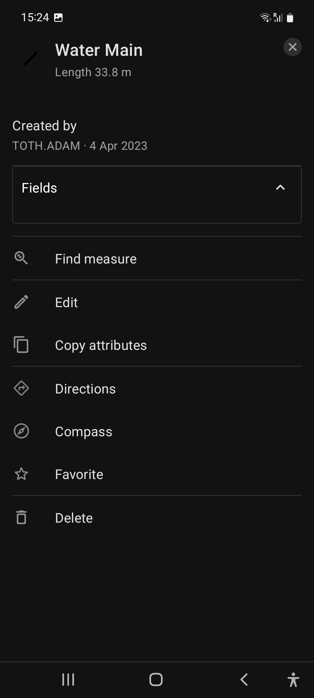

I tested it in the trace widget in ArcGIS API for JavaScript and all of my trace configurations were there and tracing the network perfectly. Then I opened the same webmap in the FieldMaps app and when I tapped terminal, point or line within the network, no trace configurations were shown. I'm enclosing screenshots of my FieldMaps app with tapped line of UN and all of the options which were shown.
