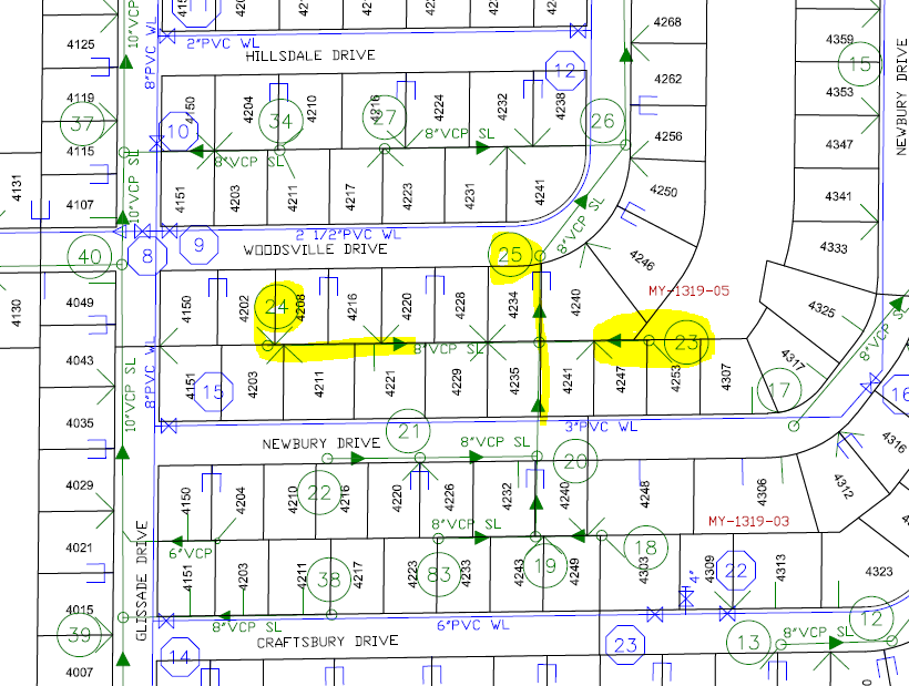

I have many Manholes (points) data from a county Utilities CAD maps. I need to create Gravity Main lines using these Manhole points. The gravity main feature should include the attribute fields 'FromManhole' and 'ToManhole' which should be based on the direction of flow. I can also generate the Gravity main line from CAD maps but the problem is how do i get the mentioned attribute info without doing extensive manual entry. Is there any software or tool that automate this task or read the Flow direction 'arrow' (which is in CAD file) symbol???   Thank you so much.

Yes, I am converting data from Utilities CAD maps to GIS data for all over the county and for almost all utilities (Water/Sewer) data. I also have manhole points and want to create Gravity lines based of on Manhole points and Flow Directions. I have two choices
1. Either I have to generate lines using manhole data or
2. Get the Gravity Main lines from CAD, use manhole points layer, and populate the attribute fields 'FromManhole' and 'ToManhole'
In both cases these two fields should be populated based on directions of flow; and the flow directions info could only be get from the CAD maps or digitized direction. If there is  the better way to work on 1st method would be great but I do not know how..So I thought the 2nd method would be easy but could not exactly figure out how to get these fields populated easily. I have recently installed the Water Geometric Network Editing and Analysis tool  but still not sure how to work with it.
