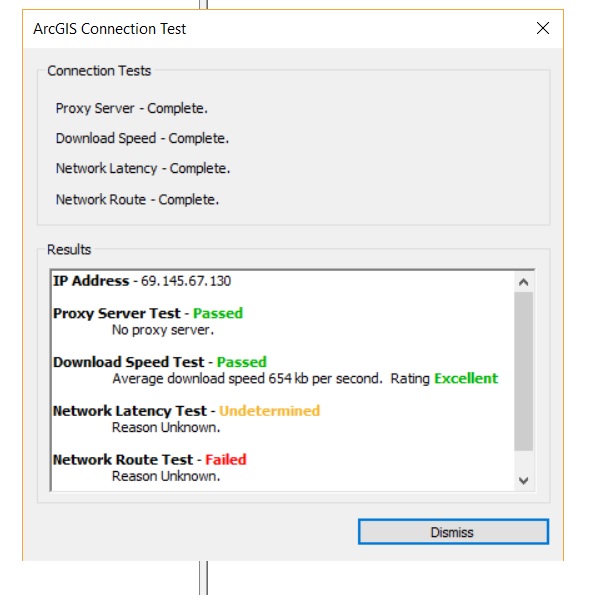

All scripts appear to run correctly.  However, next issue (don't know if related or not) is I can neither add an ESRI Basemap to a new *.mxd, nor can I add or change an existing one in an older *.mxd that already has one.  Any ideas?
JayantaPoddar
MVP Alum
Is the Add Basemap option grayed out?
Then you could check the globe icon is crossed in Windows Taskbar.
Right-click the globe icon > Test Connection now.

JackieFisher
I'm signed in to the AGOL, as soon as it processes for just a few seconds, then kicks me out.  Here is the screen from the Connection Test.
