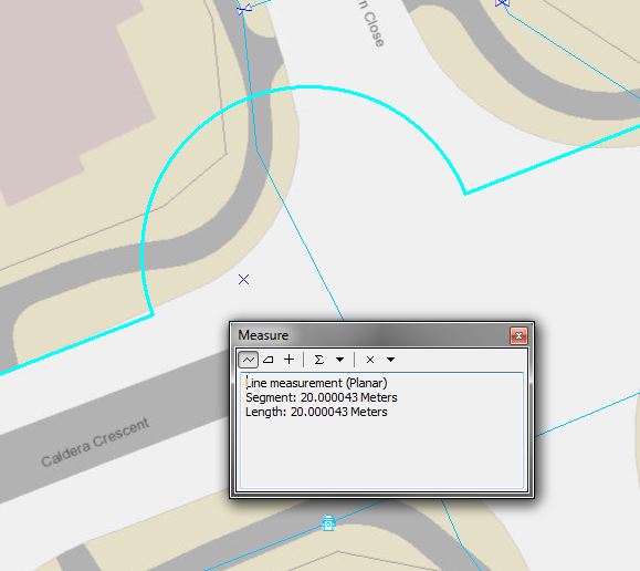

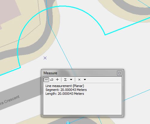

We've been using the Water Utility Network Tools (and various names and versions) for several years and find it very useful.  Over the years we've had some successes and some issues with the Create Jumps tool.  We would like the tool to create jumps with a radius of either 0.5m or 1m, however in the current tool I can't get it to create one with a radius lower than 2m.  If we try with anything lower, or anything with a decimal, we get a radius of about 7 metres (which is kind of huge).
I reported this issue a few years ago, and at that time it was fixed and had worked fairly well, but recently this has stopped working again and we're getting massive jumps.  Is there any way we can get the Create Jumps tool to let me use 0.5m or 1.0m as a radius again?

It does appear to be the decimal causing the problem.  If I set jumps to 0.5m it gives me a 10m radius!
If I set it to 1.0m I get the same result
However if I use just 1m (not 1.0m) it gives me the expected jump
