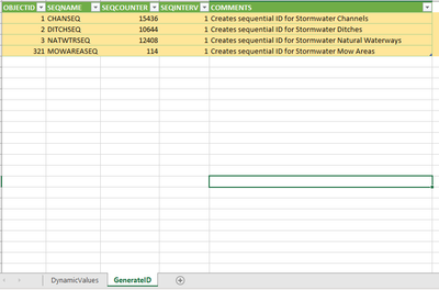

I was previously a heavy user of Attribute Assistant, but have since moved to ArcPro and Attribute Rules.
I used sequential IDs for a handful of feature classes. This was achieved by creating a seperate "GenerateID" table.
Ours looked like this:
