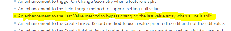

JimGrimes
Where in the AA config file can I find this enhancement from Jan 2018 in the latest ver 2019.2.14?

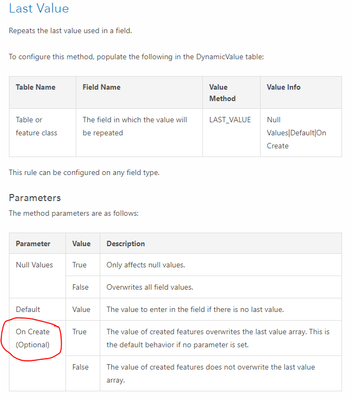

JimGrimes
Ok. So i've learned that the enhancement was an added as an option to the Value Info for Last Value method in the Dynamic Value table.  Just not sure how to configure that Value Info field for our circumstances.
