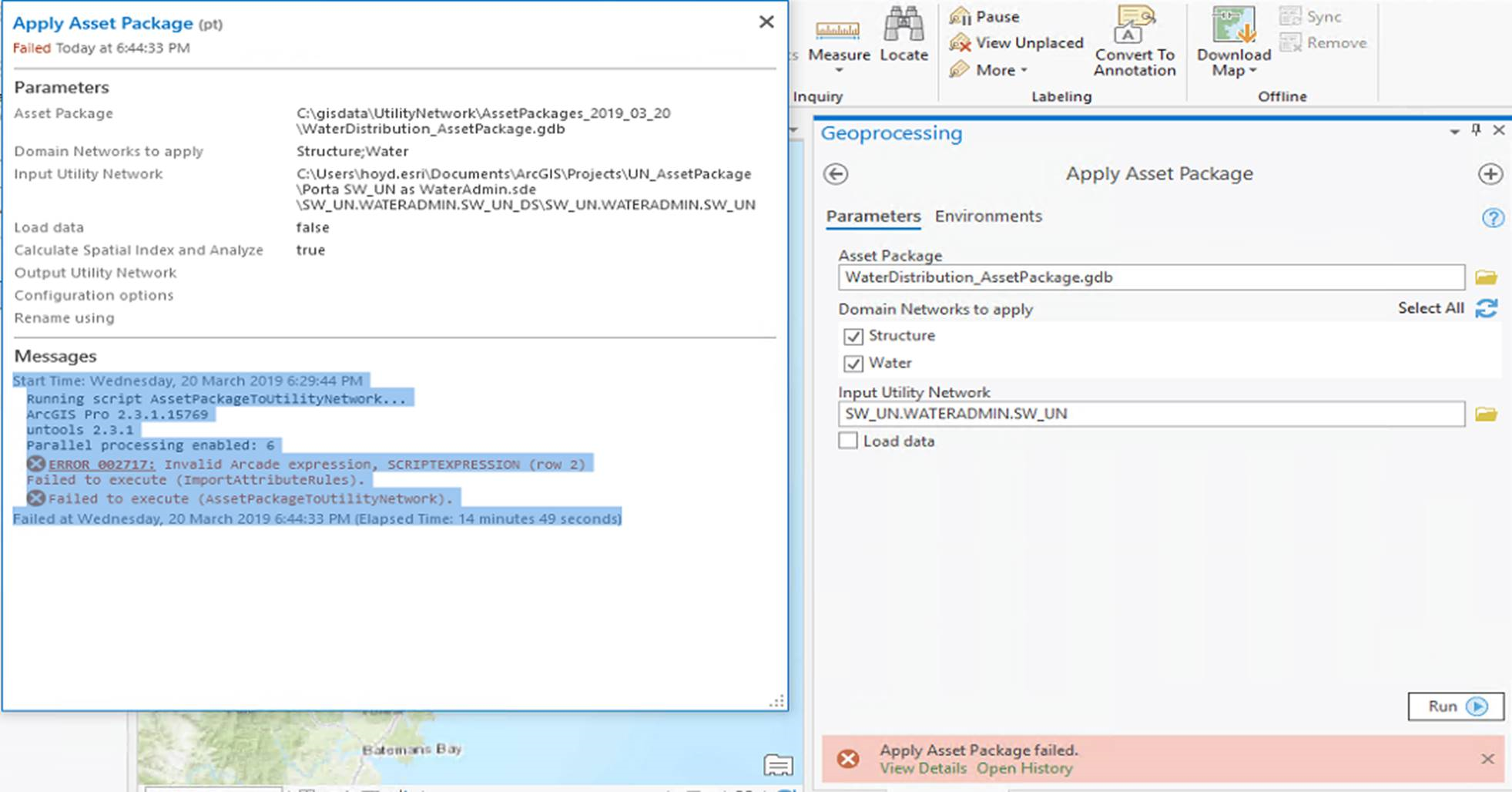

Attempted to apply the most current WaterDistribution_AssetPackage.gdb
to a newly staged v10.6.1 Enterprise GeoDB using UNTools 2.3.1 in ArcGIS Pro 2.3 SP1
Error after 14 minutes
Start Time: Wednesday, 20 March 2019 6:29:44 PM
Running script AssetPackageToUtilityNetwork...
ArcGIS Pro 2.3.1.15769
untools 2.3.1
Parallel processing enabled: 6
ERROR 002717: Invalid Arcade expression, SCRIPTEXPRESSION (row 2)Failed to execute (ImportAttributeRules).
Failed to execute (AssetPackageToUtilityNetwork).
Failed at Wednesday, 20 March 2019 6:44:33 PM (Elapsed Time: 14 minutes 49 seconds)
I feature classes and tables have been successfully created in the database.
Seems that just step 6 of 6 failed - the ImportAttributeRules step.
Any ideas?
 screenshot of error dialog

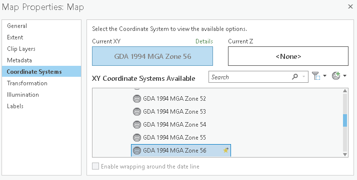

We are using Australian Projected Coordinate System GDA 1994 MGA Zone 56
