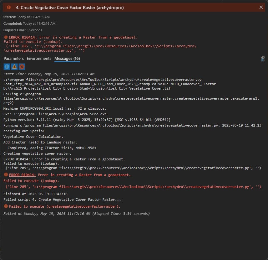

I'm running into a reoccurring issue with the Create Vegetative Cover Raster tool. Every time I have tried to run it, I receive a 010414 error message stating that a raster could not be created from a geodataset.

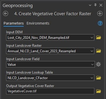

I noticed that recently, some videos demonstrating the Arc Hydro Erosion Toolset have been uploaded:
https://mediaspace.esri.com/media/t/1_08znoxom
In the video for the Create Vegetative Cover Raster tool, it shows the tool as requiring only four parameters, yet I'm required to provide five. I don't know if the new parameter would be leading to the error I'm having.

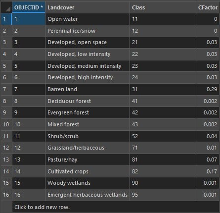

I'm currently using ArcGIS Pro 3.5 with the Arc Hydro Tools for 3.4 (I jumped the gun and updated before checking to see if a new version of Arc Hydro Tools had been released; hopefully, this isn't causing any issues). I also included a screenshot of my C-Factor table in case that would be of any help.

Hi Dan,
I think the issue I was having was the DEM and the raster were not of the same dimensions. When I clipped the landcover raster to the DEM, it tool seemed to have completed successfully.

so error messages has a suggestion. Can you compare the output workspace recommendation to what you have specified.
010414: Error in creating a Raster from a geodataset.—ArcGIS Pro | Documentation
Solution
Check that the input is a valid dataset.
Try setting the output workspace to be a file folder on your local disk.
Hi Dan,
I've been working on a local drive, no cloud-based storage. I've even tried saving the raster in the base directory of the drive I'm working off of with no success.
I also noticed that a CFactor column does get added to the attribute table of my landcover raster, but no C-Factor values get copied to it.
