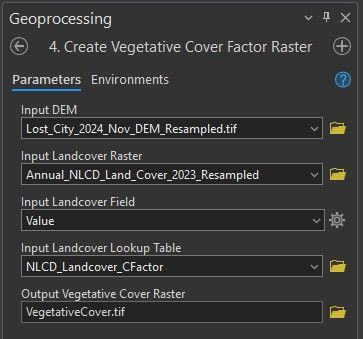

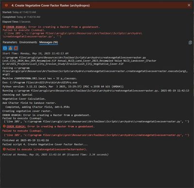

Hello,
I'm running into a reoccurring issue with the Create Vegetative Cover Raster tool. Every time I have tried to run it, I receive a 010414 error message stating that a raster could not be created from a geodataset.

In the video for the Create Vegetative Cover Raster tool, it shows the tool as requiring only four parameters, yet I'm required to provide five. I don't know if the new parameter would be leading to the error I'm having.

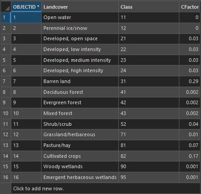

I'm currently using ArcGIS Pro 3.5 with the Arc Hydro Tools for 3.4 (I jumped the gun and updated before checking to see if a new version of Arc Hydro Tools had been released; hopefully, this isn't causing any issues). I also included a screenshot of my C-Factor table in case that would be of any help.

Eric_Chameroy
Hi Dan,
I think the issue I was having was the DEM and the raster were not of the same dimensions. When I clipped the landcover raster to the DEM, it tool seemed to have completed successfully.
Thank you for your help.
Eric

I also noticed that a CFactor column does get added to the attribute table of my landcover raster, but no C-Factor values get copied to it.
Eric
