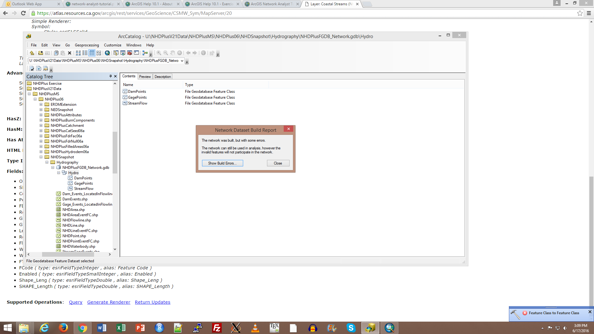

Hi Bill, did you see my last comment? I tried to build network dataset, however, I encounter an error: "Network was build, but with some errors. The network can still be used in analysis, however the invalid features will not participate in the network", when I opened the "show build errors", I found that all my dam and gage points are listed there, so those points weren't able to participate in the network. Did you encounter this problem before?
