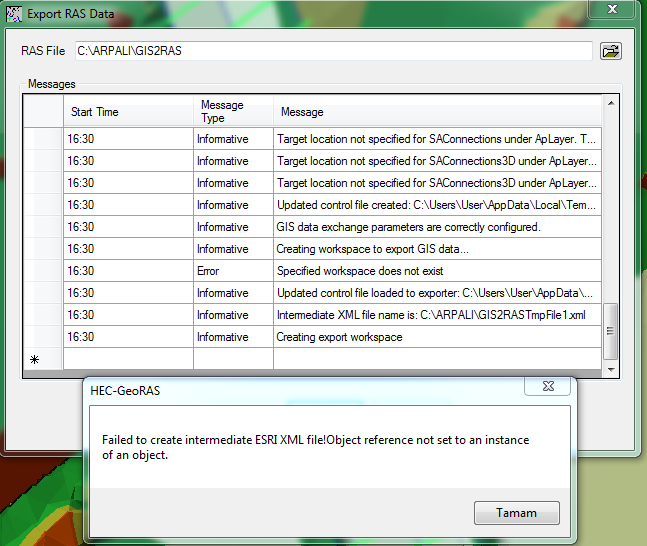

i have the same problem with arcgis10.3 and two years ago again the same problem with arcgis10. i cant solve this. i tried all advices in here but the same error again and again. i am using student licence with full extensions. cracked arcgis9.3 still can solve without any problem why arcgis10 and 10.3 always give the same error. Also when i did my first export, it was worked. there was no problem but for the second project it failed. Anyway i give an ss below. if there is anyone who can solve the problem please help me i dont want to use again cracked arcgis 9.3
