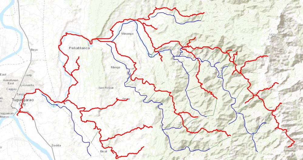

Hi, I am wondering if anyone can help me on my data run. I've been running my DEM using Arc Hydro, drainage line output do not match the DEM or the base map stream.
What could be the problem? Is there any step that I need to do?
The red line is my stream from delineated DEM, the blue line is the basemap from ArcGIS software.

Check the projections on your source data as well as your data frame. They must be the same.
Michiekoy
I already checked and they have the same projection. I also tried to do georeference on DEM but still the same output.

I took a screen snip of your map and drew blue lines where the ESRI topo would show the streams. Freehanded these, so not that pretty. Then I drew fainter green lines from your red lines to my blue lines where they visually seem to match in shape.
It looks like your red lines are offset almost like someone stretched the image of the redlines to the east (or compressed the topo in the East-West direction).
What does it look like overlaid on your DEM? Can you provide a view with the red lines overlaid on the DEM where the DEM has a high contrasting color ramp? Does the ESRI topo line up with your DEM?

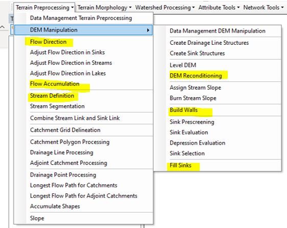

To can train the DEM to follow an actual creek or river, or to make it flow correctly "through" a road embankment at a road crossing, you need to "burn in the streams". The process to follow is to draw lines in a dataset called "agreestream" where ever you need to force a stream to be. This line should start and end on DEM cells that are correct to make sure there is good "continuity" between where the DEM gives you right answers and where you need to correct it. You don't have to put in lines for every stream in the DEM. You only need agreestream lines where the DEM is not "hydrologically correct". You can't always see this so it is a trial and error process.
Then you run the DEM Reconditioning with the agreestream dataset which lowers the DEM elevation where the streams need to be. Then build walls if needed. Building wall works the same as burning streams using a dataset named "innerwalls", but it results in a DEM where the cells are raised to stop flows from going where they shouldn't. Then fill sinks. Don't worry if the streams are burned really deep (-1000) or walls high (+500). The fill sinks will raise the DEM enough. The walls will still be high, but in the end you are not needing the right elevation, you are needing the right flow direction. You would always use the original DEM for elevations any way. The final agreeDEM will be "hydrologically correct".
After you fill the sinks the DEM should be "hydrologically correct" and the flow direction>flow accumulation and later steps should result in what you want. If not, add/adjust agreestream lines or innerwalls and repeat.
The highlighted steps in this screen capture of the ArcHydro menu shows the steps I use up to Stream Definition. I'm not sure if you are going beyond that.
