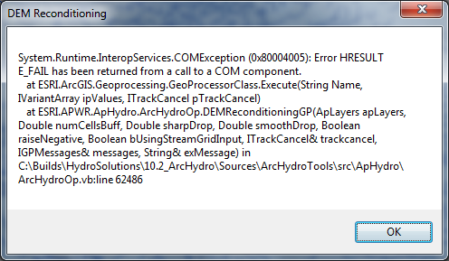

I am facing a problem using the arc hydro tools 10.2 fonctionnality "DEM Reconditioning" and you can check the error message in the image attached and i have no idea what i should do, so would please land me a hand.

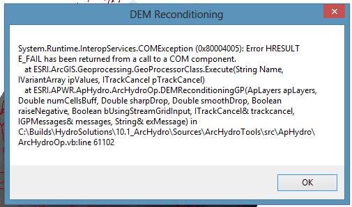

i tried all the solutions proposed but im stoll getting the following error:error.png
im working with windows 8 and arcmap 10.1 any new solutions?

Mark: I get the following error (see attached). I have made sure the target locations are set correctly as you have described. My files are on local drive, and I have also gone through the "Arc Hydro Problem Solvers" thread.
Can you kindly guide me in solving this error.

Did you solve this issue, Mallya? I faced the same problem, while I am sure that the target database is correct, temp files are cleared.
