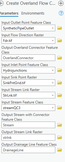

I am following the procedure the Stormwater Processing Procedure and have reached page 45 - Create Overland Flow Connectors. There are supposed to be a few feature classes and rasters created as an output but nothing is being created. Below is a photo of how I filled out the tool and what should be created as an output.

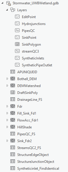

Here is what is in my database after running the tool.
The tool runs and I get a warning message ['line 251', 'c:\\program files\\arcgis\\pro\\Resources\\ArcToolbox\\Scripts\\ArcHydro\\createoverlandflowconnectors.py', 'KeyError: -1'] but otherwise runs through completion. I don't know how to check what this warning message means.

Is there a chance you get upgrade to a later version of Pro? There have been some changes in the underlying functions and things are working a little differently in 3.0 vs. 3.1 and later.
