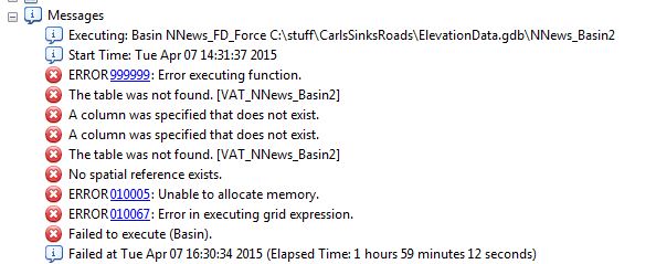

Unfortunately no, it crashes after a couple of hours when I run the Basins tool.  Not sure why, I put in a call to Tech Support about it.  Here are the error messages...any ideas?

Ugh, that sucks. It looks like your machine is running out of memory. Is it a very large geographic area? Sometimes it helps to split it up into smaller areas. Here are some other tips:

Thanks Sephe, that’s what I thought at first but I don’t think memory should be an issue. I have 32 GB RAM and it’s just an average-size county. It is fairly flat so all I can think is maybe it’s trying to assign lots of cells to lots of really really small basins. I’ll post if I find out anything from the tech support.
