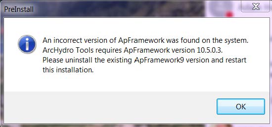

I am trying to install ArcHydro Tools for ArcGIS 10.5. I have downloaded the installation files, but when I try to install them it says that I need to uninstall the existing ApFramework9 version and restart the installation. I have already uninstalled ApFramework9, so I do not understand why this is being prompted. I have already uninstalled a previous version (10.2) of ArcHydro Tools as well.
I have tried locating ApFramework version 10.5.0.3 but have not been successful. I would appreciate any assistance

It looks like your registry may still reference an older installation. Look for the following keys and delete them as needed:
SOFTWARE\ESRI\Applications\WaterUtilities\ApFramework\Install
or
SOFTWARE\ WOW6432Node\ESRI\Applications\WaterUtilities\ApFramework\Install
