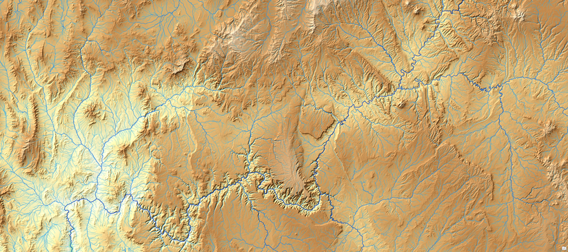

The delineation and analysis of stream networks within a Geographic Information System (GIS) environment is a foundational task in hydrologic and terrain analysis. These networks serve as a spatial framework for modeling water flow, watershed boundaries, and surface‑hydrology processes. While creating stream networks can be computationally intensive and methodologically complex, the benefits they provide to spatial analysis and environmental modeling are substantial.
In typical GIS workflows, stream networks are derived from Digital Elevation Models (DEMs) through a sequence of hydrologic‑processing steps: depression filling, flow‑direction modeling, flow accumulation, and stream thresholding. Among these, defining the stream‑initiation threshold, the minimum contributing area required for a channel to be considered a stream, is particularly challenging and highly context‑dependent.
Many users ask for the “perfect” threshold for their area of interest, but no universal value applies across all landscapes. The appropriate threshold varies with regional precipitation patterns, soil permeability, vegetation cover, topographic relief, and underlying geology. For example, in arid or semi‑arid environments, surface runoff is less frequent and tends to concentrate in fewer, more episodic channels, necessitating a higher flow‑accumulation threshold to define meaningful stream features. Conversely, in humid or low‑relief regions, shallow overland flow may form continuous drainage paths with relatively low contributing areas, requiring a lower threshold for accurate representation.
Our approach to stream delineation is grounded in methodology developed by the U.S. Geological Survey (USGS) to provide a consistent, hydrologically-based means of stream network delineation. Specifically, it draws from Flow-Based Method for Stream Generation in a GIS” by Michael E. Wieczorek (USGS, 2017), which introduces a GIS-based workflow for generating stream networks based on estimated flow values, rather than arbitrary area accumulation thresholds alone. This method leverages publicly available runoff data in conjunction with DEMs to produce stream networks that correspond to a defined flow threshold; as stated above, there is no “perfect” threshold, but by default the tool uses a flow threshold of 1 cubic foot a second. By anchoring delineation in hydrologic criteria, this technique improves consistency and interpretability across landscapes and provides a scientifically robust alternative to more subjective, area accumulation based approaches.

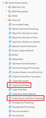

New Arc Hydro Tools

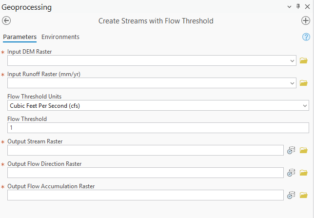

To incorporate more physical and climatic factors into stream delineation, Arc Hydro the free add-in for ArcGIS Pro, now includes two geoprocessing tools:
  1. Create Runoff Raster
  2. Create Streams with Flow Threshold
Together, these tools implement the USGS flow-based method. Instead of defining streams by a set number of upstream cells, this approach uses actual runoff data and flowrate estimates to determine where streams initiate.

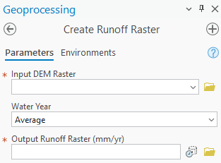

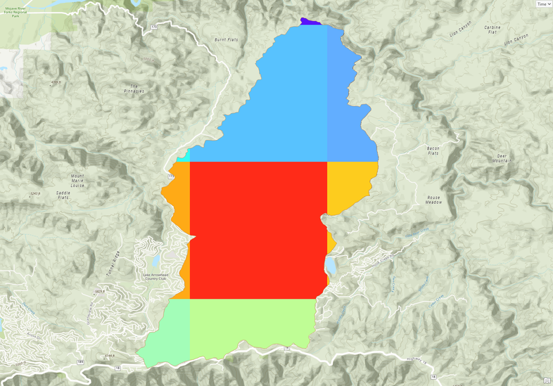

This tool downloads runoff values for a defined area of interest and a selected year, and converts them into a raster with the same extent, cell size, and projection as the input DEM. The runoff data comes from TerraClimate, a dataset of monthly climate and climatic water balance for global terrestrial surfaces from 1950-present. These data provide important inputs for ecological and hydrological studies at global scales that require high spatial resolution and time-varying data. All data have monthly temporal resolution and a ~4-km (1/24th degree) spatial resolution and is updated annually.
This tool produces a binary stream raster by calculating flow direction and flow accumulation from the DEM, weighing those results with the runoff raster to generate pixel values representing flow (volume per time). The Flow Threshold parameter defines the minimum runoff required for a cell to qualify as a stream. The default value is 1 cfs, as recommended by the USGS, but you can adjust it to obtain denser or sparser networks.

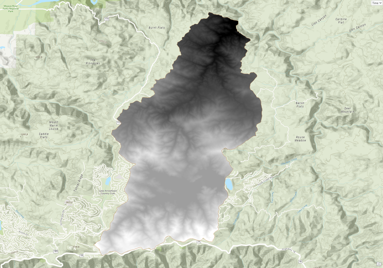

Below is a streamlined example of generating a runoff‑based stream network. The only prerequisite is a DEM. (If you need one, use the Download DEM Arc Hydro tool)

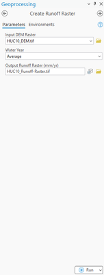

Step 1– Create Runoff Raster
Run Create Runoff Raster with your DEM as InputDEMRaster and select the year of interest.

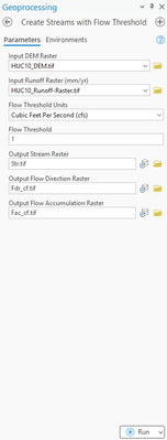

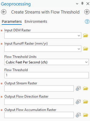

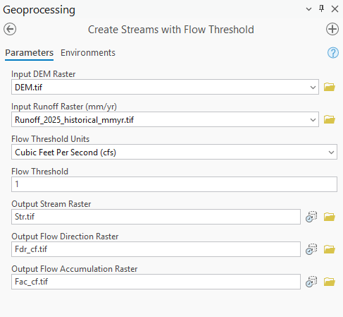

Step 2 – Create Streams with Flow Threshold
Run Create Streams with Flow Threshold, using:
  • InputDEMRaster: the same DEM as in Step 1
  • InputRunoffRaster: the runoff raster from Step 1
  • Flow Threshold: leave at 1 cfs or modify as needed

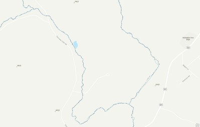

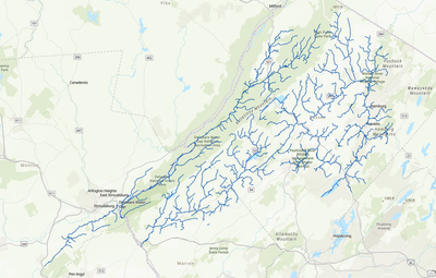

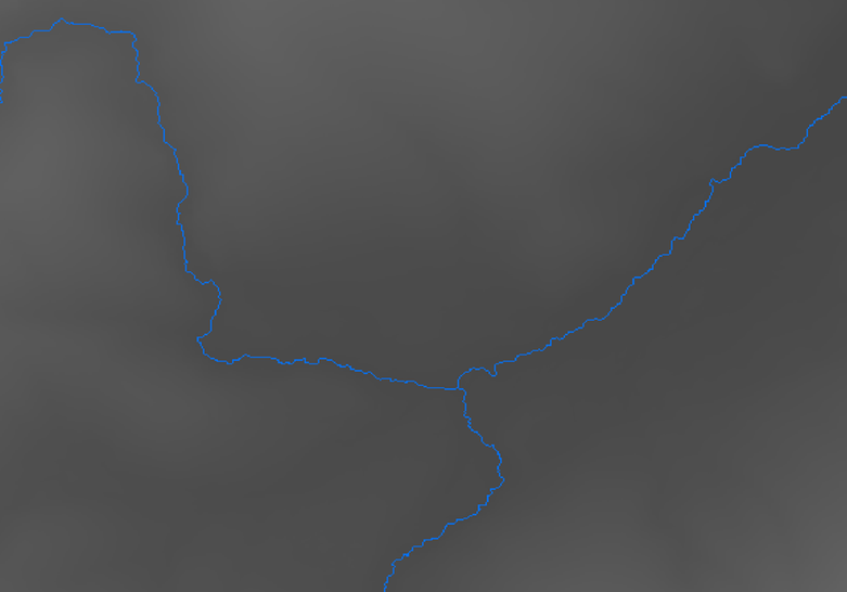

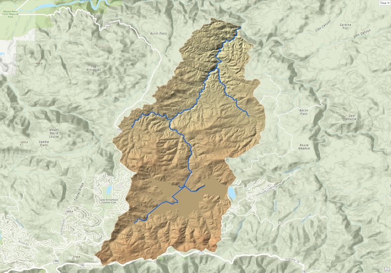

The output stream raster (Str.tif in this case) may appear subtle at small scales; zooming in reveals the derived stream network.

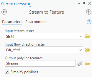

Step 3Convert To Vector (Optional)
Optionally run Stream to Feature to convert the raster network to vector features.
In just three geoprocessing steps, local runoff data was incorporated into terrain data to derive a stream network.
