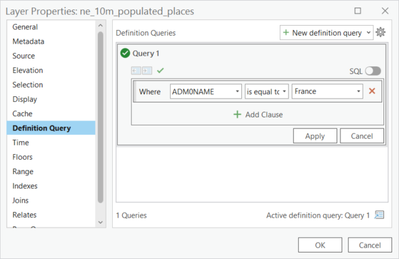

Use a definition query to filter the features from the dataset that will appear or be available in your map. Access the definition query from the layer's properties window.

If you can select the roads you'd like to show in your map with the select tool, then right click on the layer with selected features, ArcGIS Pro can create and apply a definition query for you.
