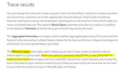

I'm encountering the same issue.  I'm expecting the trace to return a Group Layer object that could then be manipulated in the same way that the old Geometric Network trace results could be processed.  It appears the new trace only returns a string when the result type = 'NETWORK_LAYERS'.
trace_result = arcpy.tn.Trace(network, 'CONNECTED', start_points, lyr_valve, include_barriers='INCLUDE_BARRIERS', validate_consistency='VALIDATE_CONSISTENCY', result_types='NETWORK_LAYERS', out_network_layer='TRACE1')
print(trace_result)
> Trace_Results_Aggregated_Points
It's frustrating because the script works as intended within ArcGIS Pro but doesn't as a stand-alone.  I suspect that the Network Layer result type is only valid within ArcGIS Pro.  The wording in the documentation should be made more clear if this is the case.
At the moment, this isn't a useful option for me as the stand-alone script gets published as a GP service so that it can be called from a web app.
