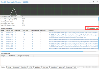

Working with a large NHD sample dataset I am not able to reproduce similar behavior but I'd like to get a better idea of what you are encountering.  Could you share the diagnostic log from the ArcGIS Diagnostic Monitor while performing the action?  Open ArcMon by pressing   Cntrl + Alt +M, enable Diagnostic log (logs to C:\Users\<user>\Documents\ArcGIS\Diagnostics\ArcGISProLog.xml) and attempt to place the starting point.
