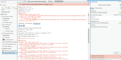

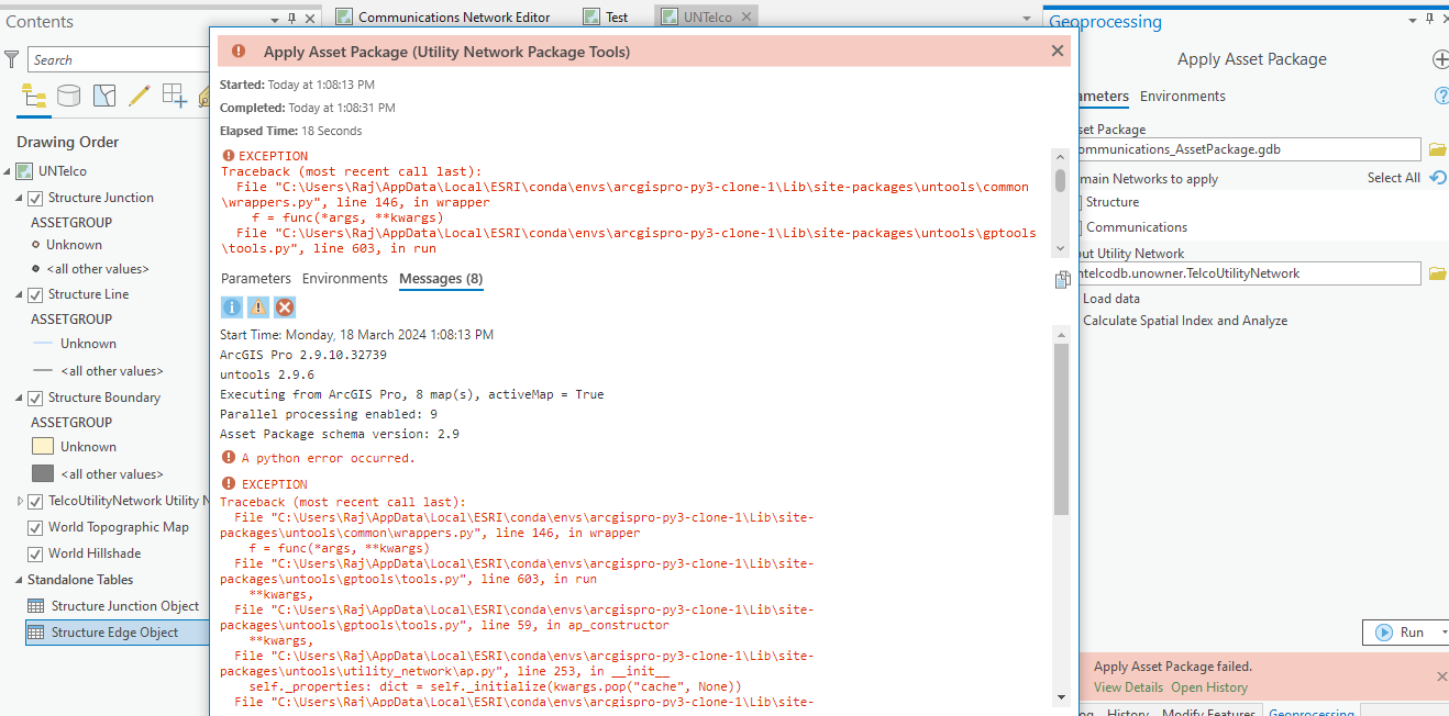

Hello Community Members,
While applying the asset package on CommunicationsUtilityNetworkFoundationV1_1, I am getting the following error. The previous stage of the utility network geoprocessing run was successful.
I am using the ArcGIS enterprise 10.9.1 version ,
Asset package  : CommunicationsUtilityNetworkFoundationV1_1
ArcGIS Pro:  2.9.10
Python package Untools: 2.9.7
Can anyone highlight what might be the issue here?

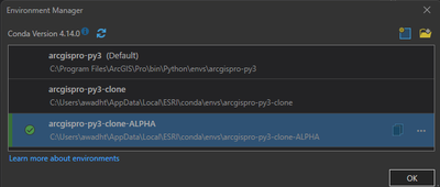

AlbaraA
 @RajAlva00  I have created another Py clone, and restarted ArcGIS (pro 3.1), and I found the Asset Package loaded into the Utility Network, despites all the error I got earlier.
Apparently, rebuilding the Py environment solves it.
Thank you @SpatialNinja
