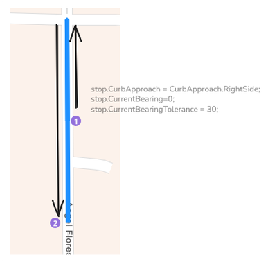

You mention "but when triggering a route solve from a moving vehicle", not sure if it relevant but if you just set 2 points for a route (along with the other properties) what does that produce?  I'm wondering if "from a moving vehicle" matters.
Here is an example of what i set and the result i see (added arrows to show directions), this is using the world routing service also.
