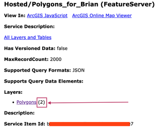

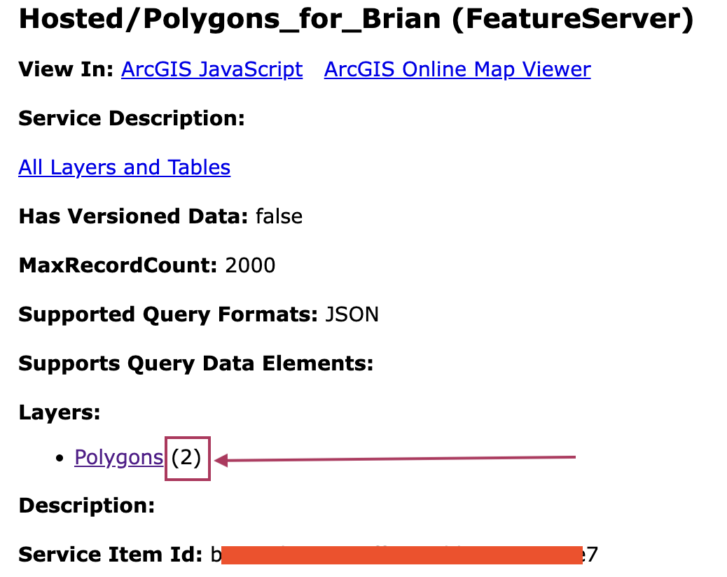

When the user logs in to the enterprise portal and selects the layer he wants to see, that layer is not displaying.
This is happening with all the layers that have an ID different from 0.
for example in this case the ID layer is 2:
Screenshot 2024-11-14 at 4.27.18 PM.pngScreenshot 2024-11-14 at 4.27.18 PM.png

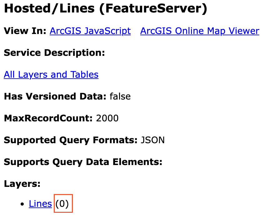

With any layer with an ID equal to 0, it works very well.
Screenshot 2024-11-14 at 4.46.35 PM.pngScreenshot 2024-11-14 at 4.46.35 PM.png

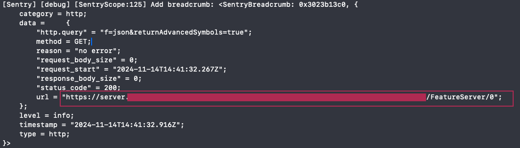

The URL is https://server.xyzxyzxyzxyzxy/FeatureServer, but we could see in the logs this:
Screenshot 2024-11-14 at 9.42.13 AM.pngScreenshot 2024-11-14 at 9.42.13 AM.png
So, it is like the "/0" was added, that's why the layer is not displaying, because the URL should be: https://server.xyzxyzxyzxyzxy/FeatureServer/2
As it is a private layer, the app is using the portal item ID instead of the URL to get the layer: ServiceFeatureTable(item: portalItem), but the layer is not displaying in the map, and the app doesn't have any error from the library.

Hi Maria, thanks for asking. This behavior is expected.
When you create a feature layer like the code shown above
let featureLayer = FeatureLayer(featureTable: ServiceFeatureTable(item: portalItem))
It is using the initializer of ServiceFeatureTableServiceFeatureTable/init(item:) here. It is a "shorthand" initializer that would attempt creating the table from the first layer on the service, with has layerID = 0.
This initializer is there to meet a popular demand which a hosted feature service only has 1 feature layer (layerID = 0) that is being used in a map.
To create a feature layer other than layerID = 0, consider either of these 2 initializers
Both allow you to specify the layerID of a layer on the feature service.
p.s., there should be a load error if the try await featureLayer.load() is called.
