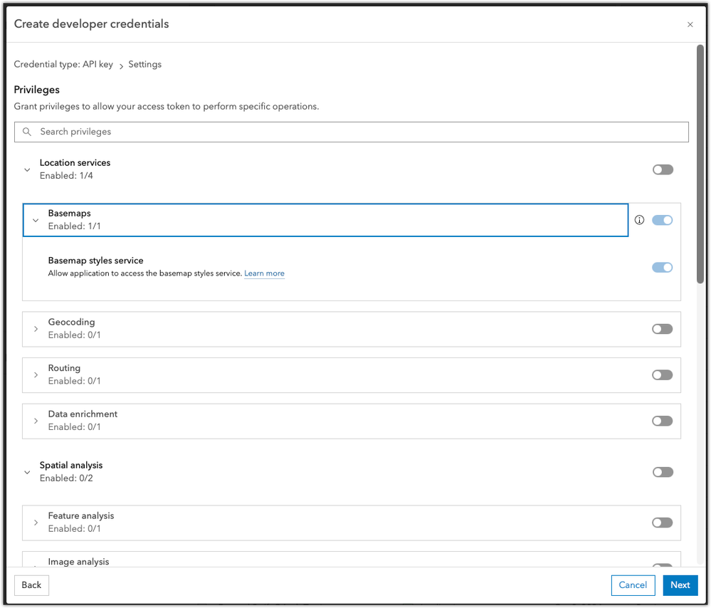

If you're seeing that an API Key is invalid, it means it's not scoped to access the services you're using it for. For basemaps, simply follow the instructions here.
API Keys can be created by either an ArcGIS Online account or an ArcGIS Location Platform account, but the important thing is to ensure that they're scoped for the service you want to access. Follow the instructions above to create an API Key and it should by default include Basemaps styles service access (which is what's needed for the service you're hitting.

Regarding the API key, I did follow the online instructions that you linked to when I originally create the key. I was able to get it to work this morning, I noticed that I had mistakenly added a referrer in the previous key.
