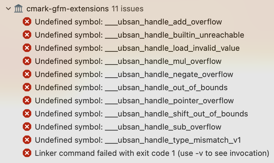

After trying to update the SDK via SPM, I am getting a build error with cmark-gfm. This package seemed to be added as part of the ArcGIS Maps SDK for Swift Toolkit update along with the Swift Markdown package.
I have tried removing and reinstalling app packages and a few other thing but noting seems to work. If I revert back to SDK version 200.5, I do not have any issue, only from 200.6 and up.

Gotcha. From the screenshot you provided, we are guessing along the line of -fsanitize compiler flag, or Undefined Behavior Sanitizer in the Xcode scheme manager.
Can you see if it is checked under the "Runtime Sanitization" section (Scheme > Run > Diagnostics)? If so, we'll need to come up with a test project to mimic your environment. Thanks!
Edit: upon further discussion, it seems to be a problem with a legacy setting (enableUBSanitizer = "YES") in the xcscheme file. After removing it following these instructions, the problem was solved.
