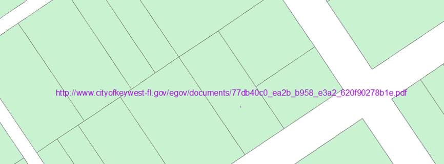

I'm trying to create a layer to overlay a property parcel map.  The purpose of this layer is to identify which parcels have a certain document (Elevation Certificate) on-file, and allow users to access these documents with a click of mouse.
The pdf documents are already web accessible elsewhere in a list format, so URL's already exist for each document.
So far, I've been able to associate the document link with the respective parcels.  However the entire URL link appears on the map, as seen in the image below.  While centered over the correct parcel, the label is so long it covers several parcels, making it difficult to see which parcel is affected and crowd the labels when they get close.
I'd rather have a much smaller standard symbol appear over such lots, which the viewers can click to view the respective document.

Scott,
check this out: ArcGIS Help 10.1
Tim
ScottFraser3
This looks great.
I've come to learn with GIS, the trick is in knowing exactly what to ask about.
Picking the correct term or phrase will get you headed in the right direction.  Of all the help items I searched for, "hyperlinks" wasn't among them.  To quote Homer Simpson... "Dunhhh!"
