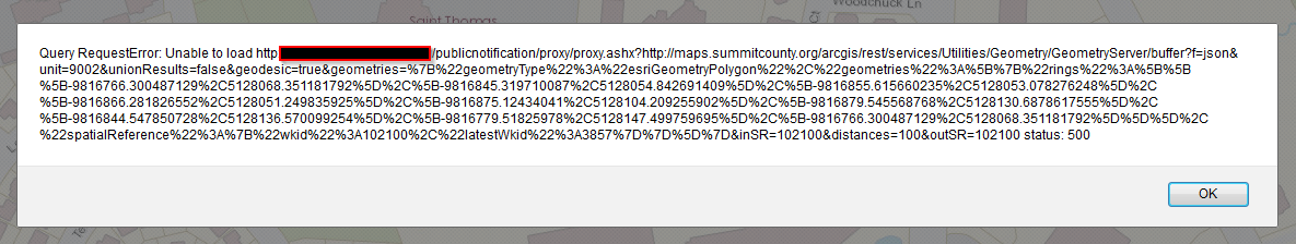

I am working on implementing the Public Notification app in our organization.  I am able to publish all of the services and make the changes to the config files.  It works on the ArcGIS Server machine using localhost and on any computer behind our firewall using the IP of the ArcGIS Server.  But when I put it out on our web server I get an error :
I might mention that I had to switch the app pool from ASP .NET v4.0 as the instructions suggest to the ArcGISWebAdaptorAppPool.  But I don't think that is the problem I am facing, this seems to have something to do with the geometry service.

I did make that change and the services all draw, I am currently testing it with the sample data.  I am able to zoom in zoom out and pan around the map.  I can even select the parcel, it's just when it attempts to buffer the selected parcel that it throws the error.  So I am thinking the geometry service works, I am able to select the parcel, but something is going wrong with the buffer call to the geometry service.

Check to make sure your proxy can access your geometry service.  I added your server to my proxy and was able to successfully reach it by specify the following URL:
