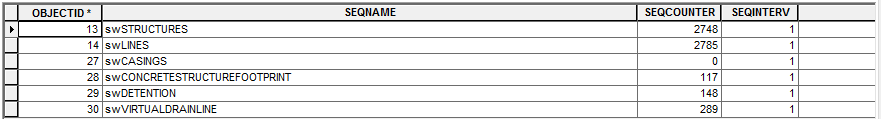

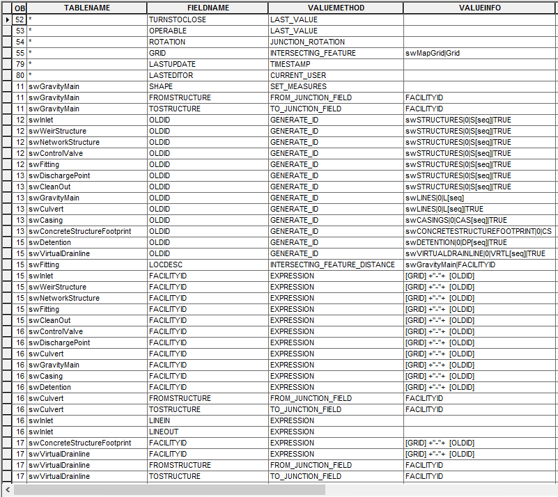

I'm jumping in a bit late here, but couldn't you use the 'Generate_ID' method to get the same results?  That is what we use to generate our ID's for all of our features.
If you want to keep your original ID's, just do a sort and find the highest number, then create a record in the GenerateID table called MasterStreetID (or whatever) and put the ID that you found above in the 'SEQCOUNTER' and interval it by 1. Then create a record in the DynamicValue table for your masterstreets_ID and use the generate_ID method.  Works well for us.  Below is an example from our set up.  We have a field that contains our old ID's and I did exactly what I mentioned above.  Then I use the generate_ID method to get the next number.  We also use our map Grid (not necessarily needed for streets) in our ID so, using an expression I combine the grid w/the oldid column (which is autonumbered now) and we get our unique ID.

JeffreyWarren
I agree. I believe the generateid table is best for when you have multiple feature classes that you want to share an ID sequence.  We are in the scenario where we have fittings, manholes, inlets, etc. that our departments want to just call S-*123, because they are all "structures", even though they are each in their own feature class.  So, autonumber would not work for us.  And granted there really is no maintenance per se, just the time to create the 1 record in the generateid table and add the record in the dynamic value table.  Just depends which flavor you prefer.  Good luck.
