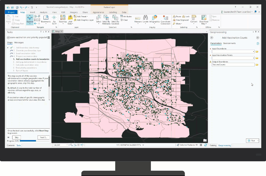

  1. Open the Prepare vaccination and priority population data task and complete steps 1-3 as directed.
  2. Complete step 4, Prepare vaccination data, then select the Map tab on the ribbon.
  3. Click Select by Attributes in the Selection section.
  4. Confirm that VaccinationPoints are selected as the Input Rows.
  5. Click New Expression and use the Query Builder to create an expression that will select the population you are interested in.selectbyattribute.gif
  6. Once the records are selected, complete step 5, Add vaccination counts to boundaries
  7. In step 6, Add population totals to boundaries, adjust the Variables to reflect the population you are interested in. Leave the 2020 Population Age 18+, as it is used for other parts of the analysis.
  8. In step 7, Calculate vaccination rate, adjust the Total Population input to reflect the population you are interested in. This should be the variable you enriched in the last step. Enter all other inputs as described in the task and run the tool. The resulting layer will reflect vaccination rates for the population you are interested in.

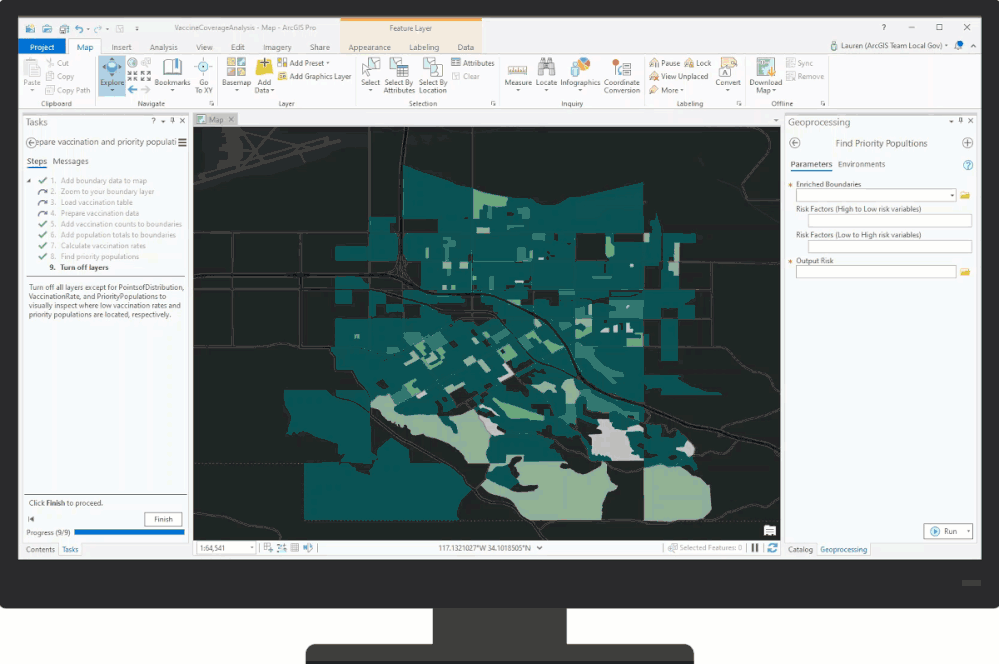

    9. In step 8, Find priority populations, select the population you are interested in as a Risk Factor. Enter all other inputs as described in the task and run the tool. The resulting layer will reflect the locations of the population you are interested in.

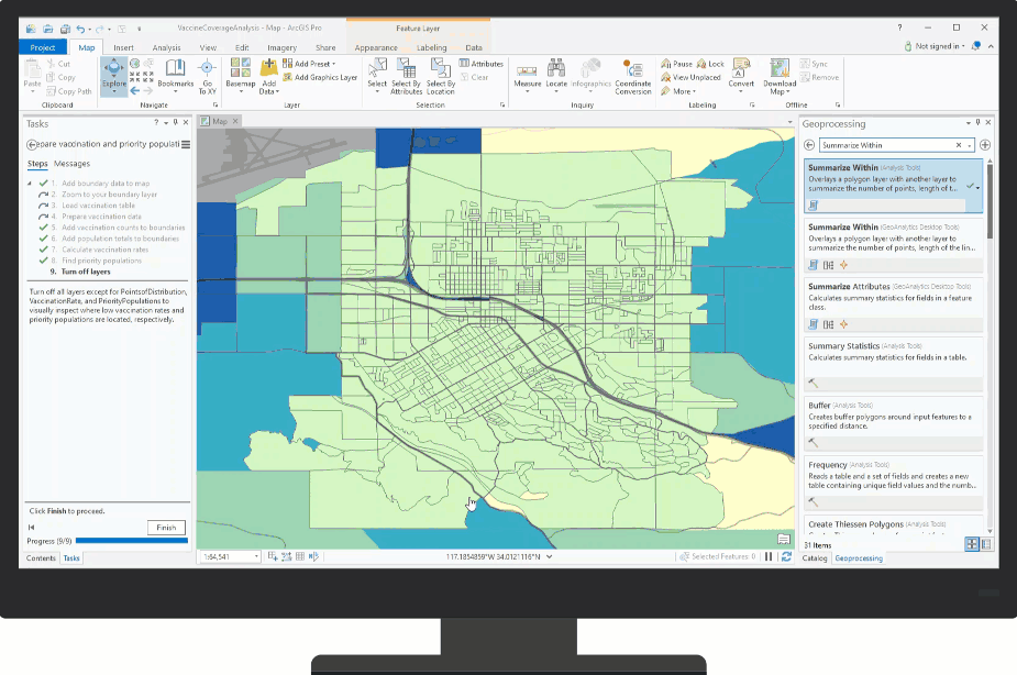

  5. Click Add Data and search for SVI in the Living Atlas. Add the Overall SVI to the map. The SVI is available in counties and census tracts. Pick the one that is most appropriate for your analysis. If you are doing an analysis on counties, pick the Overall SVI – Counties. If you are doing an analysis on a smaller geography, pick the Overall SVI – Tracts layer.addsvi.gif
  6. Search for and open the Summarize Within tool. Enter VaccinationRate as the Input Polygons. Enter the SVI layer the Input Summary Features. In the Output Feature Class, enter “PriorityPopulations”. In Summary Fields, click the dropdown and select “Overall Percentile Ranking” as the Field and select Mean as statistic. Click Run.summarizewithin.gif
    Note: the Mean statistic in the Summarize Within tool is calculated using a ratio policy, where the proportion of area that intersects with the inputs is used to weight each value. The equation used to calculate the mean can be found here
  7. Right-click on the PriorityPopulations layer and select Symbology. In the symbology pane, select Graduated Colors as the Primary symbology. Set the field to MEAN RPL_THEMES and Method to Quantile. Specify 5 Classes and select the Blues 5 Classes Color Scheme. The resulting layer will show areas of high social vulnerability in dark blue with areas of low social vulnerability in light blue.symbology.gif

  10. In step 1, Find underserved populations, disregard the task instructions and enter the following parameters in the Find Underserved Areas tool. For Input Features, select PriorityPopulations. For Risk Factors (High to Low), click the drop down and select “MEAN RPL_THEMES”. For Risk Factors (Low to High), click the drop down and select “VaccinationRate.” Enter “UnderservedPopulations” for Output Risk. The resulting layer will display underserved populations using the SVI.underservedpopulations.gif
