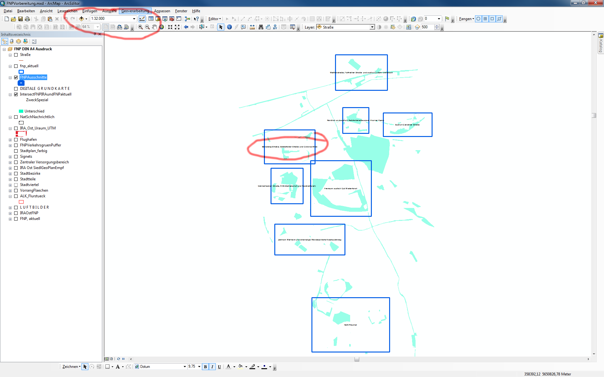

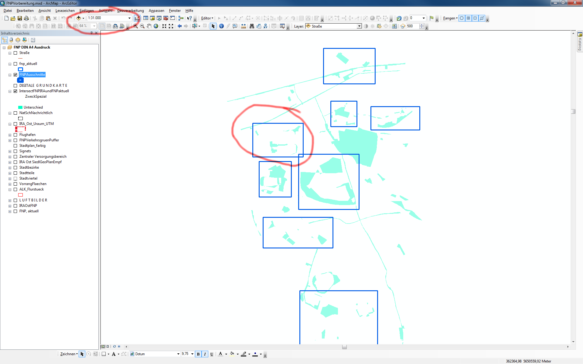

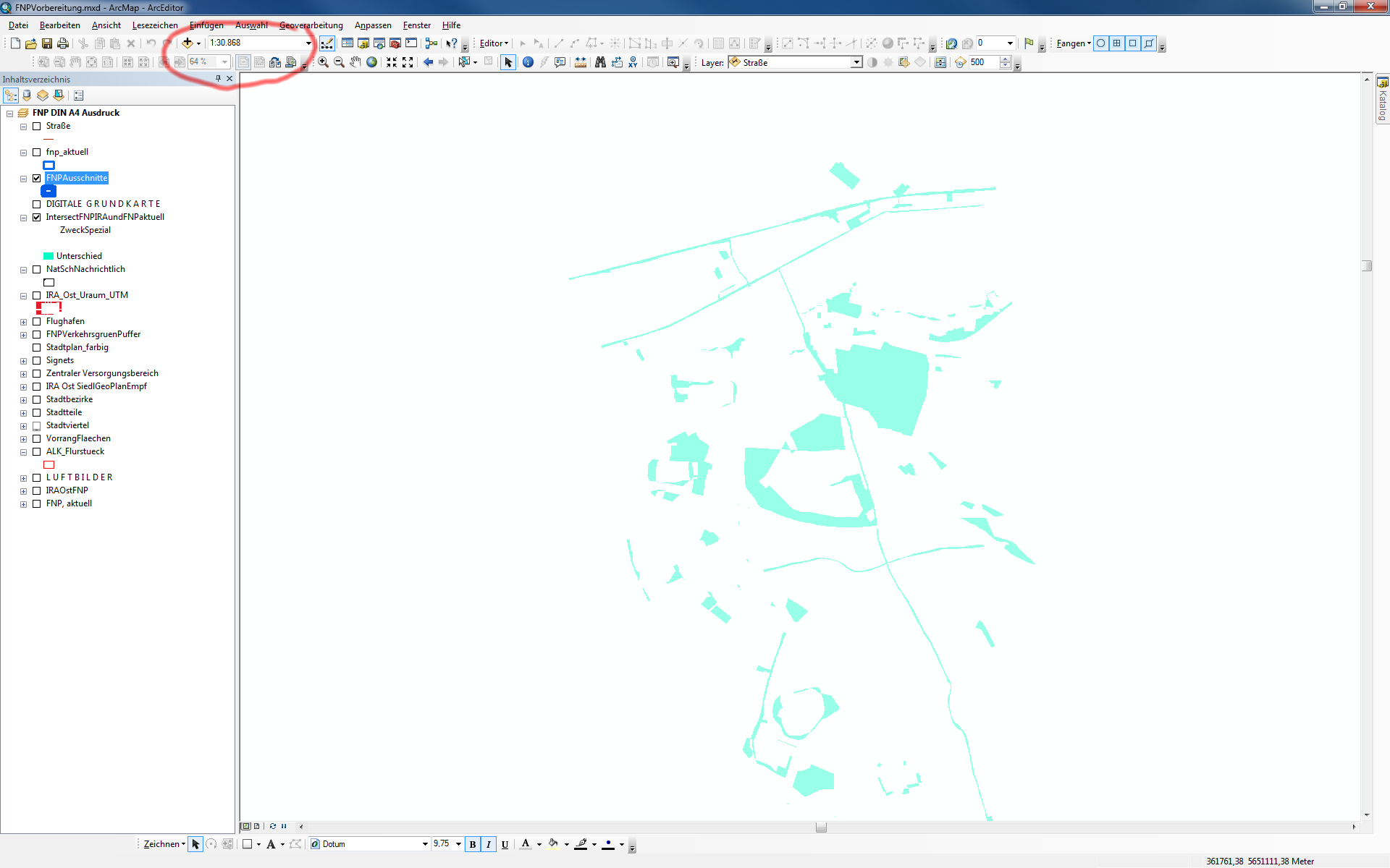

Dear all,
I've got a problem in displaying a feature containing some simple rectangles, when I scale it down from e.g. 1:40.000 to smaller scales. At first, the labeling disappears, then - at 1:30.000 all rectangles.
And: I can't select None of the rectangles.
Any helpful explanation for this phenomenon? All other features behave "normally"
Thanks for any hint
Wolfgang

Hi Todd,
thanks a lot for your fast answer. I checked out all these possibilities of taking influence on scale and display, nothing worked. The rectangles disappear at 1 : 30.687; it's curious. I can select one single  data in the table and the display zooms in, but the rectangle stays unvisible. And I can't select by cursor.
Wolfgang
