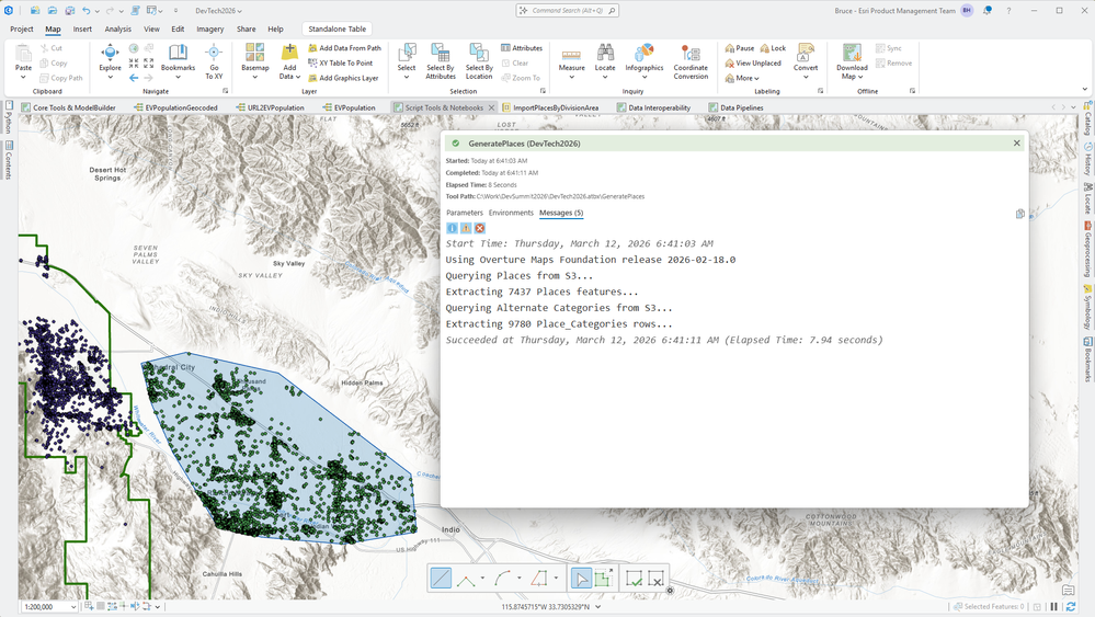

I like to go demo-heavy at event presentations, it lets me generate content I can share.  Here's a snapshot of some of the live action - ETL via script tool of Overture Maps Foundation Places theme points of interest brought into ArcGIS Pro's memory workspace as a base point layer (the green points) and related (with 1:M cardinality) place categories in a table view as my output information product, 64 million points queried from GeoParquet files in AWS S3 with map interaction to define an area of interest.
ETL with map inputETL with map inputETL with map input

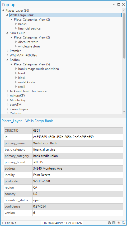

Here I identify some of the points, see the alternate categories accessed by map relate.
Place CategoriesPlace CategoriesPlace Categories

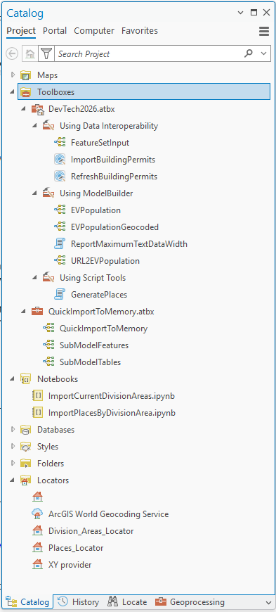

Here is the relevant content, which I'll talk to in the order shown in the Catalog pane.
Relevant ContentRelevant ContentRelevant Content
The toolset Using Data Interoperability contains two Spatial ETL tools that embody a 2-stage process for maintaining a hosted feature service information product in ArcGIS Online.  First create geodatabase objects with the desired data model, relationships and schema, add them to a map and define symbology, popup behavior and metadata, publish the layer as a hosted feature service, then secondly update this information product on demand.

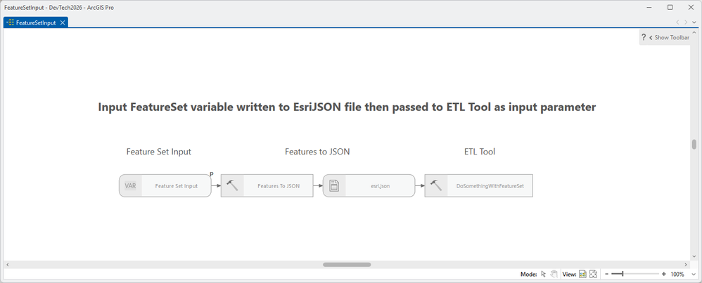

Not demonstrated on the day but something I know is in demand is a ModelBuilder model FeatureSetInput namely how to build map interaction into an ArcGIS Data Interoperability  Spatial ETL tool.  Here it is:
FeatureSetInput modelFeatureSetInput modelFeatureSetInput model
The model isn't shown as validated (it validates at run time) but the processing works like this:  A model variable of type FeatureSet is an input parameter, filtered to be polygon.  This means at run time you can pick a polygon layer or create new area of interest features on your map.  The core tool Features to JSON is then used to write an EsriJSON file to the project scratch folder as intermediate data.  This file's path is then an input parameter expected by the Spatial ETL tool DoSomethingWithEsriJSON which takes it from there to do whatever you want.  This behavior is frequently wanted for web tools.

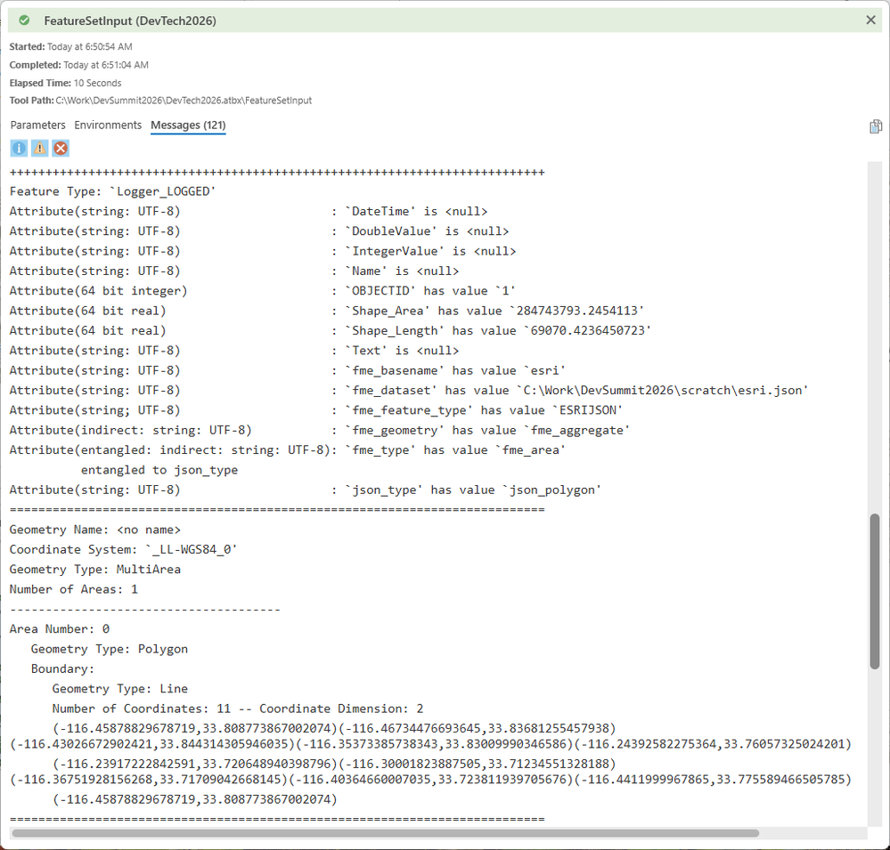

Here is a view of the tool log as it runs, showing the input map polygon has been read into the workspace.
FeatureSetInput runtime detailsFeatureSetInput runtime detailsFeatureSetInput runtime details

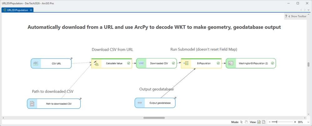

Next up was URL2EVPopulation, which showed how to give ModelBuilder a boost with a little Python to retrieve the source CSV data from a URL where it lives in an open data catalog, this was a popular feature.
URL2EVPopulationURL2EVPopulationURL2EVPopulation

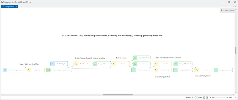

The submodel EVPopulation showed an alternate approach to geometry creation, namely ArcPy's ability to convert OGC Well Known Text into Esri geometry.  The core tool Convert Coordinate Geometry doesn't support WKT.
EVPopulationEVPopulationEVPopulation
