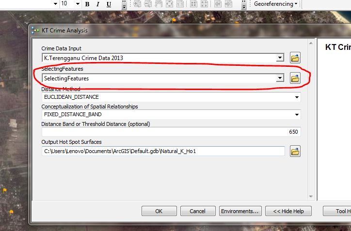

Do someone know on how to make this "selecting features"  appear at the model tool created from model builder?1.JPG

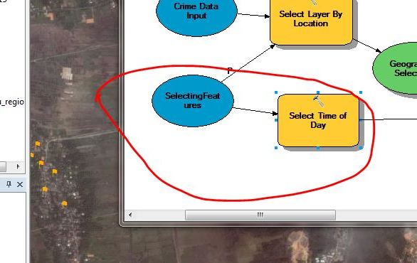

I just drag that selecting features into my model builder,
But, when i opened my model created from model builder, it just appear like this

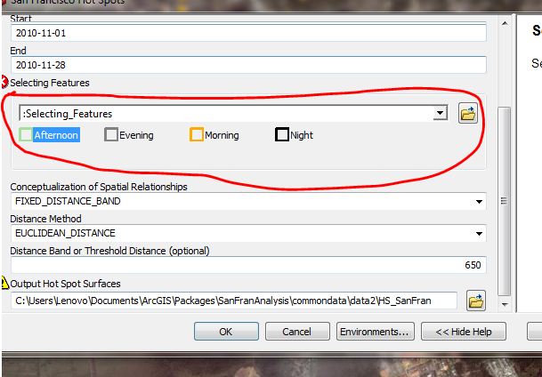

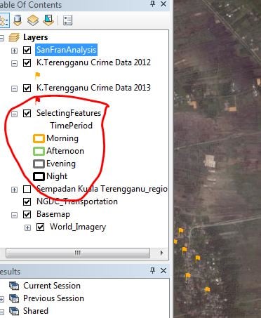

Can someone tell me on how to make the "selectionfeatures" appear at the model, just like this below screenshoot; therefore, i can choose any desired location along with the parameters needed (afternoon,evening, morning or night) in order to create hotspot analysis.4.JPG

if you need it as a parameter, right-click on it and specify it as a model parameter, which put a P above the oval and put an entry line in the dialog allowing the user to change its value
