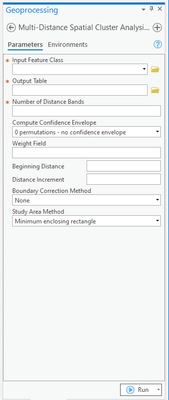

RodrigoSolinis-Casparius
I have the same question, the graph was created automatically in other versions (it did in ArcMap)? ArcGIS Pro 2.9 does NOT have such optional parameter (see image). Any ideas?
LaurenGriffin
I agree it's a shame that the chart isn't generated automatically. Fortunately it's quite easy to create the chart from the output table.
Right-click the output table and choose to create a line chart.
I hope this helps!
