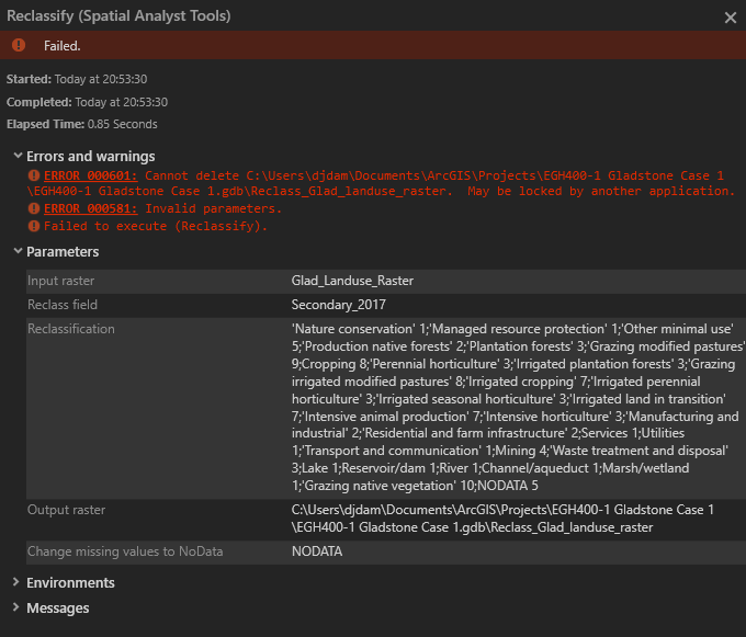

Hi,
I am trying to reclassify a land use classification raster.
There are approx 30 unique land classifications and I am trying to reclassify them for inclusion in a suitability assessment and am recieving Error 000581 Invalid Parameters.
Any help is appreciated!

@DamonJohnson , remove the special characters from your strings in the classification (backspaces, even swap spaces for underscores if that doesn't work).
If it's not the special characters, try exporting to Tiff and reclassifying that. FGDB rasters sometimes don't like certain geoprocesses

Worked! Thanks for the quick response
