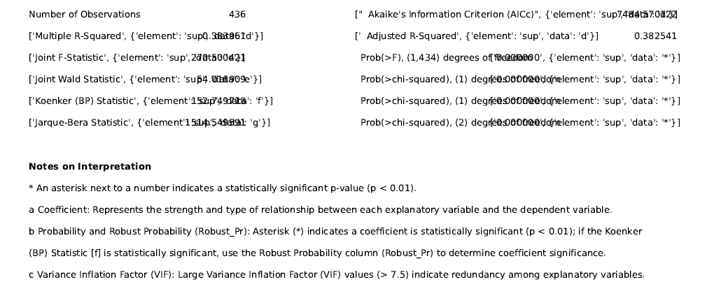

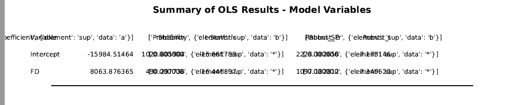

I'm using ArcGIS Pro 2.9.0
The summary report of OLS regression produces a pdf in which all the coefficients text are overlapped or garbled.
All the texts except coefficients are fine.
Please help how to fix this or suggest a workaround.
I'll attach the picture for reference, Thank you.

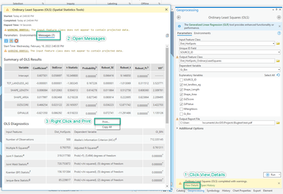

Thank you for reporting this issue. In ArcGIS Pro 2.9, we updated the support for improved Geoprocessing messages which caused this issue of text wrapping in the PDF. We are currently working on fixing the issue.
In the meantime, you can leverage these improved messages to read and export the OLS summary and diagnostics to a PDF report.
Please follow the steps in the below screenshot.
Alt Text:
1) Open Geoprocessing messages
2) Click on Messages Tab
3) Right Click and Print...
4) Print as pdf
Hope this helps.
Thanks!
