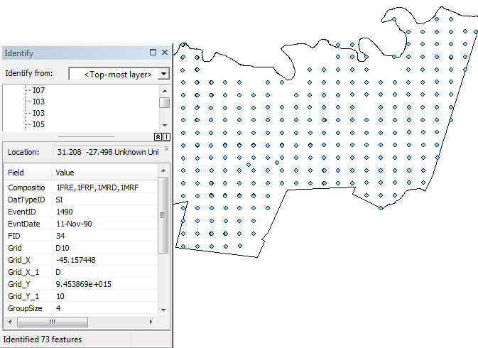

No, the records are captured as points. The reserve was divided into a reference grid of 1 * 1km cells that were used to assign a location to the sightings (so one location was given to all the sightings within that grid).

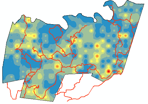

Included here is the point data as well as the results of an identify of one of the points (you can see that this one point has 73 records associated with it). Below that is a quick density map using all the points with the roads overlayed on it.  There roads to the south and west are the most frequently used roads whilst the roads to the east are used fairly infrequently. There seems to be a correlation between them and animal densities...... There is also some terrain bias but at first glance it is not as influential.

Are the point the you are showing on the lower left corner of the grid cell, or did you correct them to be moved to the middle of the cell? I also see some points that don't seem to follow that pattern and some points that almost overlap at some locations. What is happening there?
If it is animal distribution that you are after, it may be difficult to determine this based on sightings. If in area there haven't been observed this does not mean that there aren't any animals. What is really the effect of the roads that are more used on your animal sightings? As Ben Leslie‌ states, you may need additional data to be able to say something about the animal density if that is what you are after.

I have not finished my data cleaning yet hence the discrepancies.  Some of the later data was captured using GPS's which resulted in some points not following the grid pattern. Also some observers used more/less decimals in the grid coordinates when recording the sightings hence the slight shift in some of the observations 😞

That is indeed a confusing distribution, because in some areas, yellow/red is clustered (Y) near the roads and in other areas the opposite is true (N).
It even gets more confusing as you head south
