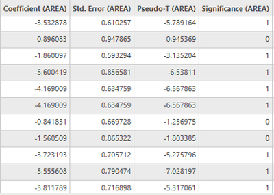

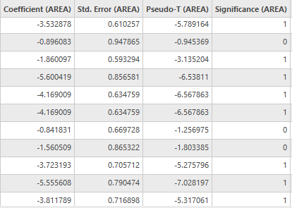

I am running GWR in my research and I don't know what do mean column 'Significance' and 'Pseudo-T' in attribute table after running GWR. These are new column in layer's attribute table after running GWR. What does it mean this 0 and 1? Can anyone help me.

Hi Mirela,
The "Significance" column in the attribute table indicates whether the parameter estimate for each variable is statistically significant or not. A value of 1 indicates that the parameter estimate is significant at the specified level (usually 95% confidence interval) and a value of 0 indicates that the parameter estimate is not significant.
The "Pseudo-T" column in the attribute table represents the t-statistic for each parameter estimate in GWR. The t-statistic measures how many standard errors the estimate is away from zero. The larger the absolute value of the t-statistic, the more significant the estimate. The significance level of the estimate can be determined from the associated p-value.

Hi Mirela,

Thank you very much. Yes, it helps.

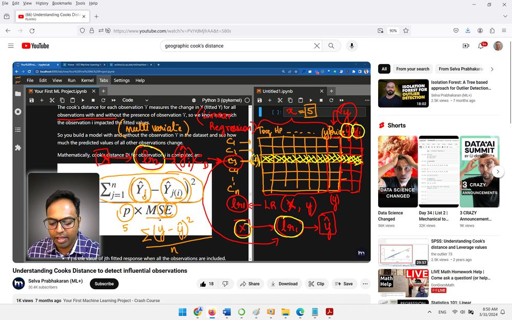

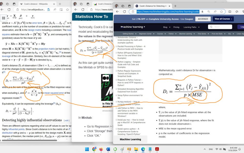

I got confused regarding the equation used to calculate the Cook’s D.
https://www.machinelearningplus.com/machine-learning/cooks-distance/
https://www.statisticshowto.com/cooks-distance/
https://www.youtube.com/watch?v=PVJYdMjfrAA&t=580s
