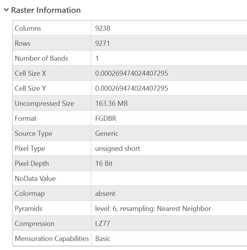

Below you see the raster information of the input data.
Thanks for your support!

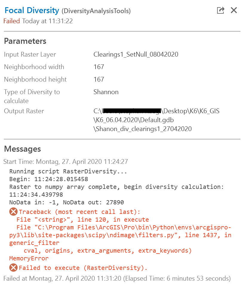

Now the following has happened: with a small processing extent, the tool has worked. But with the whole grid I got the message > memory error (see picture below). Do you know what this could be? (I still have over 100GB on my hard disk, but maybe it's the cash memory or the RAM?)
Stephen

memory error is referring to ram not hard disk space

For some reason I missed your question.  I suspect the problem has to do with the size of your input raster and the size of the neighborhood.  The combination makes for a really large footprint in memory due to the way the numpy ndimage.generic_filter works and the fact that I am applying an in memory loop that, for practical purposes, is about Image rows X Image columns X neighborhood width X neighborhood height X size in bytes of your pixel values.  In your case this is 9238 x 9271 x 167 x 167 x 2 = 4.4G... I think.   This is a fair amount of RAM and depending on OS version and available memory could be the problem.  Try running the tool with a neighborhood of 5x5 as a test.  If this works  you can start scaling up the neighborhood until it breaks.  The other solution would be to reduce the resolution of the source image.  These ideas only apply if the issue is caused by running out of memory.  I hope this helps.
