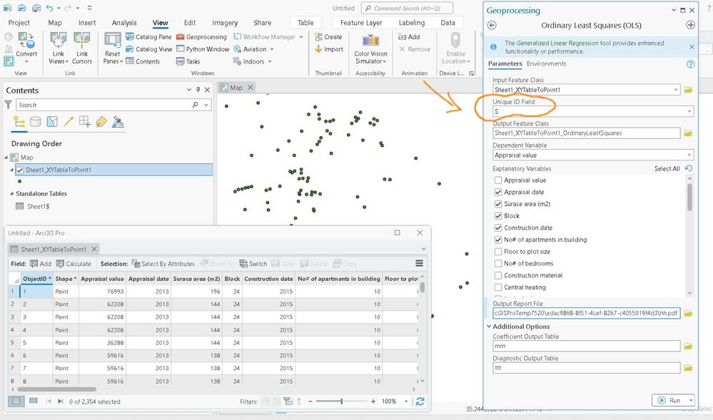

I couldn’t figure out the function of the “unique ID field” while working with OLS
Jamal Numan

Hi @JamalNUMAN,
Requiring a Unique ID field is an older design pattern that is not used in more recent tools.  In fact, the Generalized Linear Regression tool (with Gaussian model type) does the same thing as the OLS tool, and it does not require a Unique ID field.
The idea behind the Unique ID field is that it gets copied to the output features, so you can join the output results back to the input (or vice versa).  For example, if you have a selection, the output features will not have the same Object IDs as the input, so some other field needs to be used to match input/output.
In more recent tools, each Object ID from the input is copied to a "Source ID" field of the output features.  This serves the same purpose (being able to match output to input) but does not require that you provide a field.

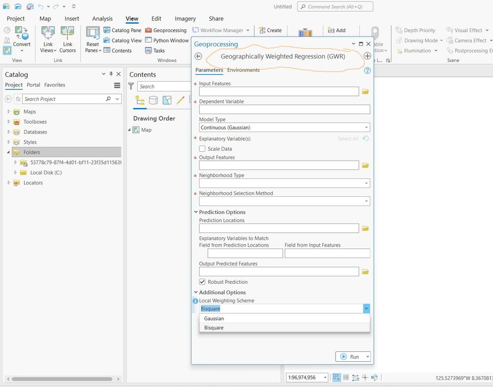

Then how is it possible that this field is not required when working with GWR?
Jamal Numan
EricKrause
GWR is a relatively recent tool (there is also an older version that is now deprecated), so it creates a Source ID field on the output features rather than require and input Unique ID field.
