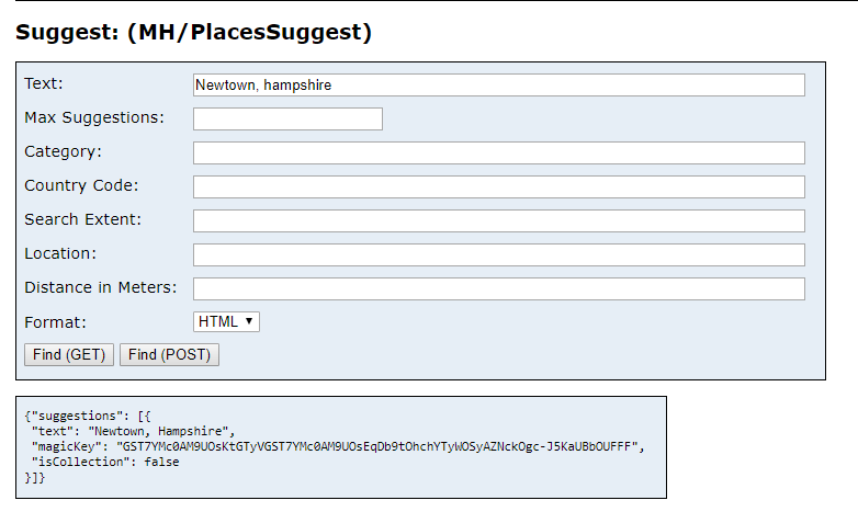

I enabled suggestions on my simple locator which consists of place names in "Name, County" format. As it happens, there are several places within the same county having identical name (e.g. Newtown, Hampshire).
I published this locator as a geocode service and enabled suggest capabilities. I tested Suggest rest API call and only got one result back for any place name which I know exists within the same county more than once.

thanks for replying. I used the General - City State Country style. I tried both options where County = State, County = Country with same results:
Suggest request returns one result:
Compare to Find request which returns all 10 places:

If Name, County are in a single field in the reference data, try creating a locator based on US Address—City State locator style and map the field to  Named Place. Then publish the locator. What are the results? Another locator style to consider is the General - Gazetteer to build the locator. Commonly used locator styles—ArcGIS Pro | ArcGIS Desktop
